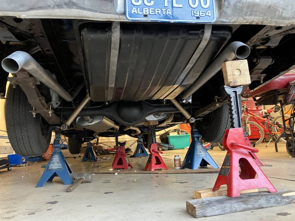

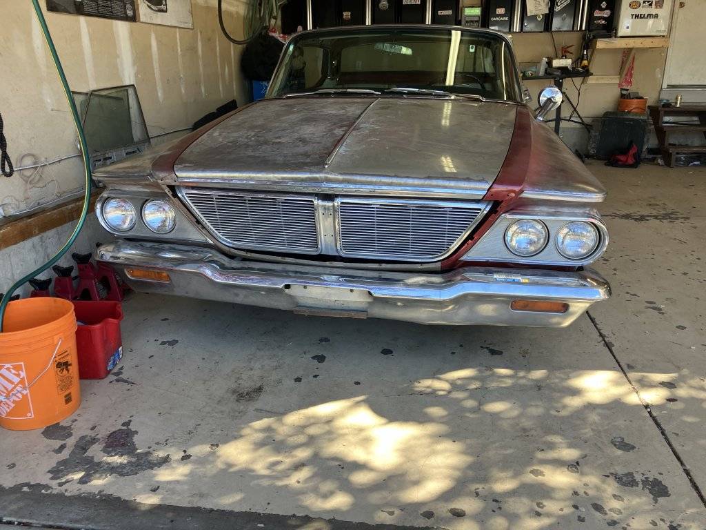

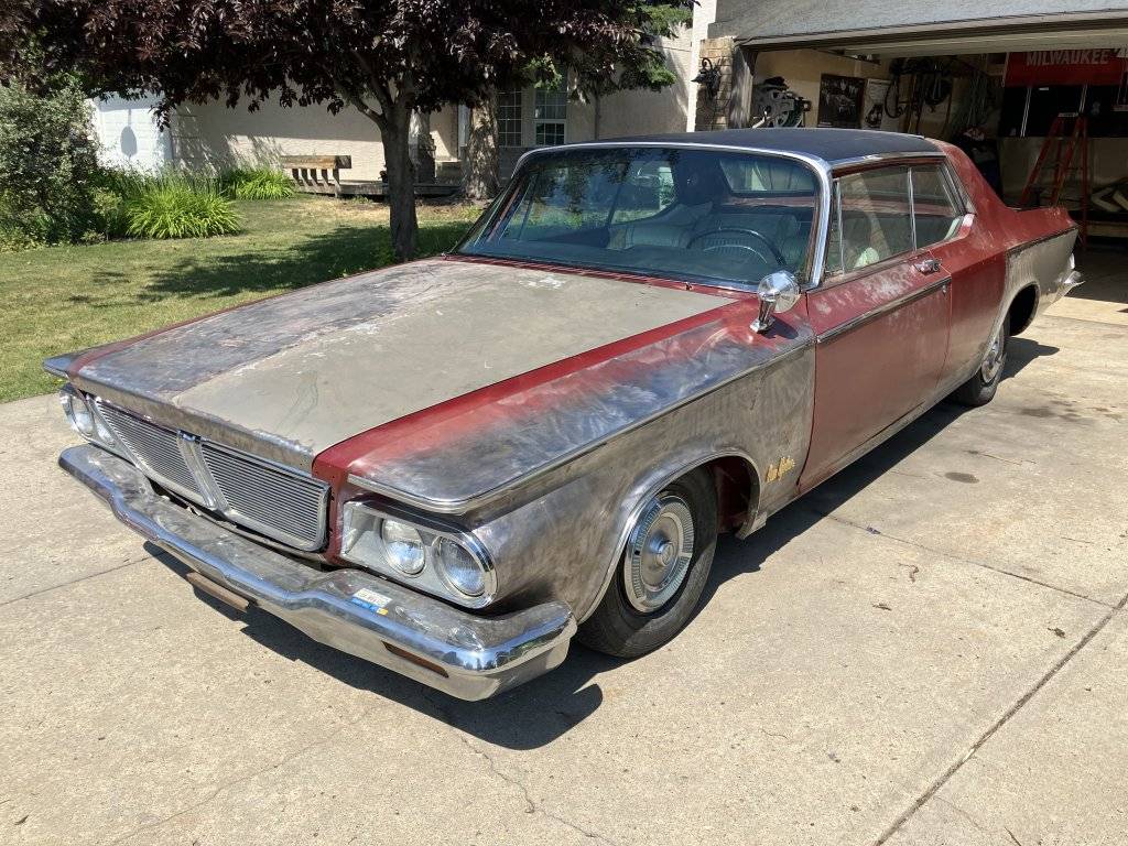

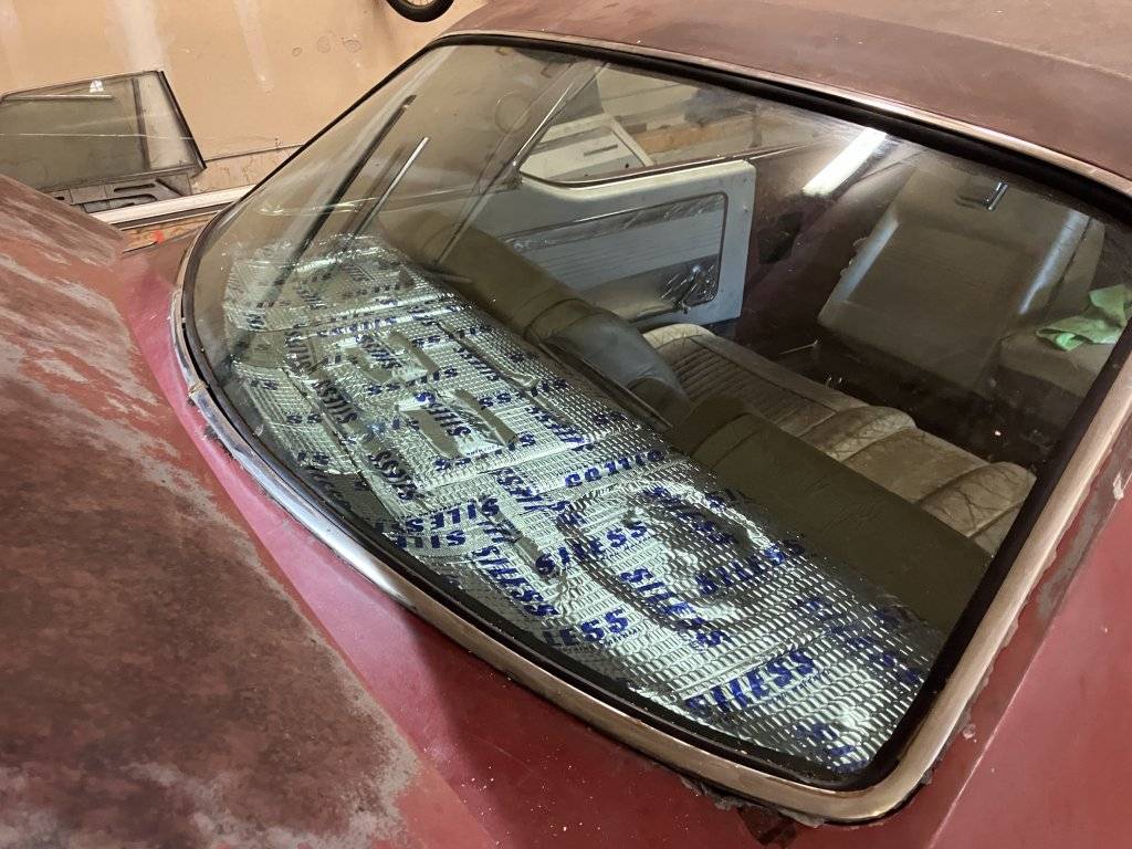

Good summer for the car. We left Thelma (77 Newport) in storage and focussed on the 64. Glass went in and installed the dual exhaust. It’s becoming very car-like.
Looking good, it's going to be awesome when painted. Thanks for the update.

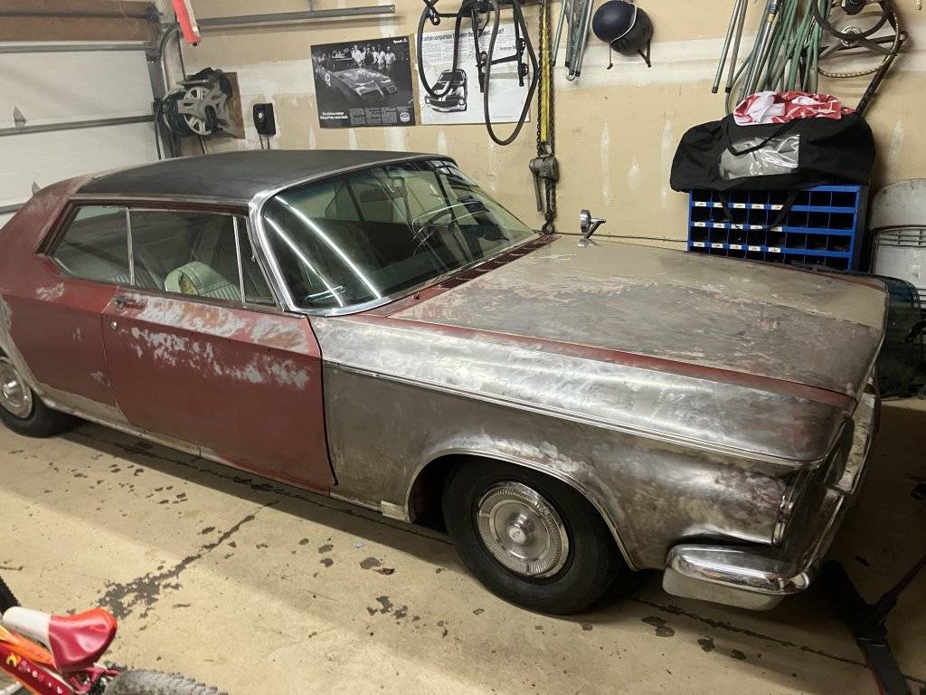

Picked up a beautiful set of 4 Goodyear H78-14 Bias-Plys for the 64 a couple weekends ago - even the tire shop guys liked them and they usually give me a pretty good side-eye when I bring used tires in there. She looks proper now - in the words of Bob Seager - "Way up firm and high".
Crappy photo but it's too cold right now to dare open the garage door and get her out on the driveway.
