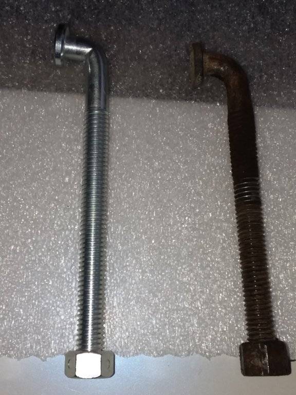

J-Bolts. Extremely hard to find the right ones for an old C-Body. I thought they were ALL the same with a 9/16 nut, but I suppose some later cars B-Body and E-Body were different lengths. I found older C-Body J-Bolts from Vans Auto. Part number (J-BOLT). Think they were $9.00 each. Good service, had them in 3 days. They are about 6 threads longer than the OEM, but seem perfect.
https://vansauto.com/product/j-bolt-nut-single-strap-tank/

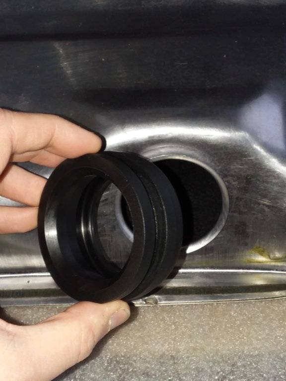

The filler neck and seal. My filler neck was pretty bad, and I still have to clean it up. I haven’t found any body who is remanufacturing these, so good luck. The filler neck tank seal. Remember this CR20B Tank is NOT intended for a 1965 C Body Polara/Monaco/880, but it does fit. So, remembering that you have to order the tank seal for the CR20B tank which again is suppose to be for a 67-68 Newport. Found that tank seal on Filler Neck Supply Company Online. It fits the CR20B Tank, the old Monaco seal I never tried getting it out of the old tank. Think it would have just crumbled, it was dry rotted from age. Again, you don’t want leaks. Think it was $12.95.
1966-1976 Mopar C Body Fuel Tank Grommet Filler Neck Seal
