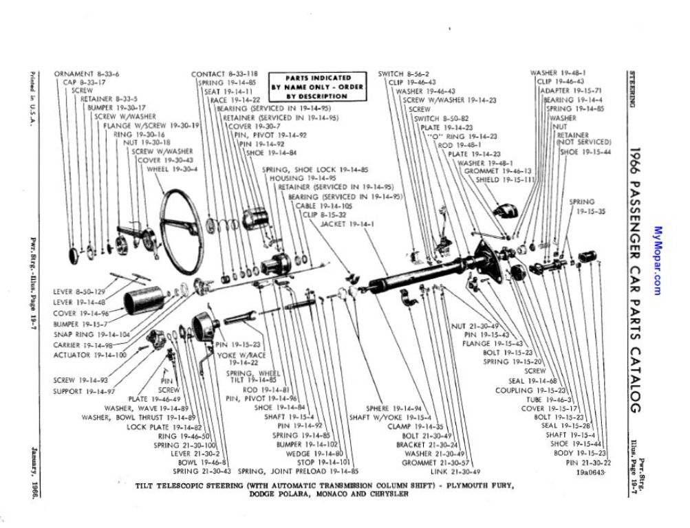

Hi all I’m having an issue with the tilt part of the column. When it’s all the way up you can grab it and pull it down with out using the lever. Sounds like it’s stripping the pin or the mechanism. My question is how do you access this area? And is this repairable. Thanks

It should NOT move as far as I know. There is a spring loaded assembly that you release by pulling the tilt lever. When you position the wheel where you want it (tilt-wise), releasing the lever allows that assembly to catches on a series of cuts in a plate. The parts I believe are called - tilt spring (there are 2), housing (this has the cut plates as part of it), and 4 shoes for upper and lower tilt positions.
Disassembly required - wheel, guts, cover, more guts.
