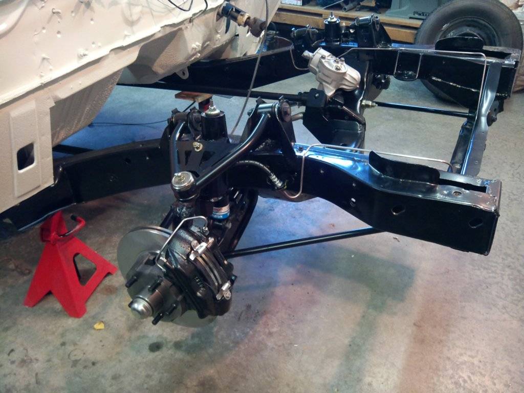

This is my 66 Fury with all new Firm Feel components. Went with heavier torsion bars, 1 1/8 as I recall. Manual steering box. Did the rear leafs from FF as well. It rides and handles wonderful.
I have to agree that the original setup is my favorite. I phoned firmfeel yesterday and explained my screw up with torsion bar length. Matt told me he should has caught it. i told him **** happens. anyhow i have a pair of 44 inch 1.06 diameter bars headed this way. i went whole hog and got their steering box, complete front suspension upgrade and rearleafs. i see there are a few other suppliers of mopar suspension kits. i must say the guys at Firm Feel are the true cream of the crop.

Firm Feel were very helpful to me and the components are first rate. Make sure to get polyurethane bushings as well. Lower the pressure from your ps pump? How and why?
You can change the boost valve on the pressure line on the pump. By lowering the pressure it takes away the soft/touchy steering C bodies are plagued with. Thus giving you more roadfeel and some may argue better handling characteristics.
I am sure I saw the lowering of the steering pump pressure discussed here somewere. the best explaination of "how" is a article that Richard Ehrinburg did in mopar action. do a google search. type in "pump it down, mopar action" and hit search. its a very simple procedure. the article also explains "why"
does lowering the PS pressure reduce the end play travel in the steering shaft?
looks to me that firm feel address's the endplay issue with their rebuilt steering box. I have been led to believe that a rebuilt box and lower pressure do wonderfull things for C body boats. heavier torsion bars, increased caster and beefy sway bars help as well. I am really looking forward to road testing the FF setup. hopefully later this fall.

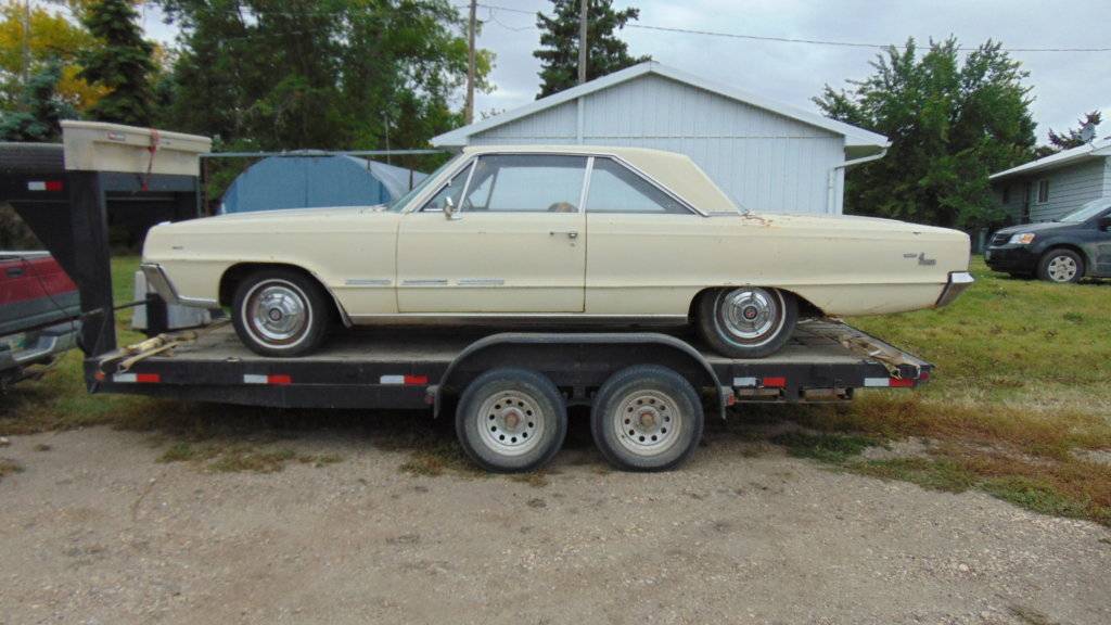

I have a 66 dodge addiction. hauled in the latest today, a Canadian Monaco,. its 100% complete and unmolested. 318 poly that wont turn over. bit of rust in the usual spots. buckets and floor shift. this one makes 3 so far this year. and just short of 4 months left.

its bizarre, these cars are finding me. I put a good battery in, cleaned the battery clamps and tried it. just clicked. the 3rd time I seen the fan move slightly. somebody has been trying to get it running. 7 spark plugs are on the intake manifold. the guy I got it from said the original owner told him the engine had been overhauled, it has fresh red paint. the trans is dry and clean. it shows 54 thou miles and its claimed to be original. so I expect it got rings, bearing and a valve job.
so I wonder why 1 plug is still in. for no reason I remove it. then I get a 2nd battery and cables. hit the key again, on the 3rd try the engine lets go and aprox 3 cups of diesel fuel blow out of the cylinder that had the spark plug. I figure there was kind of a hydraulic lock. 2 closed valves.
I cleaned the plugs and put them back in. cranked it and it sounded ok. I disconnected the rubber hose at ther fuel pump to keep the old gas were it is. I poured fuel in the carb and it fired up like it ran last week. I have a carb issue likely from shitty fuel.
the radio works. heater fan purrs. rear window defogger works like new. alternator puts out. I do know it is going to need a master cylinder and at the very least a wheel brake inspection. I am just going to do the bare minimum so I can drive it a little and focus on the 880 for now.
