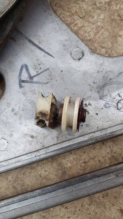

Is this the roller that you need.
This is from a 66 newport.

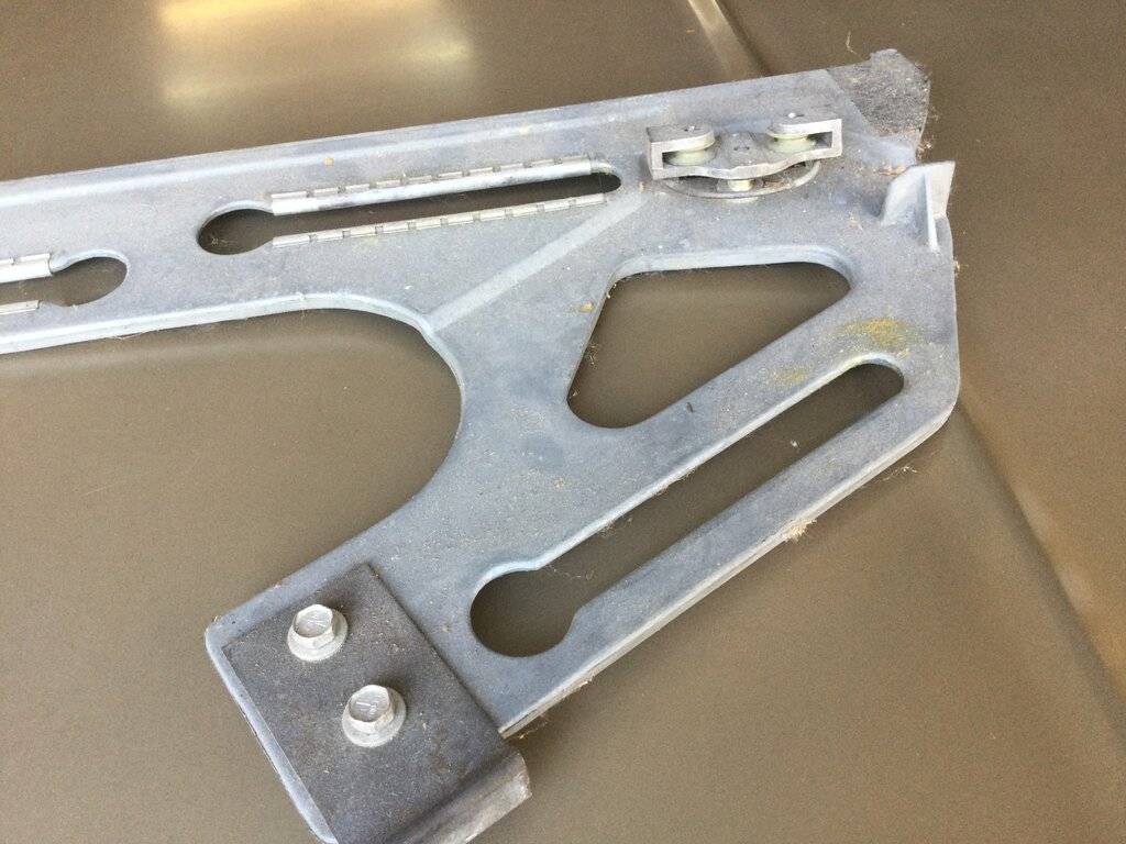

However this is the one he needs.
This roller is available. The nylon rollers don’t spin freely, but I don’t know if they’re supposed to. And the swivel ball doesn’t move the smoothest.
I had the same quarter window roller issue on the power windows in my '66 convertible. The roller is not serviceable. It is permanently attached to the aluminum frame in which the window glass resides. I had to buy one from Murray (not cheap) in order to repair my quarter window.
