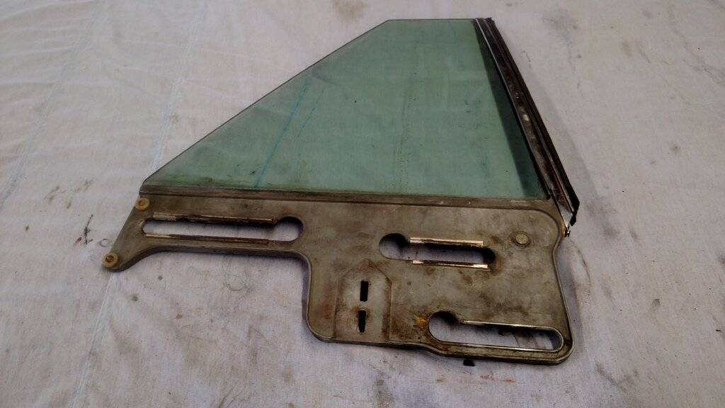

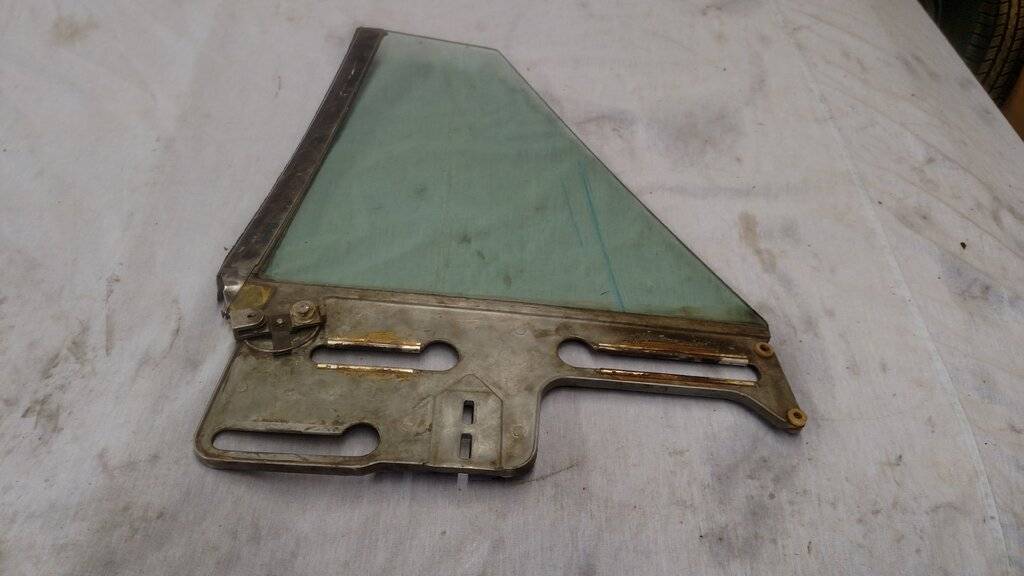

I don't think so. . . Here is a shot of the quarter window frame and glass I removed from my '66 convertible:

Hey! I appreciate that advice. However, my window frame was cracked / broken, so even if I could have fixed the roller using your method, I had to replace the frame anyway.
Ooh, ok. That is different from the bolt version. Is that roller held onto the frame using a E-retaining clip? Hard to tell from the picture. Thank you for showing your picture. I am dreading taking that window & frame out. It looks like a real pain in the butt!
Rip’s frame is from a convertible and quite different from ours. Our mechanism is different due to the length of the glass. It kinda pivots so the pointy end doesn’t hit the wheelwell as it goes down.

I hear you, Dan. I hope, for Dodge's sake, his setup is like yours and not mine.
The 66 Chrysler FSM shows the exact same mechanism as mine for the 2 dr hdtps.
I had the same quarter window roller issue on the power windows in my '66 convertible. The roller is not serviceable. It is permanently attached to the aluminum frame in which the window glass resides. I had to buy one from Murray (not cheap) in order to repair my quarter window.
