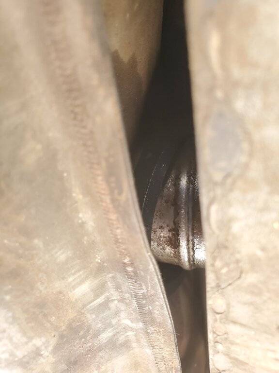

I was leaking fuel by the fuel neck. Took down the tank and replaced the grommet with a new one. Its seems to fit tight but not sure if maybe its not pushed in all the way but the point is I still have a small leak where the neck meets the tank. What can I do i could not find any pictures or instruction on how it should look. The neck does have a small small bump around the circumference. Should that bump be on the inside of the grommet or the outside.
The bump should be on the out side of the grommet. Did you check the tank for any debris from the old grommet before installing the new one?

Yes positive its coming from the neck I was under the car. Its does travel by way of the lip and falls in the front by the sending unit but the leak is in the neck. Yes I bought the new retaining ring because everywhere I saw it said you had to replace that. When I tried putting it in it does not clamp down right so I went with the new rubber seal and the old retention ring.
NOT SURE IF THESE PICTURES WILL HELP AT ALL BUT HERE ARE A COUPLE. QUESTION WOULD BE WISE TO PUT SOME GUNK AT THE BASE OF THE NECK BEFORE IT GOES INTO THE TANK. THINKING SOME SEALING PUDDY OR INSTANT WELD OR SOMETHING LIKE THAT TO PREVENT THE LEAKING.
There is something wrong with the fit of the filler neck and the tank. The bump in the filler neck should be flush up against the bevel in the grommet. Is the tank fitting up against the trunk floor?
I agree, your neck is not aligned properly with the grommet. Not even close.
Wiggle the neck in place, seating it properly, then twist/wiggle to align the attachment screw. It may take some effort, but should 'fall' into the proper location within a few tries.
There is a of of variation in tanks and filler necks in C-bodies, from year to year, and sometimes between carlines of the same model year. Do you have the correct filler neck?
I will try and wiggle it some more. It looks like the neck and tank are original to the car so it should he the right parts.
