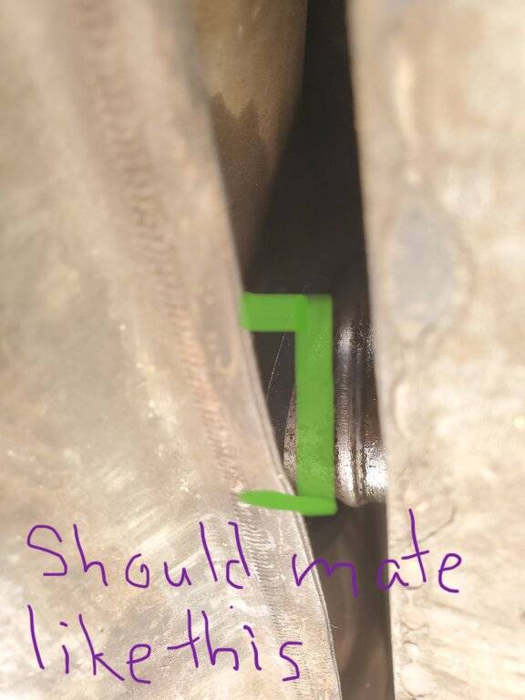

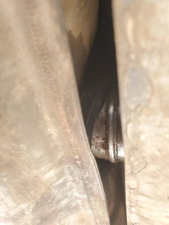

NOT SURE IF THESE PICTURES WILL HELP AT ALL BUT HERE ARE A COUPLE. QUESTION WOULD BE WISE TO PUT SOME GUNK AT THE BASE OF THE NECK BEFORE IT GOES INTO THE TANK. THINKING SOME SEALING PUDDY OR INSTANT WELD OR SOMETHING LIKE THAT TO PREVENT THE LEAKING.
Took it back out a couple times and finally got it to stop leaking. In the struggle I caused a leak with the straps. Used epoxy to seal the leak and its was good. Had to take off the bumper to get good angle on the neck to get it in right.
