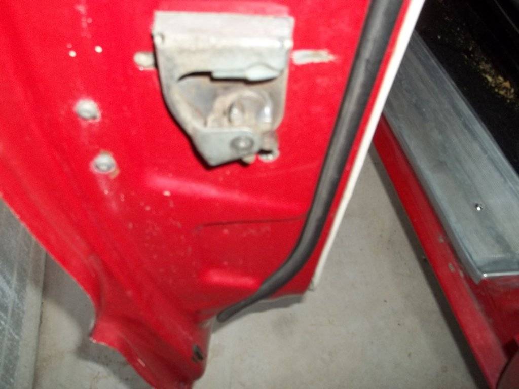

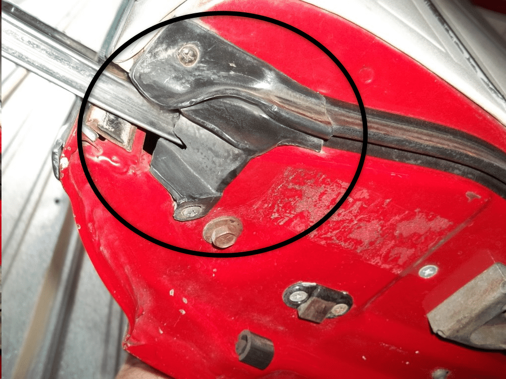

Once you get to the car, can you take some pictures of the actual door seals?

Mr fix it, I shot a few photos of the door weather strip and I hope they are useful. I couldn't get my door open very far in the storage place.

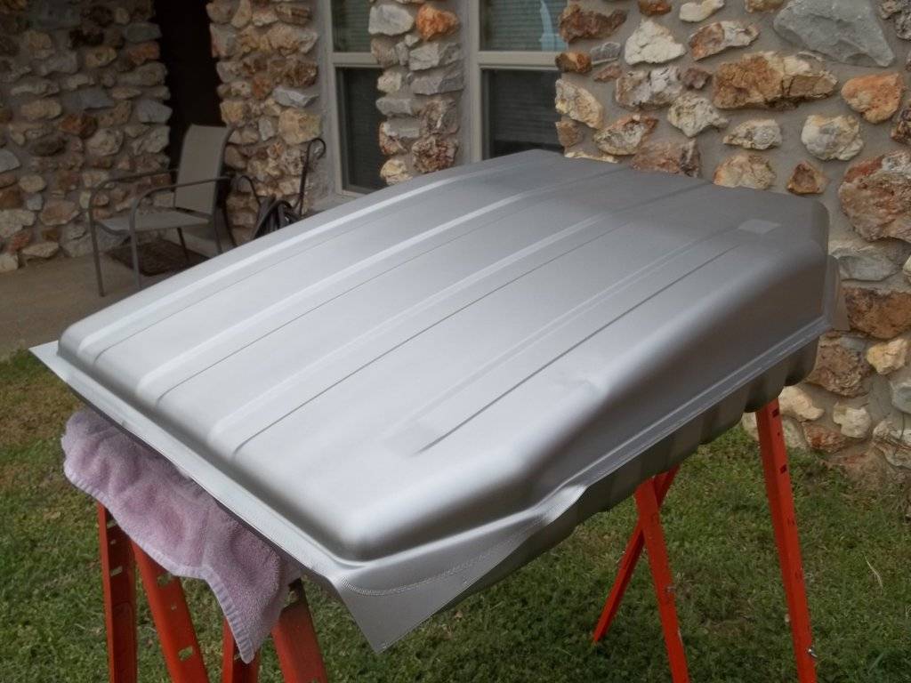

Last evening the UPS person left the tank at my front stoop

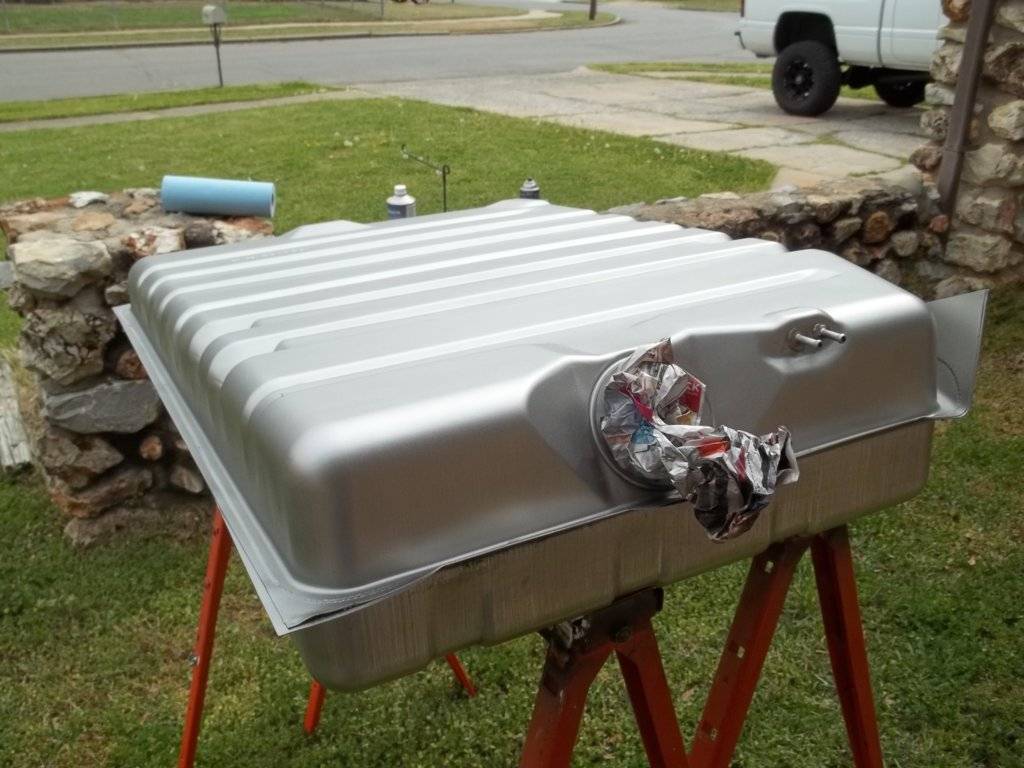

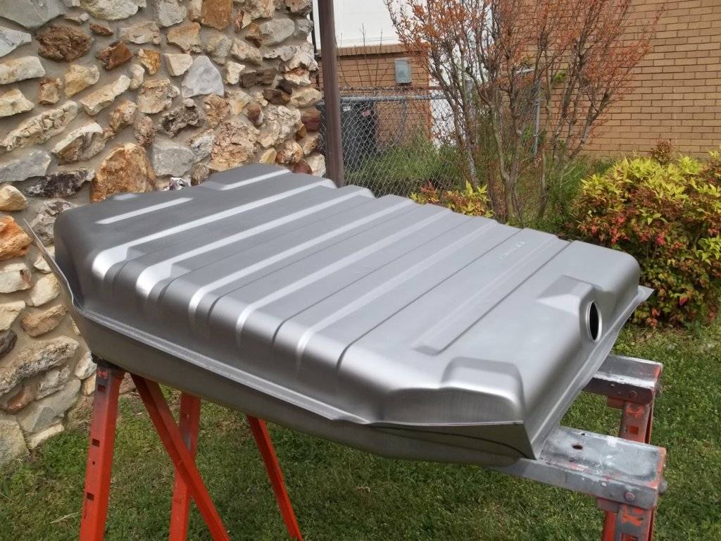

Today I unpacked everything, wiped the tank down with wax and grease remover, Scotch Brited it, and coated it with some stainless paint. The new straps will get the same treatment.
Sadly, there's a little ding in the tank. Not nearly as big as the dent in the original, but it's not perfect. Not sure who to blame but I painted it and will use it.
Things like this are why I sing the blues.

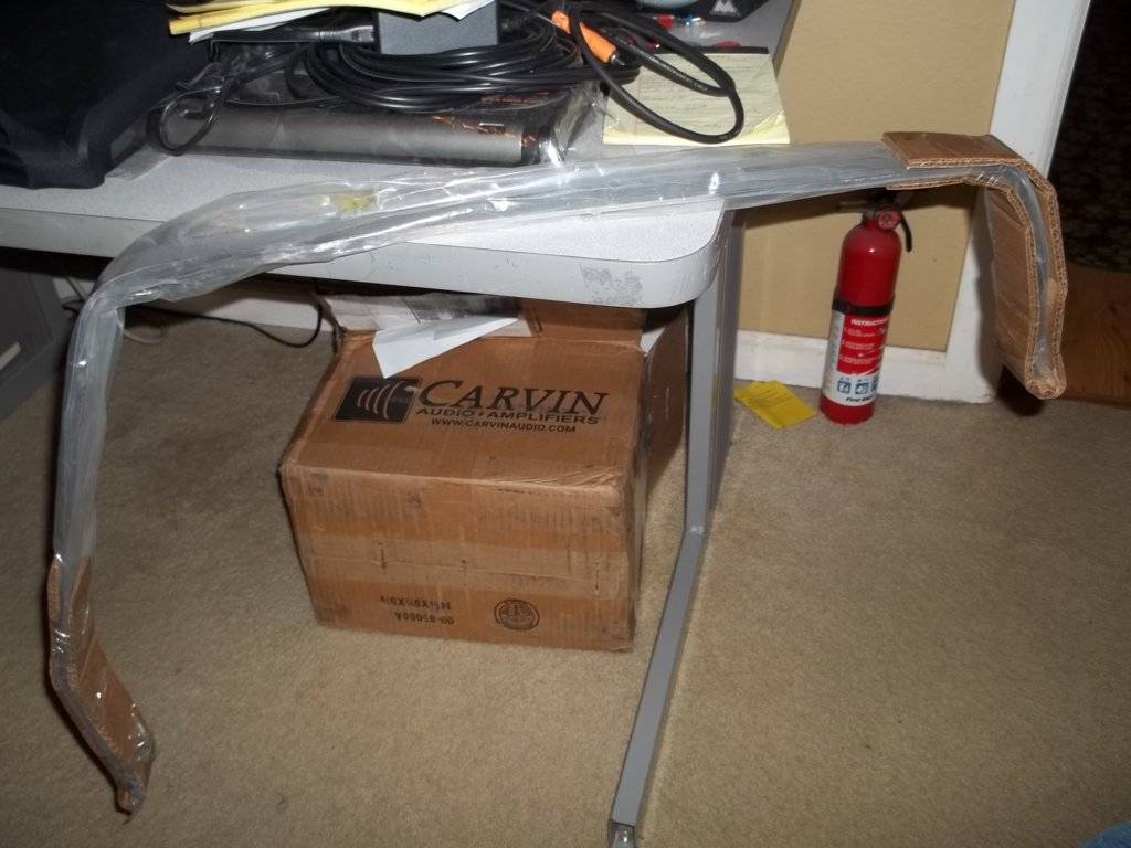

Ok, now I'm really irritated...
This is how Vans shipped my straps...bent around my tank. I'm guessing this is why they sent an unexplained refund for $30.00.
Has anyone else had this issue with Vans?
Or is this how they ship these things?
I haven't gotten a tank strap in ages, but the ones I got were folded, and I had to straighten them. Not a Mopar but a strap nonetheless.

And I made my straps up from the originals and 1" metal strapping... Not quite as pretty as OEM but very functional at pennies on the dollar...
As you get into the car, you will have to let your creative juices flow for metal work.
It's way too cold and wet to paint today, and my friend Arthur Itis prefers to show up on days like this too.

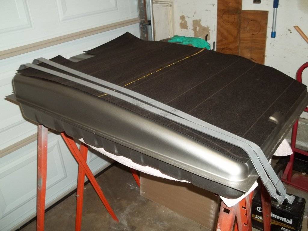

However, I managed to straighten out the tank straps into something acceptable. Pulled the new tank pad out of it's shipping box and set it out to go flat
