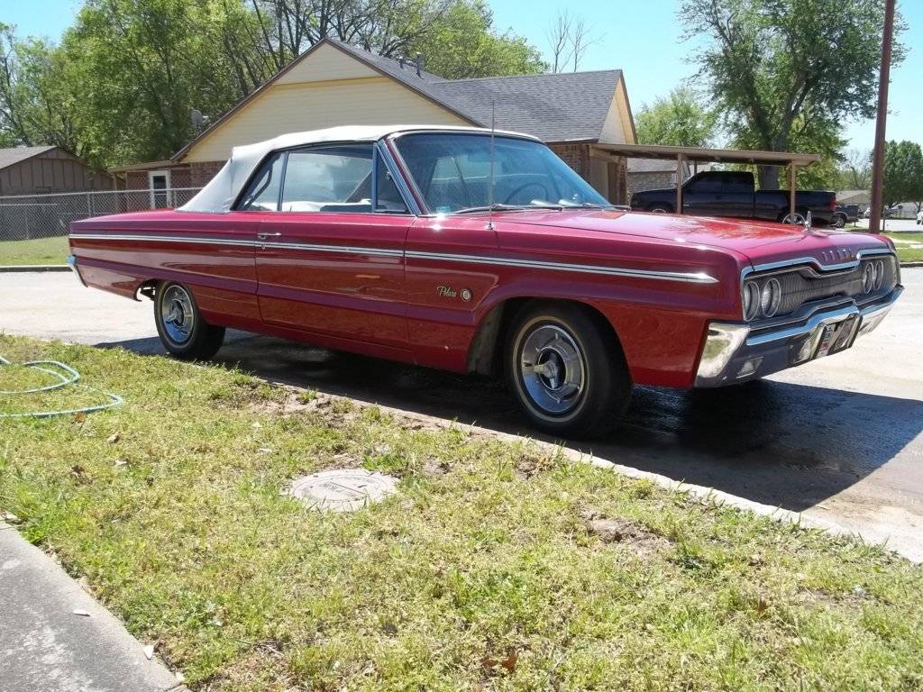

Today my lady and I fired up the Polara and she followed me over to the License place. We'd hoped to get a title for it, but they needed to see the VIN on the car. It was not to be, not on a Saturday. They were shorthanded and the line was to the door.
So the car got a nice drive around time and I insisted we go back to the house and wash the crap off.
We couldn't park on our new driveway yet, but we still got it washed.

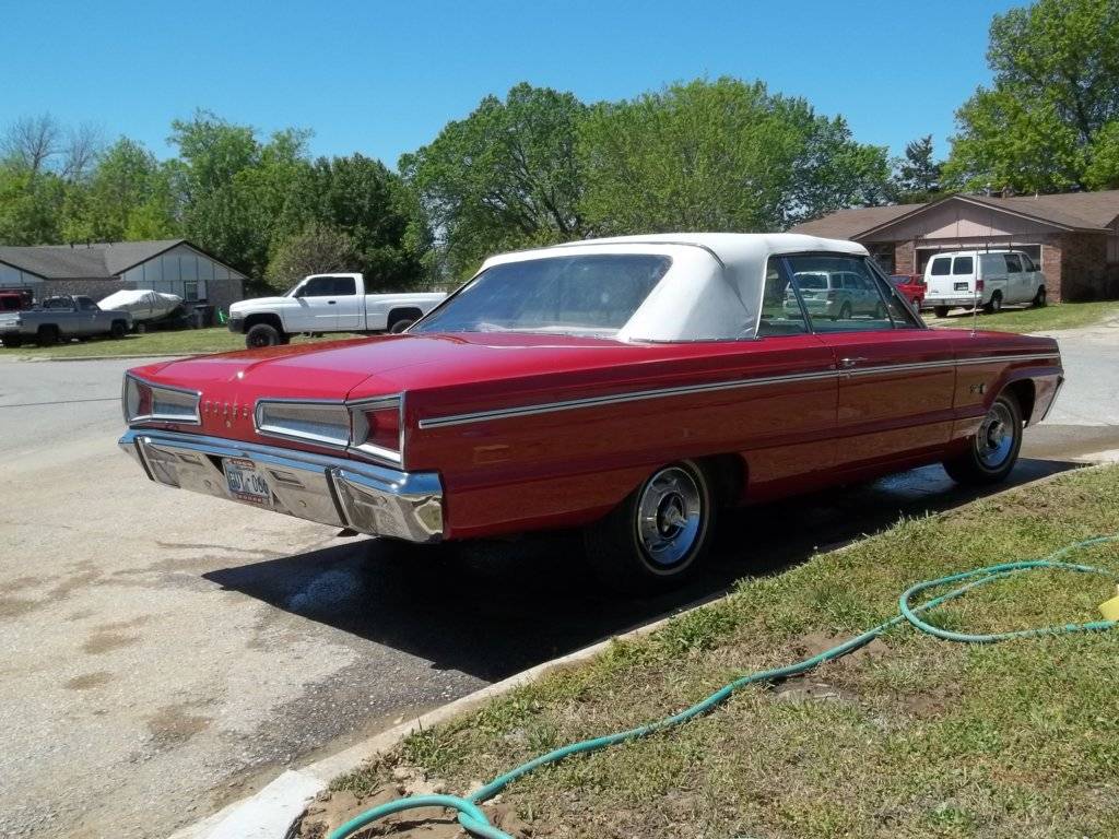

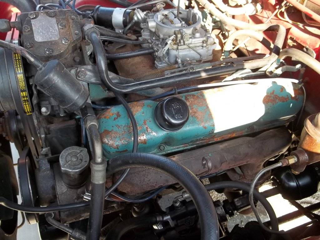

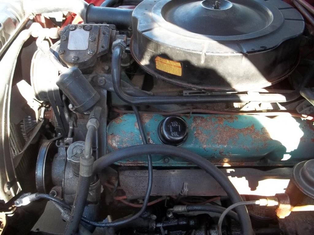

I pulled the distributor cap, the points look burnt, and the ignition coil appears to be leaking. That'll be high on the list to do.
The oil cap looks to be too short. Don't 66 cars have the taller version? I flushed it with brake cleaner anyway and sprayed it black.

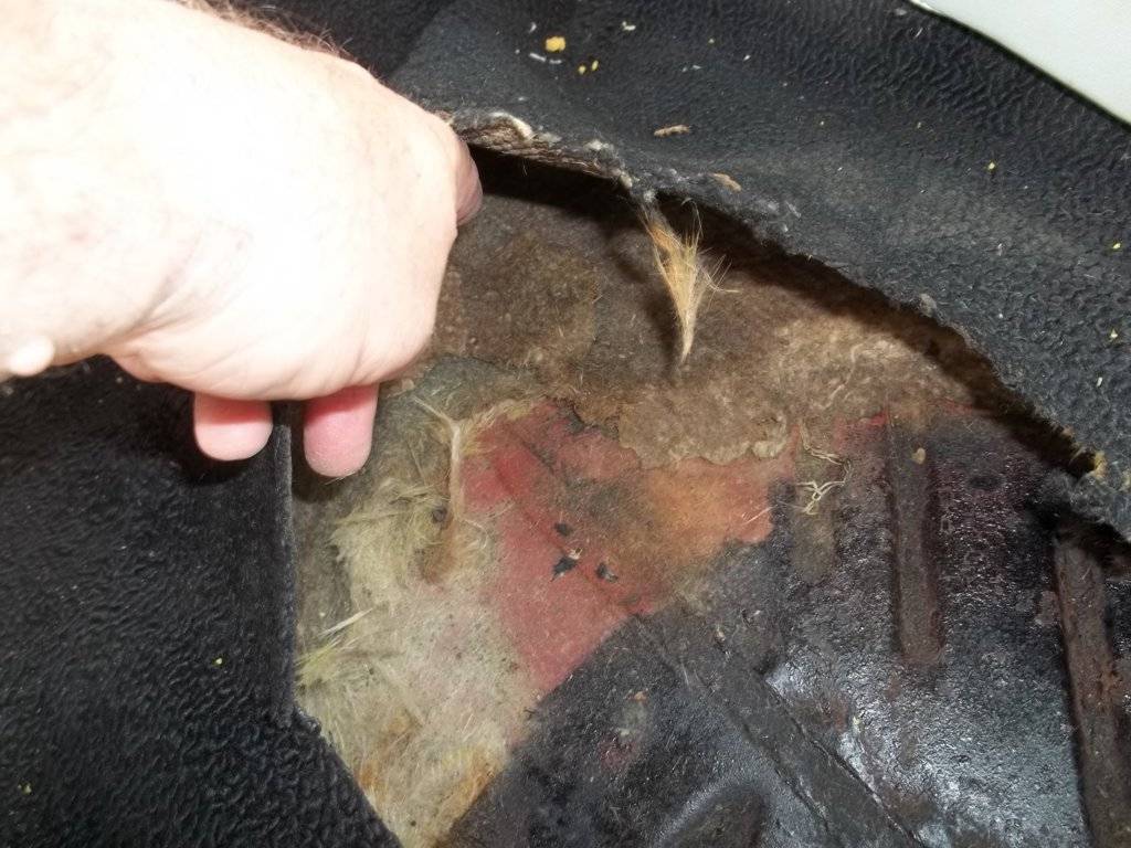

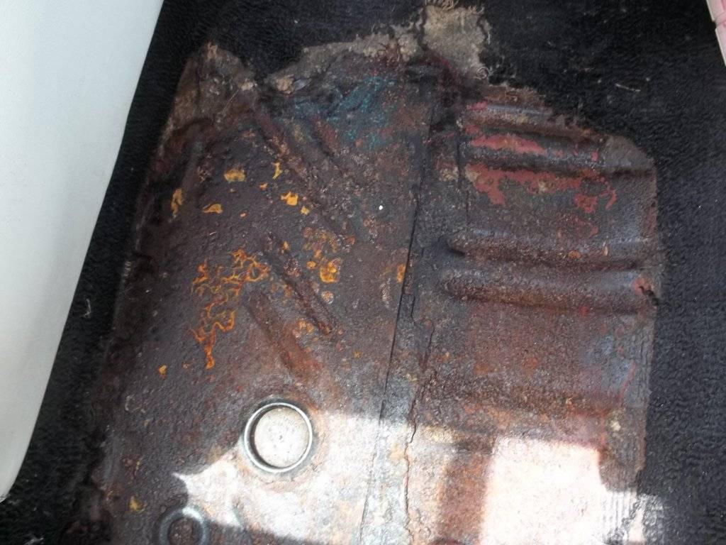

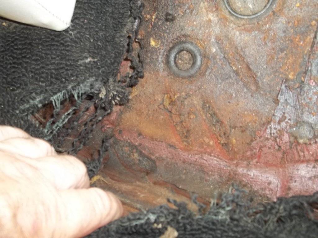

Today I started looking at some of the floor rust, and I thought I'd found. This is definitely the ugly part of the project and I'm not sure how this happened. The rocker panel area is at the bottom. Passenger side
Passenger side by transmission tunnel. Was this a top leak issue? Did someone put a battery here, on both sides?

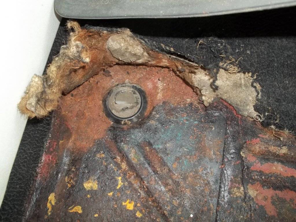

Here's the "hole" the PO mentioned, or the one I found. Looks like the plug was drilled out. WTF?
Drivers side...
Not as bad, but not good. I must deal with this quickly!
Any suggestions from the crew?

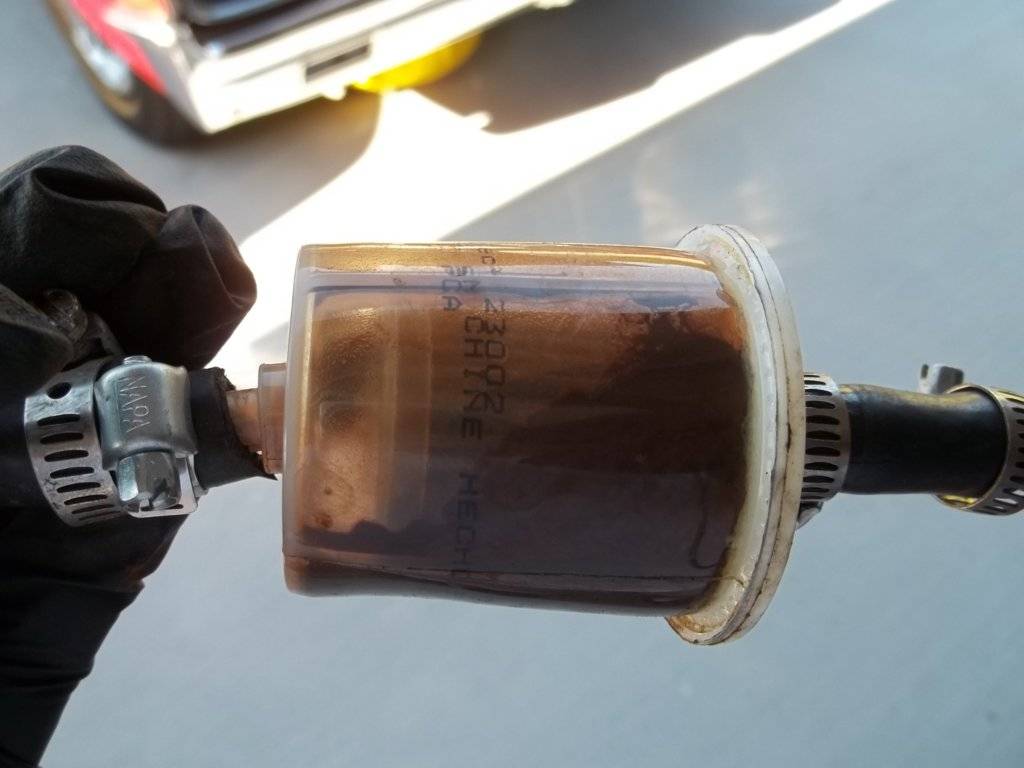

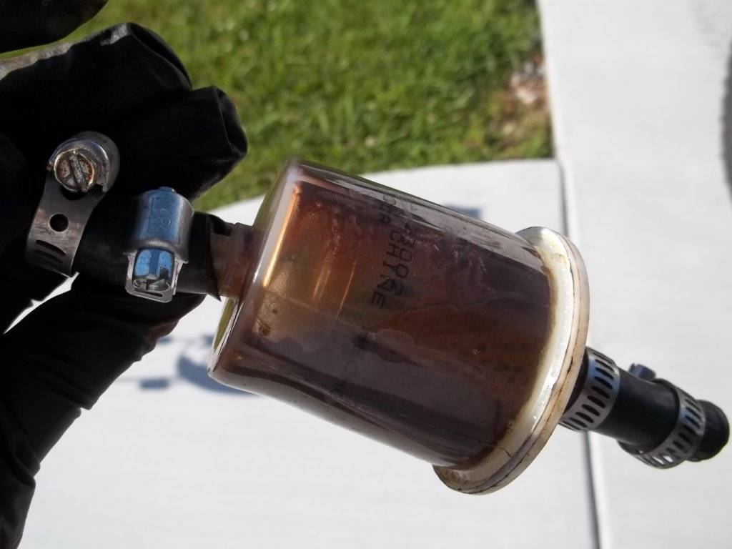

Today I changed the pre-pump filter. The last one was changed March 31st and was post pump. The post pump filter still looks good but the pre-pump one...
As you can see it's got a lot of crap in it. I expect the the sending unit is no better. Probably saved the fuel pump!
So I replaced the filter and the line both and all is good for now. I have plenty of filters until I get the tank replaced.

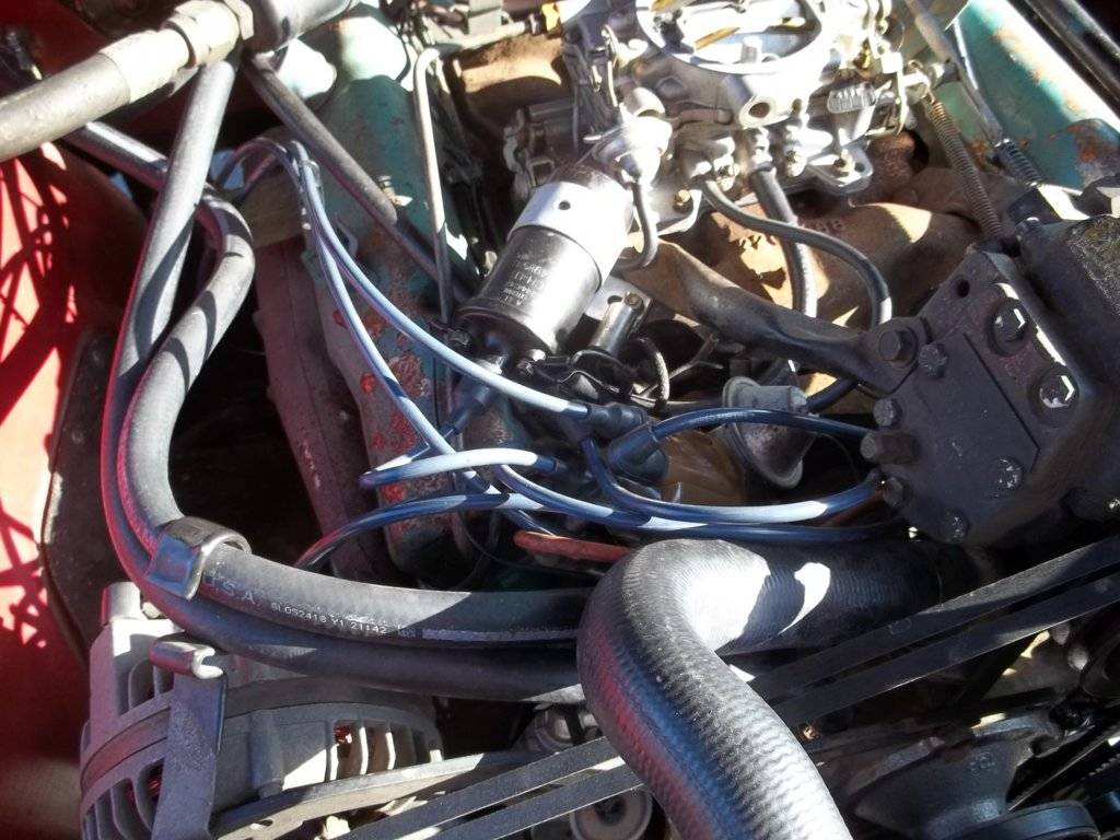

Finally finished my "tune up" today.
Points, condenser, rotor, cap, wires, and plugs. The coil is leaking so I need a new one.
From this...
To this!
Hadn't replaced #1 plug wire but it's done now!
I forgot what a !@%#$!&&&*@%! # 7 plug was to replace!
