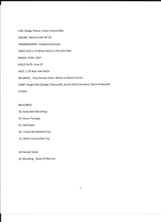

1967 Dodge Polara 500 Convertible
Now I'm wondering if it has a sure grip. Hope to find a build sheet too.
Built in Belvidere. I can't find any production numbers yet.

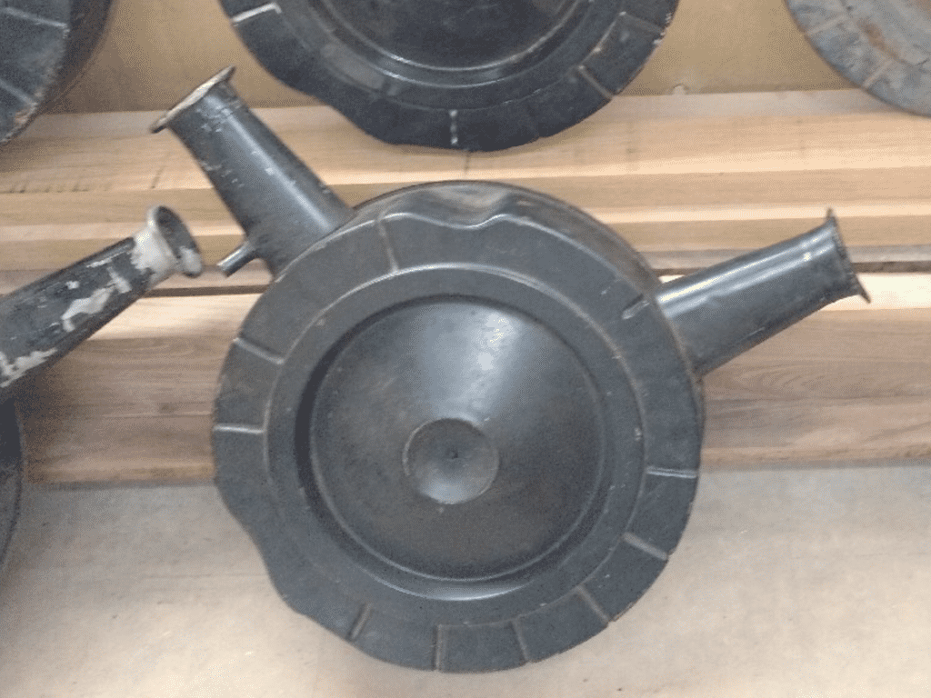

I have a couple of dual snorkels to but those aren’t as free.:lol:
The lower one has a bunch of holes drilled in it around the outside.:BangHead:
I'm wondering if it came with a dual snorkel. Let me do some checking Matt.
What will it take to get the one with no extra holes?
I found references that show two 67 C body HP 383 with dual snorkel air filters. None with single snorkel or unsilenced.
I'm guessing the dual snorkel is correct.... ?

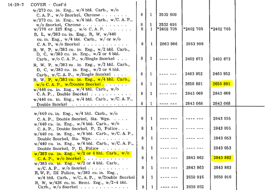

From looking through the parts books it looks like the '67 383 4bbl., for Plymouth, uses the dual snorkel air cleaner with the round snorkels(the same part number as a '66 383 4bbl., and I think they all used round snorkels in '66). The '67 440 used a different air cleaner with a "newer" part number, so I would guess that those were the oval snorkel.
There is even an air cleaner listed with no snorkels. I have no idea what that one would look like.

Thanks for your help. Pretty much the same with Dodge C body's. Only difference is C.A.P or not.
The housings without a snorkel are the unsilenced filters. Popular on the A body's and very efficient and very loud.
