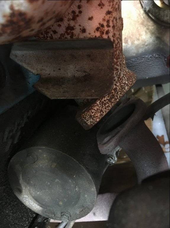

She'll get back together either way BUT I have to say this, the main hanging area is with the single exhaust. Now, I'm not certain my system is original to the car but considering the climate it lived it and the condition of the system as compared to the rest of the car, I'd say it is aside from the muffler. Dropping the y pipe, the pass side arm hangs on the t bar. In order to shift it over enough to clear the t bar, the starter has to come out.... the flange literally overhangs the positive post on the starter by a 1/4 of an inch.
It's a slight difference to be sure but it is different than a dual set up and a c*** hair more of a PITA for that reason.

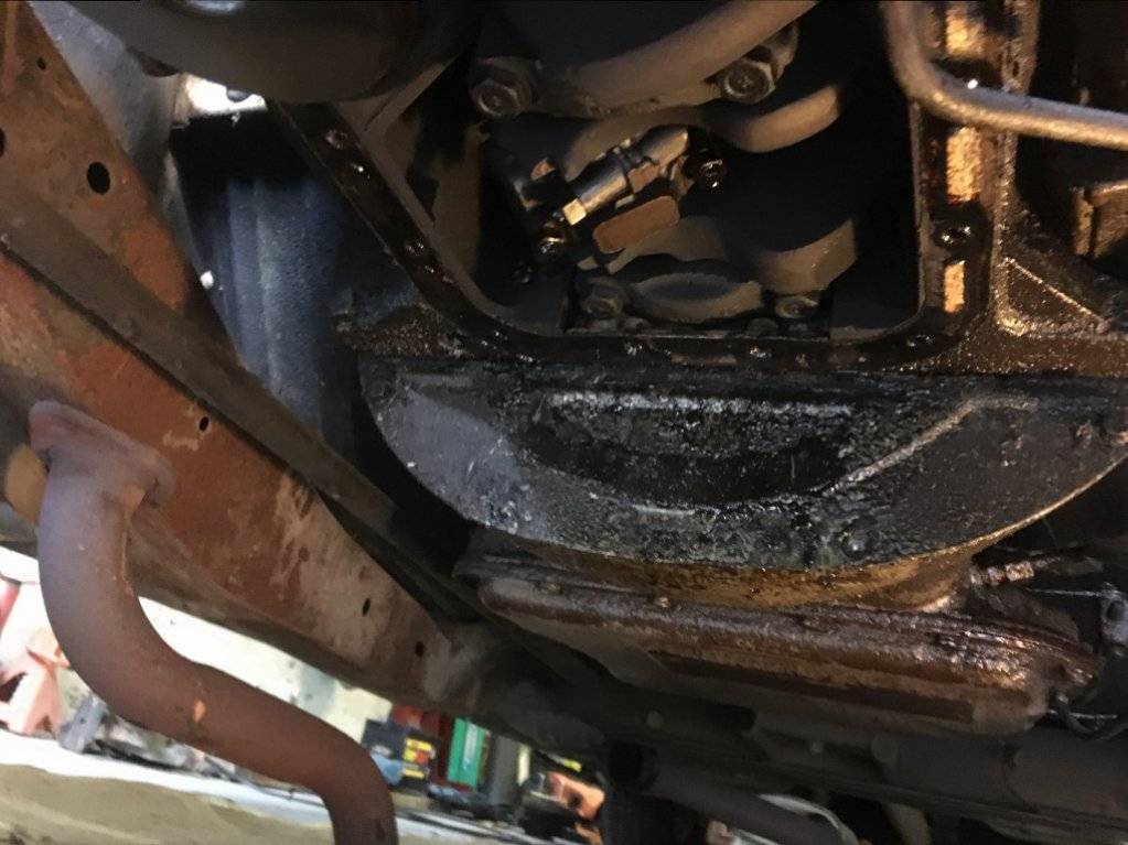

Ok, these show very little of what they were intended to show... BUT!
First, my perceived issue with the post on the starter was total bunk. Once the coupling from the y pipe to the rest of the exhaust was apart, the whole y pipe slides forwards and drops to the floor. THERE IS NO NEED TO REMOVE THE STARTER.
Underneath, with the y pipe and the center link down, two bolt heads on the absolute bottom of the inspection cover are all the clearance needed to drop the pan.
I can't say what all anyone would encounter on different varieties of CBodies, that, had I not had my head up my ***, was not so bad.
