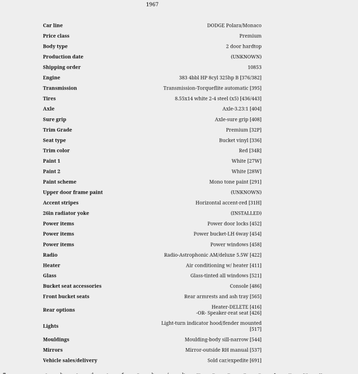

A few additions from my opinions to populate the list.PM sent. As for the tag decode, this is what I get:
Here's what I get:
a6 -
b5 -
d6 -
h7 -
j4 - pretty sure it's a side-trim code
k7 -
u1 -
A1 -
H2 -
J4 -
K8 -
R2 - radio (am with front/rear speakers) or maybe FM radio?
S1 -
X1 - all tinted glass
A4 - 3.23 rear axle
X8 - sure grip (!)
TRM - P6R premium grade vinyl on the bucket seats, red interior
PNT - WW1 (monotone white)
UBS - H (upper door frame paint) H is Tan?
62 - 383 4bbl
5 - automatic trans
635 - 8.55 x 14 tires white wall (4 + spare?)
C19 - December 19 (scheduled build date)
It's a Monaco 500 (console, bucket seats, fender turn signals, wide side trim). Was the 500 package indicated on the TRM code? Was the 3-spoke steering wheel part of the 500 package? Or did all US Monaco's get that, regardless of trim level, and Polara's (and non-500 Canadian Monaco's) got the 2-spoke wheel?
One of those codes is going to be for A/C. Another code for power windows. No cruise control, no tilt/tele steering. No bumper guards. Check for power (vacuum) trunk release. Does it have shoulder belts? Has the radio been pulled from the dash? Almost certainly made at the Belvedere plant. I'm guessing the vin is going to be DP23H74xxxxxx.

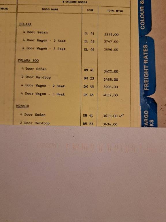

Does the DP23 automatically code for Monaco 500 which by default indicates the wide body trim, so no other tag code for that is expected?

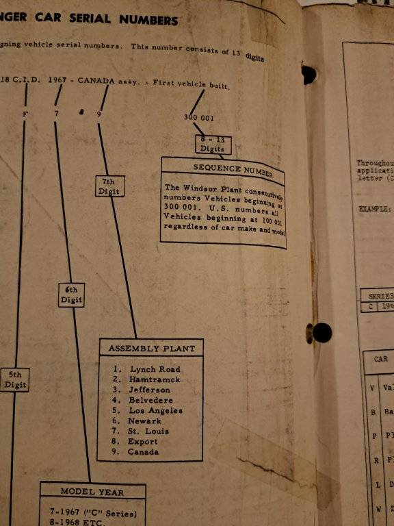

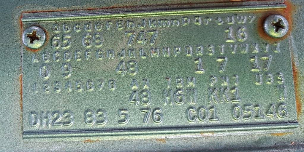

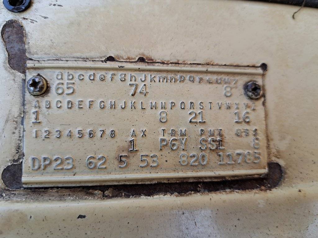

Are there definite examples of how Windsor and Belvedere differed in terms of '67 C-body plate codes? I think they used different formatting for the wheel/tire codes. Yes. There are differences between the plants. Windsor uses a two digit tire code, Belvedere uses a three digit code. Windsor uses w/6 and w/8 to distinguish between US and Canada bound cars. The Windsor plant VON and VIN series are different depending on whether it was built for sale in Canada or US. (we had a very fascinating comparison at last year's VOLO show between two Windsor built cars. One was built for US and one for Canada.)
And what is the sill molding? the molding under the door
Cdn cars used philips head screws on the tag.
Belvedere used rivets
Both tags here are Windsor cars, but 2nd tag is a US car.
Yes both say MADE IN CANADAI assume that both VIN tags on those cars say "Made in Canada"? Did they both (originally) have US-style Monaco tail lights?
Besides the W8 stamp on the tag, what exactly made it a US-spec car? I'm not doubting that's what the W8 is meant to denote, I'm curious what technically would have been different about it.
Having a different VIN pattern is largely irrelevant (or - to be expected). There has to be something more substantial to make it a "US-spec" car - no?
Then in 68 the first two letters of VIN was same on both sides of the border,lol.The different VIN pattern is not irrelevant nor unprecedented.
Different VIN assignments would be a way of managing any parts specific inventory as well as any accounting for any trade agreements in place at that time. One would be able to track how many cars stayed in Canada and how many were shipped to the US.
The different VIN assignment is a good example as to why the VIN number is administrative and not related to production.
