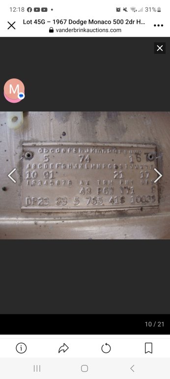

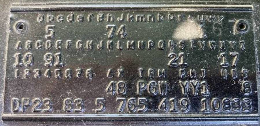

Belvedere car, sold car,.
Note has w6 but that does not mean Canadian spec car.
Has U.S. VIN DP for Monaco 500 and US sequential number respectively.
Code 83..440 Magnum! Rare gem!
That is not code w/6. That is part of the inspection stamp 67. Notice the 6 is impressed into the tag, not pressed out like a sales code. Plus, in my estimation, the 10*** SO also indicates a US sold car.
