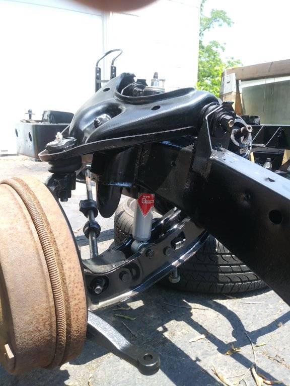

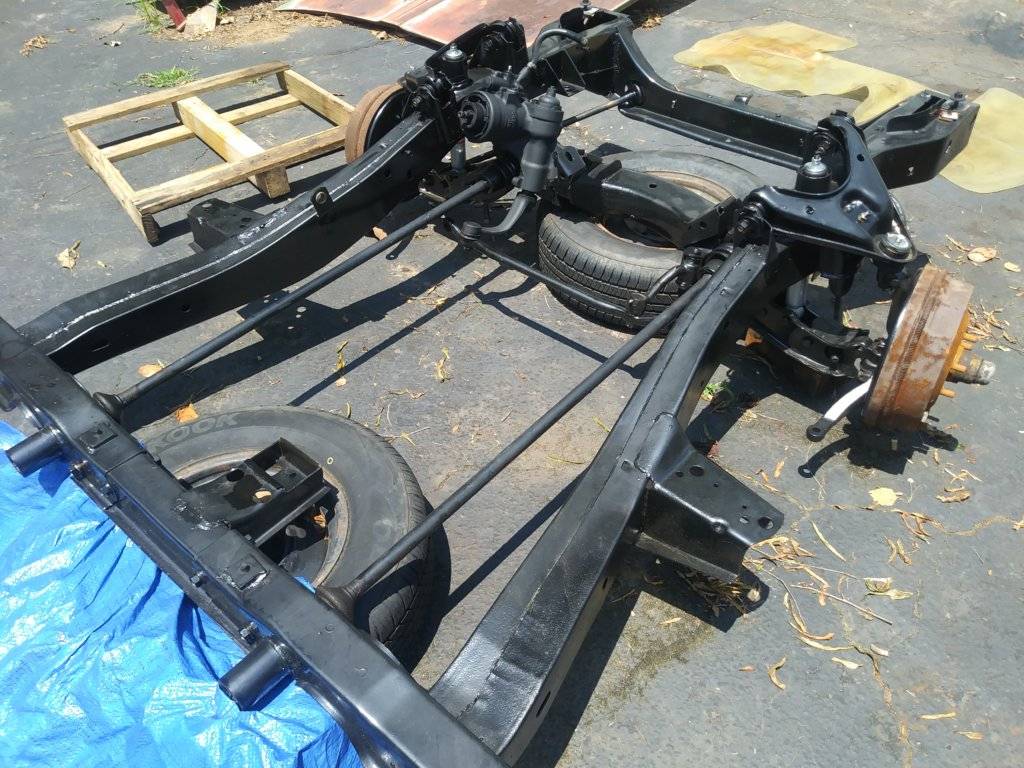

Well today I was able to get the steering gear back in, all the brake hardware replaced and lower ball joints swapped for the PST ones. I'm keeping the old ones just in case. They are still good but have bad boots. I have to get the sway bar in and get the. Tie rod sleeves painted or powder coated then they can go in and the frame will be done and ready to bolt back in the body.

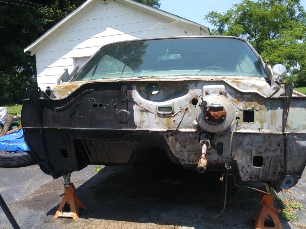

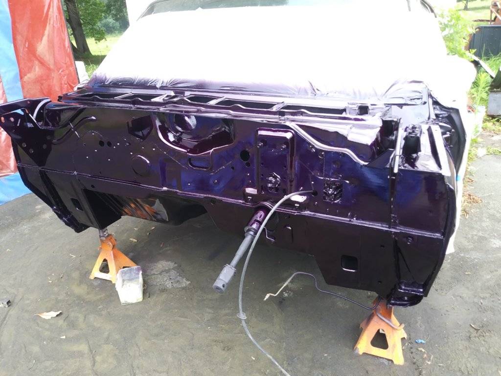

I still have to weld the last panel into the firewall before I can paint it and install the frame. After that...blast the fenders and other sheet metal and paint them, Install new brake lines and wheel bearings and start assembling the front end.

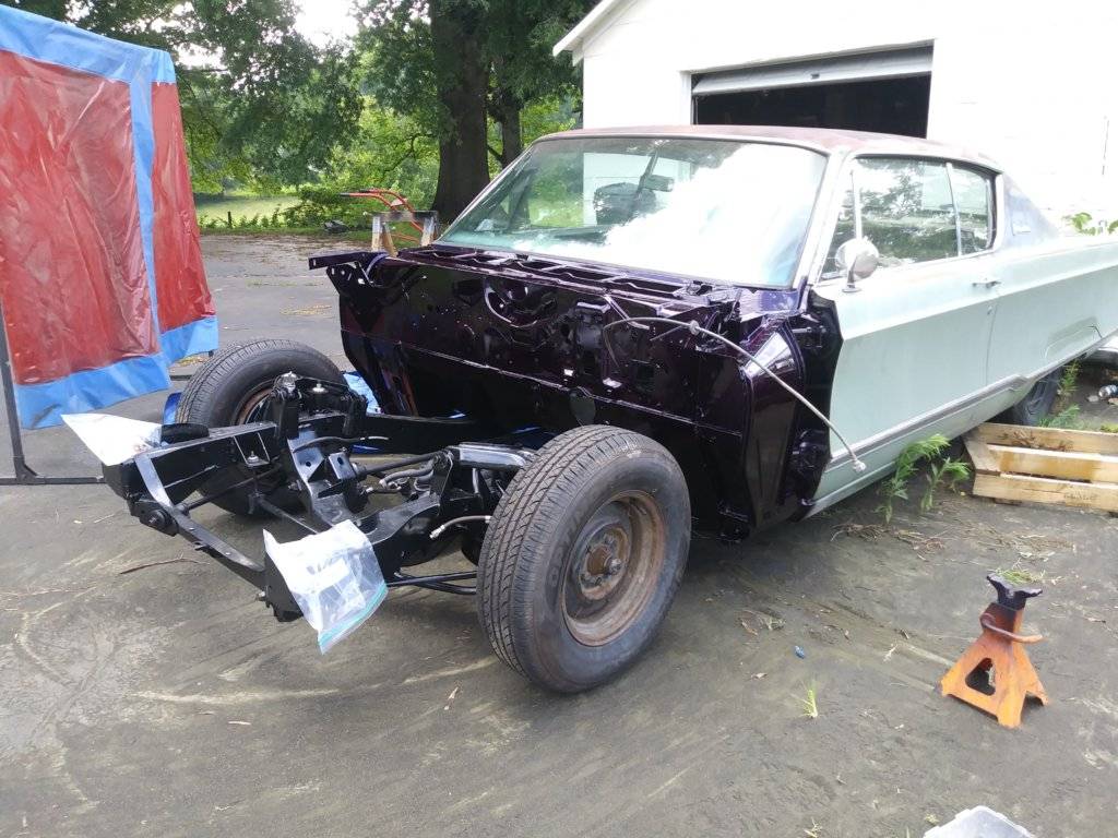

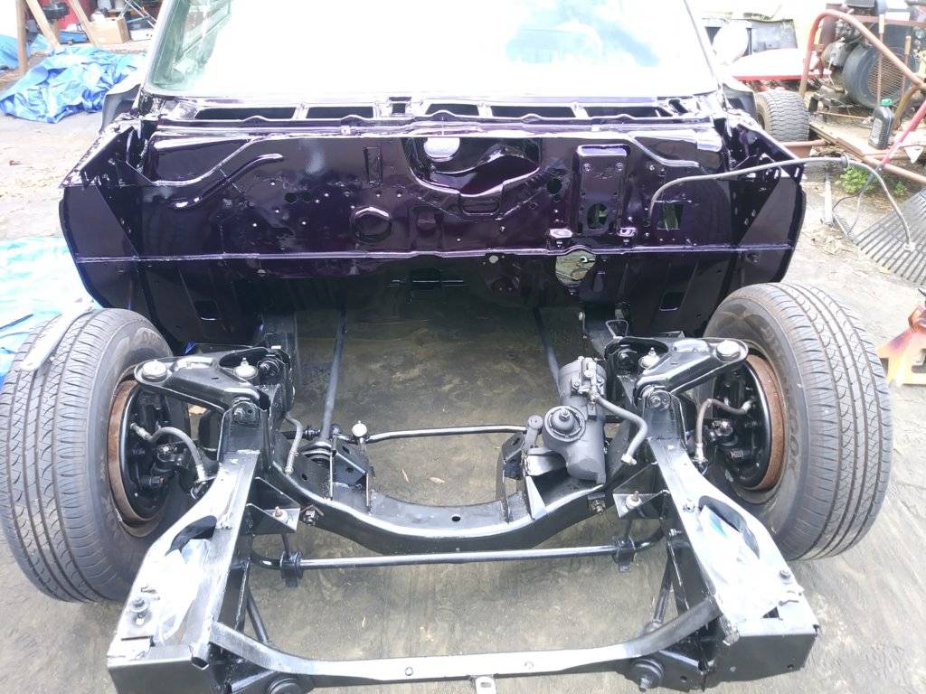

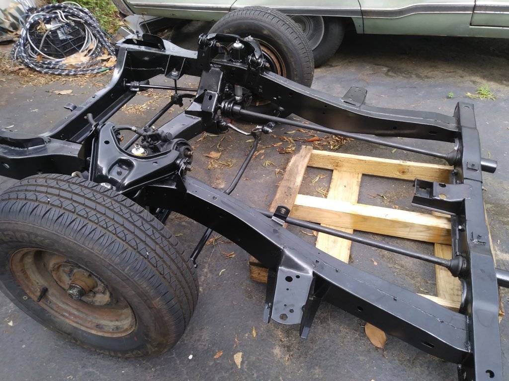

Pics
Subframe suspension is complete...every single bushing and joint is replaced. New wheel bearings are on the way. But otherwise ready to bolt back in.
So when installing the frame...I'm wondering if its just putting the bolts and shims back in or do I need to measure anything the make sure its square to the body?
