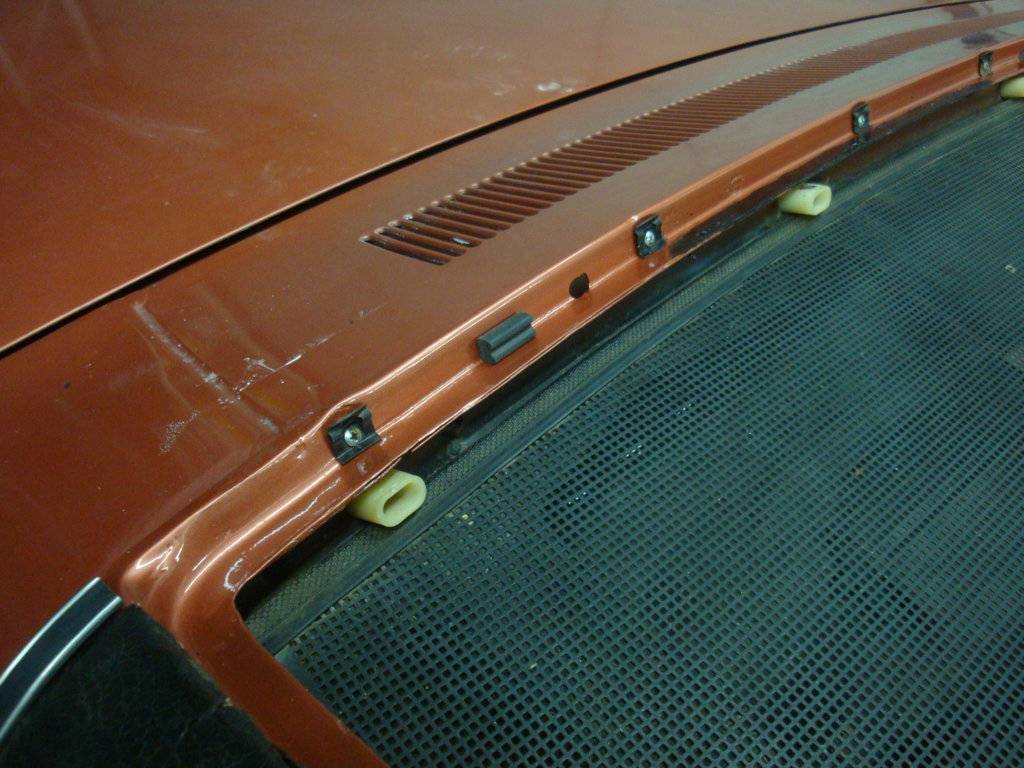

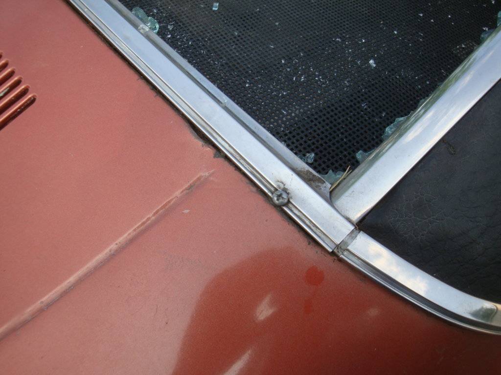

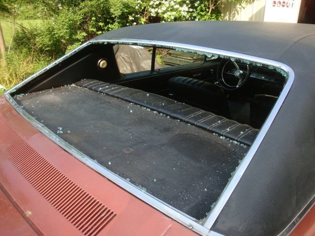

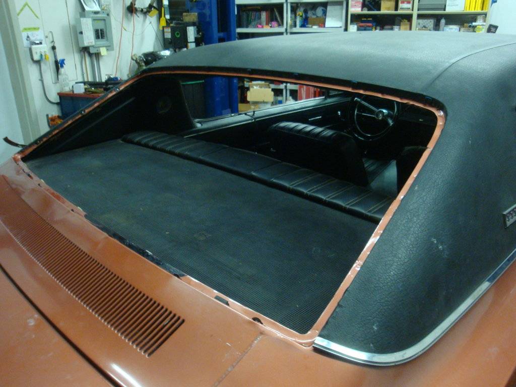

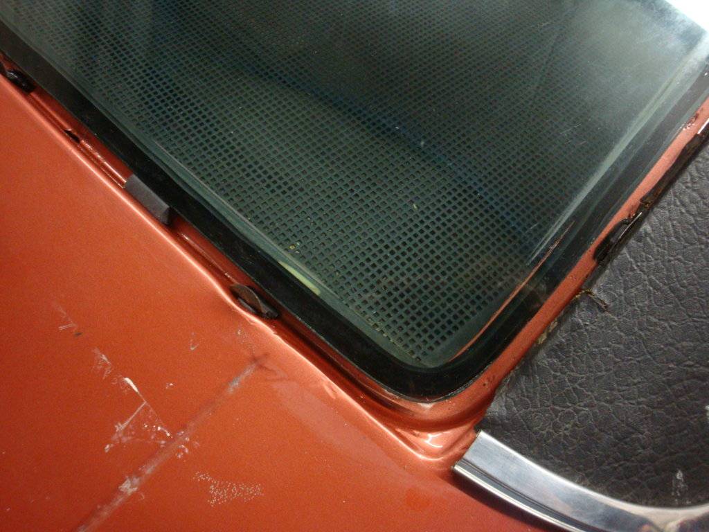

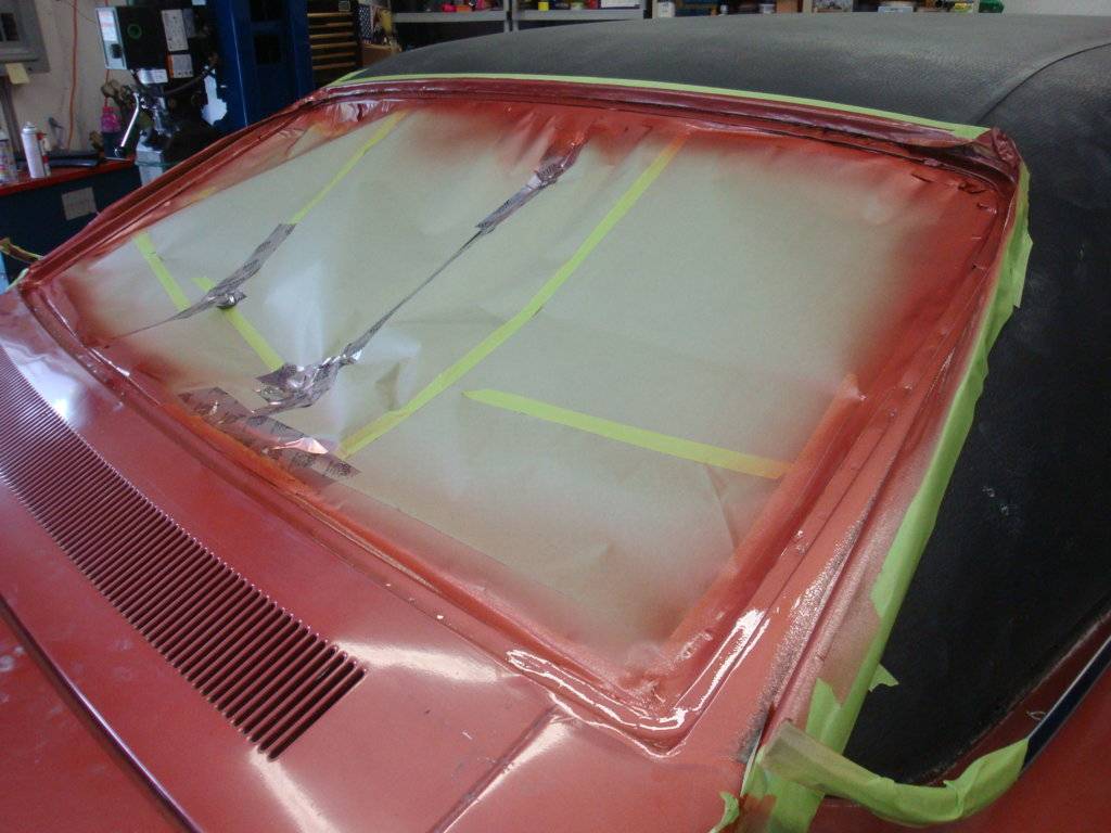

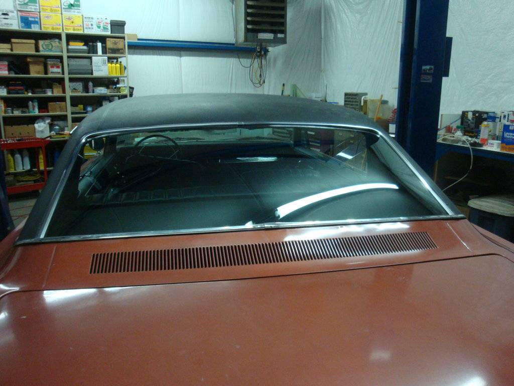

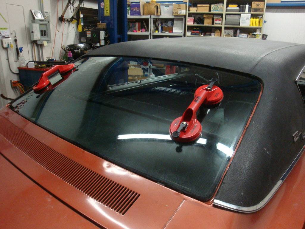

Hello Jeff I have a few questions I would like to ask you about trim clips can you contact me at i84885@gmail.com if it ok with siteUnfortunately, I didn't take any photos of the rusty window channel before I cleaned up the rust and painted it. Someone before me buggered up the mouldings and even managed to dent the dutchman panel when they removed them. The screw that they put through the trim was touching the glass and led to the shattered window.
