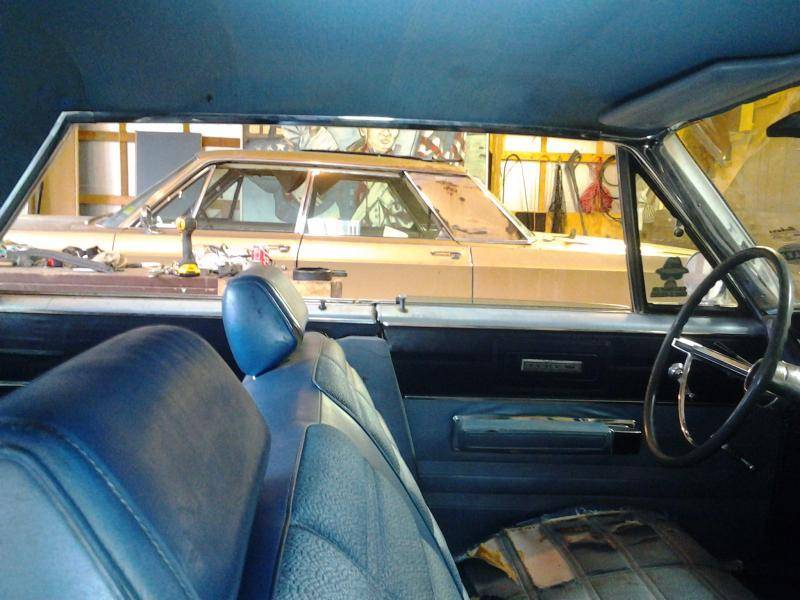

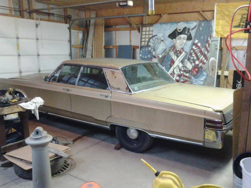

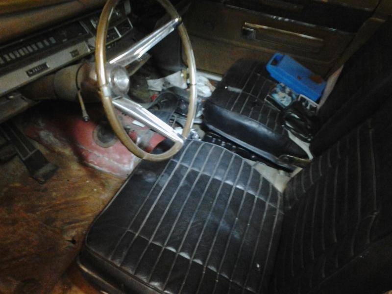

Will do Senator. Might be a couple of weeks before i make it there. I do take solace in the fact that the New Yorker will help someone else's project commando. Well heres one of my baby steps. Can you tell the difference. Other than opposite sides of the car.
Pulled the pedals out today Of the NY'er today. Thats was fun!! Ill bet this thing was a blast to drive with a bigblock 4 speed and manual steering. I heard rumors that the guy used to have a ratfink style shifter it. Oh yea I finished pulling the window trim from the NY'er and spent a few hours scrubbing the chrome . I redid the window seals and got everthing installed on the fury. Pulled the trans too.
A pillar and side window finishing trim on drivers side is chrome, pass side is plastic or painted

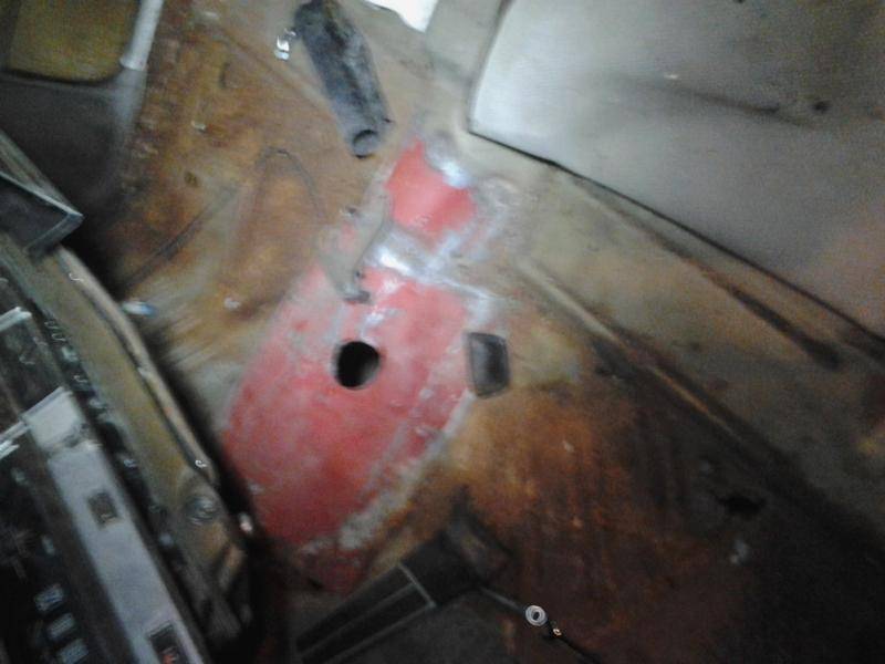

At one time im told it was a 440 4speed. It was not factory tho. Supposedly it has the super stock springs and a sure grip dif.
So exactly what was left of this 440 4 speed conversion when you got it?

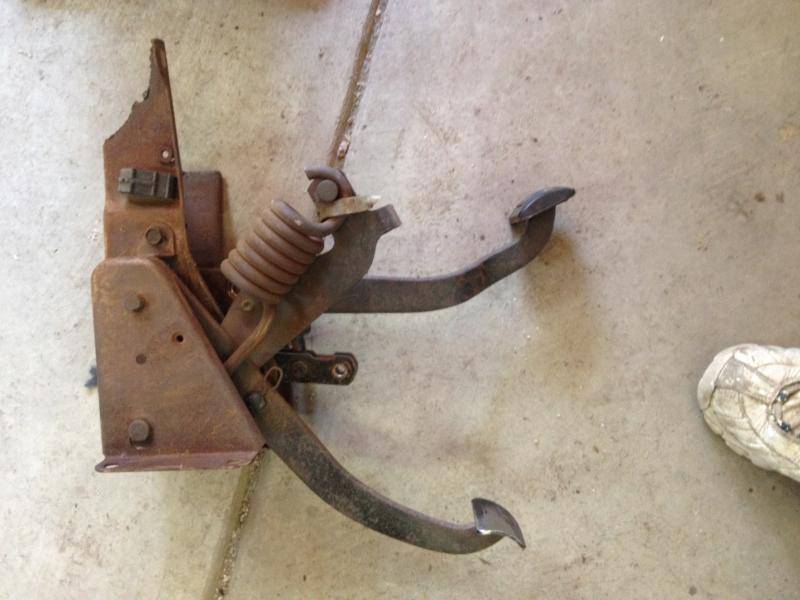

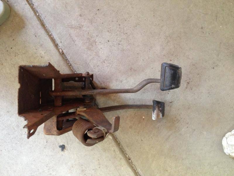

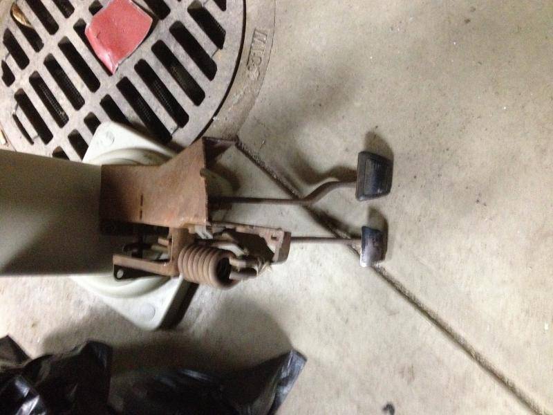

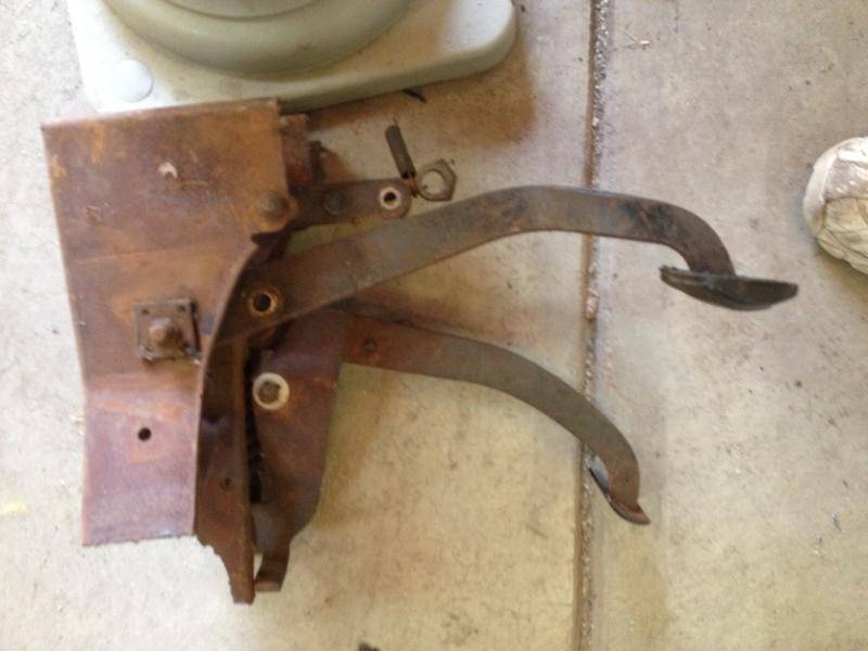

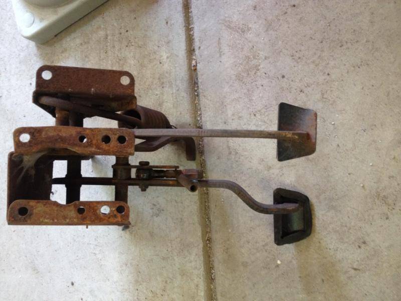

Can you post up a 1/2 decent close up of the pedals?
So this is exactly what is left of the 440 4speed. Just the pedals. Let me know if i missed an angle.

Thanks for the pics of the pedal assy. Yah, they were messed with, if not outright hacked.
Shame. There was no need to hack that assy if the had a clue on what they were doing.
The ting I am surprised at it is the small round hole on the tunnel for the shifter.
If an A833 4 speed was used, there would a have been a much larger hole.
That small round hole reminds me of the shifter used in the 4 speed pointy moose transmissions used up to 62.

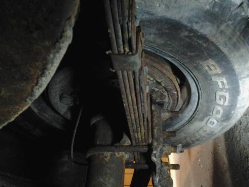

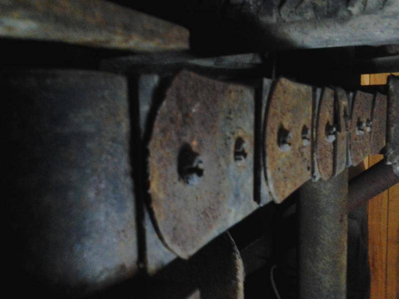

Would you post pictures of these springs and tell us how many springs and half springs are on each side
Sure will tallhair. Give me a few. Long day at work and now im in the middle of painting the headers.
Theres 6 leafs total. Its a pain thi a** to count the halfs while its on the ground so I hope this will do. Can you tell if they are super stocks?
