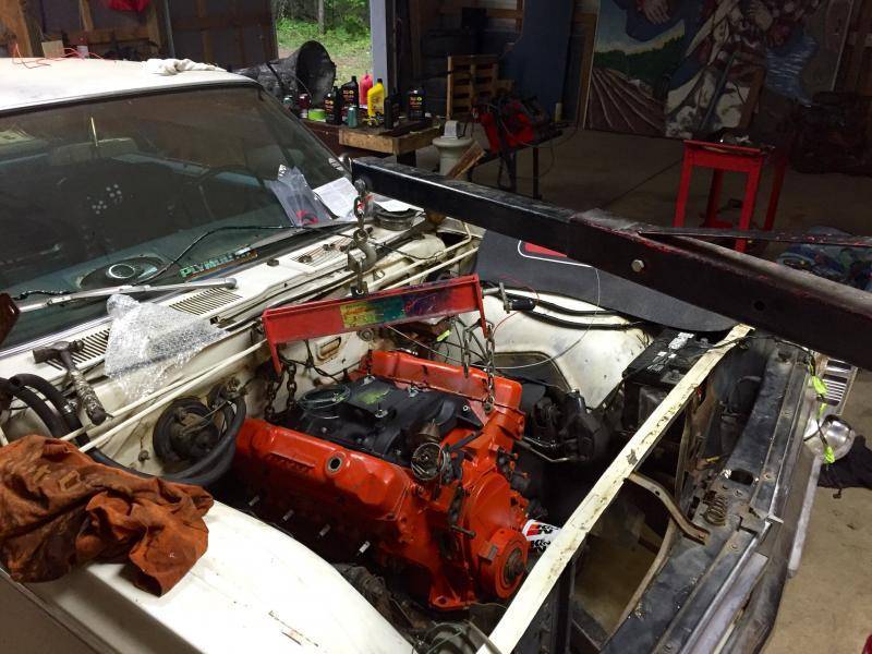

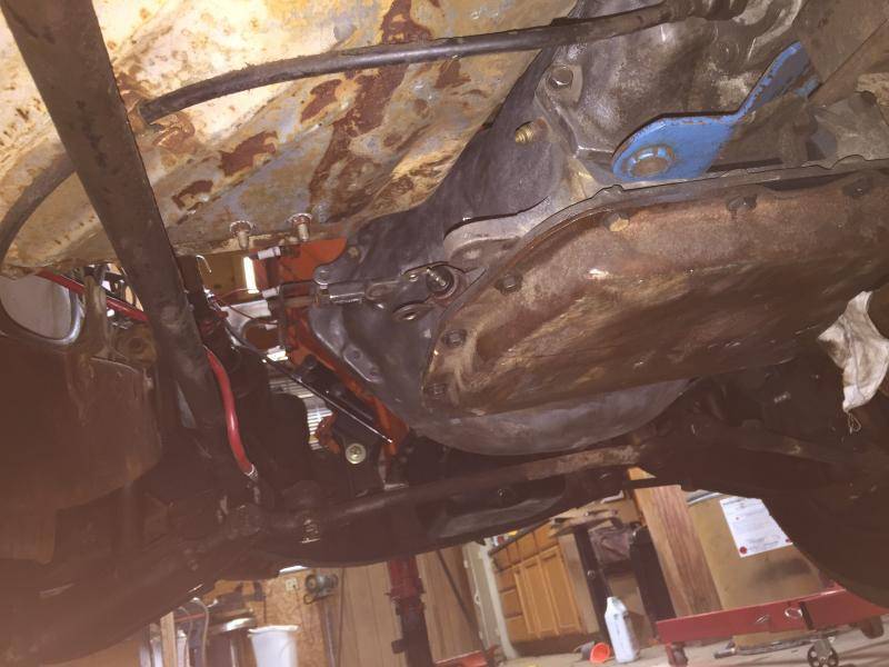

Getting very excited gentlemen! Trans is in! On one hand it doesn't seem like a lot left....on the other it does! That fn cross member fought me all the way but I won!
Yep. That's what it is rightly called.
EFN Crossmember.
People don't realize it's not a transmission mount.
It's a structual brace between the the two sides of Stub Frame that the tranny sits on.
EFN Crossmember.

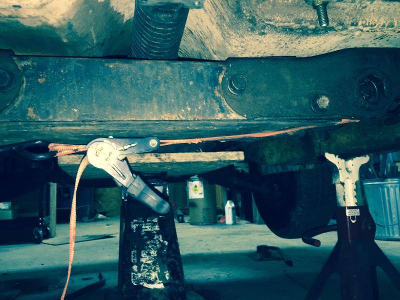

That would explain why the bolt wholes where off just enough to not thread in. A little jack manipulation worked wonders......wonder if I tweeked anything?
So for future reference , should I not unbolt cross member when removing the trans? Just unbolt the mount and wrestle it or....?

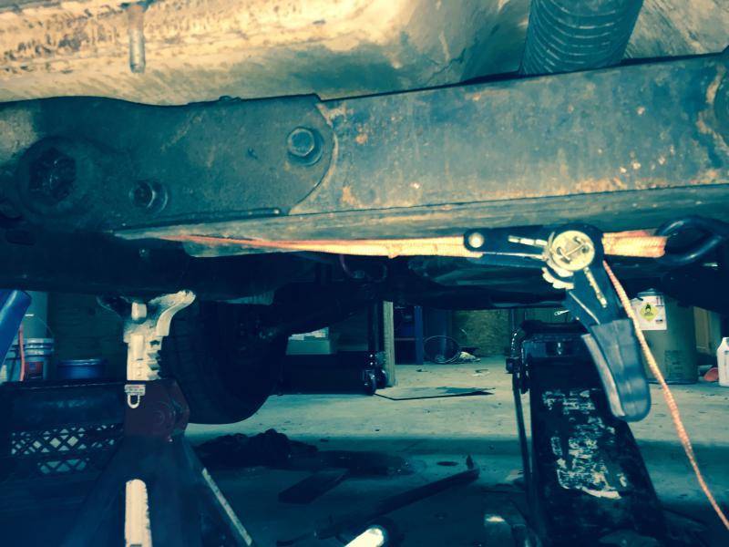

Well the trans is baaack in. And the flex plate lined up!!yay:os_dancing2:I did use a trick I learned for track bar adjustments on front solid axle jeeps using a ratchet strap. It helped quit a bit with getting the cross member bolt holes lined up. I attached it to the stub frame next to the torsion bar on one end, on the other end I attached it to the opposite side of the cross member. Ratcheted it until that side was lined up, then snugged my bolts on that side, then switched the strap to the opposite side of the stub frame and the opposite side of the cross member. Like butter is I can say!

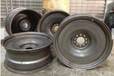

I want the Detroit steel wheel 18x8's. Not gonna be able to get those on this year tho. The goal for this year is running and driving. I might end up putting the interceptor wheels and poverty caps on for a while.
Those are the ones. I need to come up with another fury stub frame. That way I can work out the suspension and wheel offset while keeping my car on the road.
