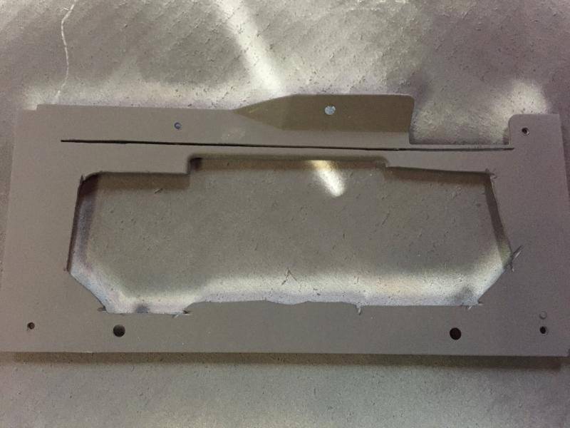

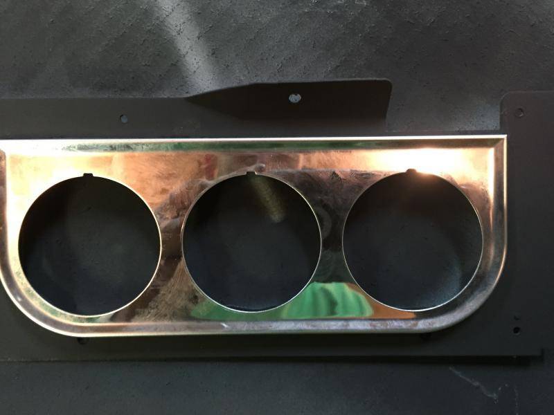

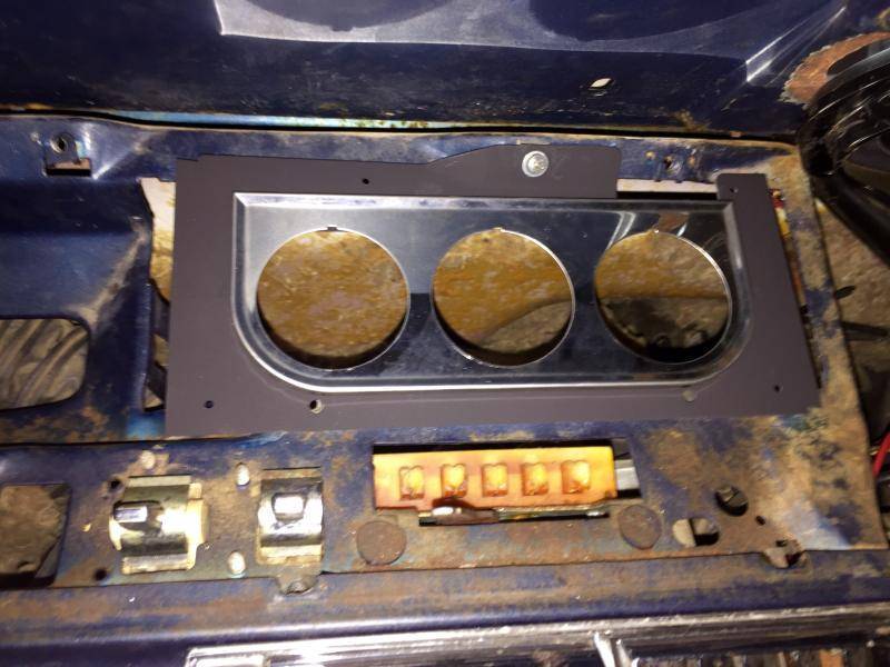

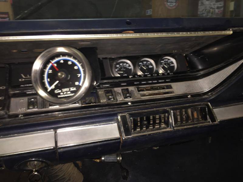

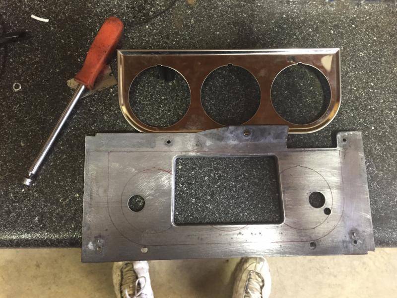

Not at all. I cut a slot in a factory radio mounting plate that the gauge brackets 90 degree bend slides into. Then cut the center of radio mounting plate out to accommodate the gauges. The whole reason I came up with this is because I didn't want drill into the dash for gauge bracket.You are cutting the dash?
