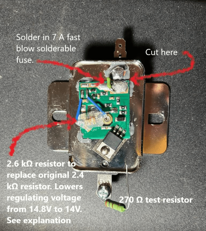

Many replacement regulators for the old point type are electronic. I bought one from NAPA years back. Just look at the back. No coils, it's electronic.

Yes, I think that the presence of 2 wire-wound resistors on the bottom of the regular indicates that it's electro-mechanical type, not electronic. Rock Auto regulators all seem to be electro-mechanical.
But I think this one on ebay is electronic:
https:// www. ebay. com/itm/373542320625
Could very well be the same as what Summit is selling as P/N TFF-7524 (with Tuff Stuff label) for a few bucks less. And I'm fairly certain that the original regulators did have IGN and FLD in raised letters on the case.
