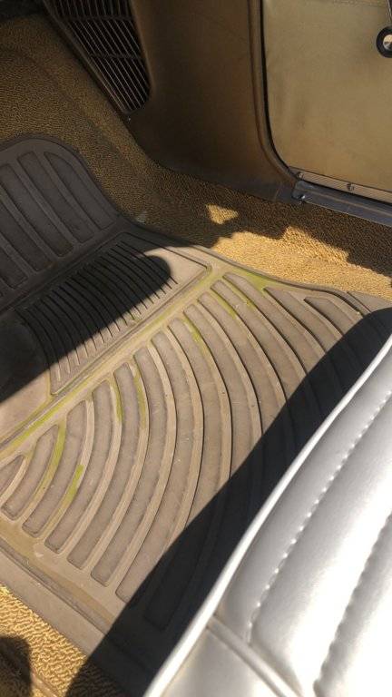

Well guys, after 51 years my heater core has decided to start leaking since I got the rest of the coolant leaks fixed. How bad of a job is it, and what kind of core do you recommend I get? I've seen aluminum and copper units both available.
