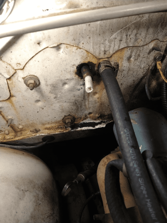

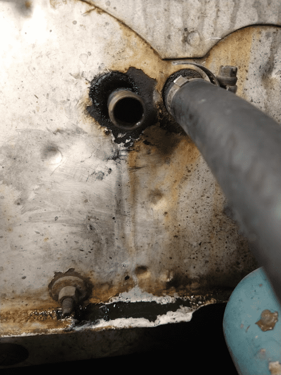

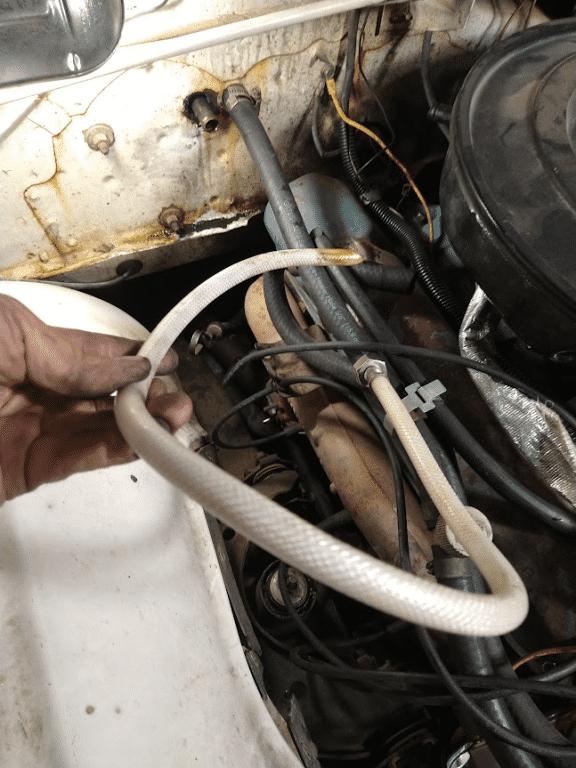

May have found The Leak this evening folks! Seems that stress slightly cracked one of the bronze teats coming through the firewall, so I slipped some slightly smaller braided hose through the teat a few inches, shoved back the old foam around it to allow my new heater hose to get IN past the sheetmetal a couple mm, then double hose clamped the heater hose once as near firewall as I could, and once to gently squeeze the heater hose around the braided hose sleeve I ran in to bypass that crack. This constricts coolant flow a little through the heater, but at least it works, and I smelled NO hot glycol after running Gertrude up to temperature and watching for moisture. I'll try to post a few pics I took tomorrow, but I gotta get horizontal for now.
Good News! For the Mopar Morris Family of Tucson this morning. The Dreaded "Heater Core Leak of TurkeyDay 2022" vanished under testing. Yestereve's cure for the small crack in the firewall nipple holds nicely, while yet permitting sufficient hot coolant flow to comfort my harem* in early morning chill.
Leak stains on firewall. I had poked back and tore out the rotten foam rubber around the nipple. Braided flexible waterline, 1/2" O.D..
Feed in ~ 6" of waterline to bypass the little crack. No more leak and the heater core gets plenty hot coolant still for its job. One of These Daze, I WILL need to remove the heater box, and do all the good **** we've discussed on this thread. For this, I heartily thank Ye Wise Moparians.
