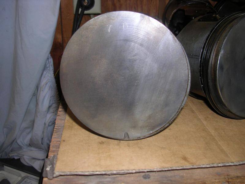

For a 1969 440 that I am disassembling in prep for a basic rebuild: rings, bearings, gaskets, valve job, cam, lifters, timing chain: I found that the cylinders are stock bore diameter at 4.32". I found that the pistons have 7 D stamped on the top of the piston head. F is cast into one side of the piston pin area and other symbols are cast on the other side (these symbols seem to vary). Piston rings look almost new. Rods are press fit onto the pins. The rod bearings have no markings. Piston deck height is .045-.050" as measured with a dial caliper.
Based solely on the cast F, I am guessing that the pistons are Federal Mogul replacements that were used to up the compression in a C-body non HP motor. I suspect from the few documents that came with the car that the last engine rebuild was done around 1995-2005. Does anyone recognize these pistons?

I think those are stock pistons I have a set of stock 70 pistons loose and will take a pic when I get out to shop today.
Yah your deck height measurement made sense after I posted that:busted:
I believe that is a stock Chrysler piston, not aftermarket.
Deck height is about right for a 69 that hasn't had the decks cut. Spec is actually .027" (IIRC) and we always hit about .030-.035" with the NHRA legal stock engines after decking the blocks. BTW, they used the same pistons in all the engines in 1969. The HP engines had the same compression as the regular engines so the deck height is the same.
The markings on the top are for size at the assembly line. Pistons are measured and stamped and then matched to block bore sizes. I can't even begin to tell you what the number corresponds to.

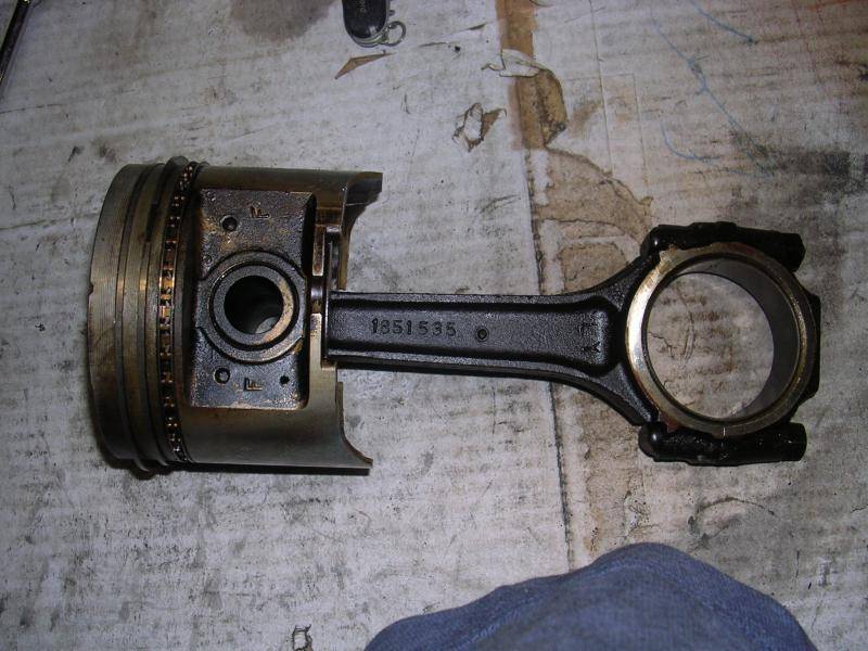

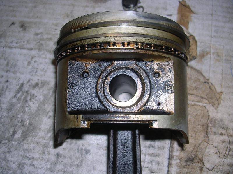

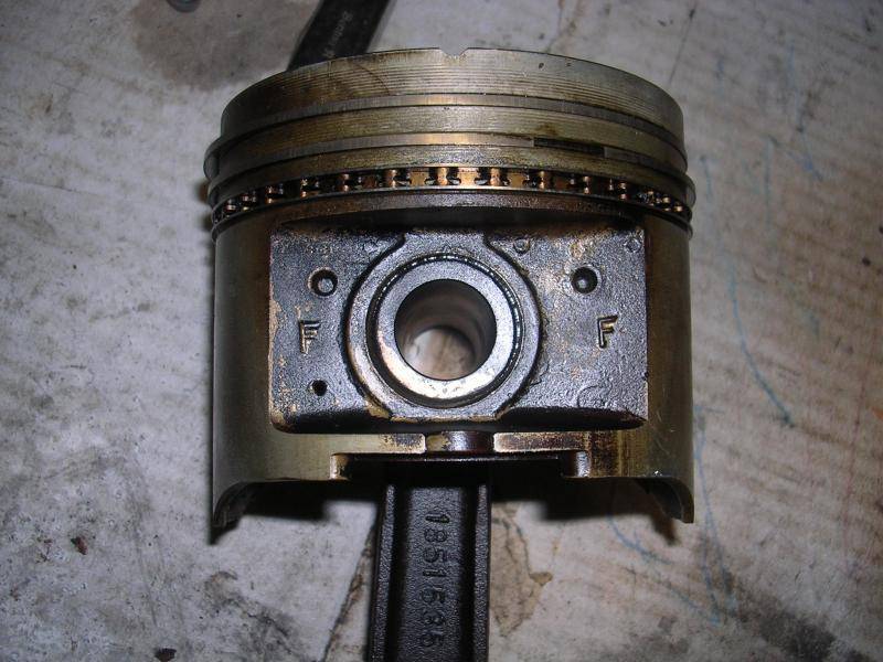

I just so happen to still have an ash tray on my bench.... Stock Mopar piston removed from an engine 30+ years ago.
Ah, the cryptic F on the side of the piston. So they're original Mopar with rings and bearings replaced. At least my pistons are in better condition than your ash tray.

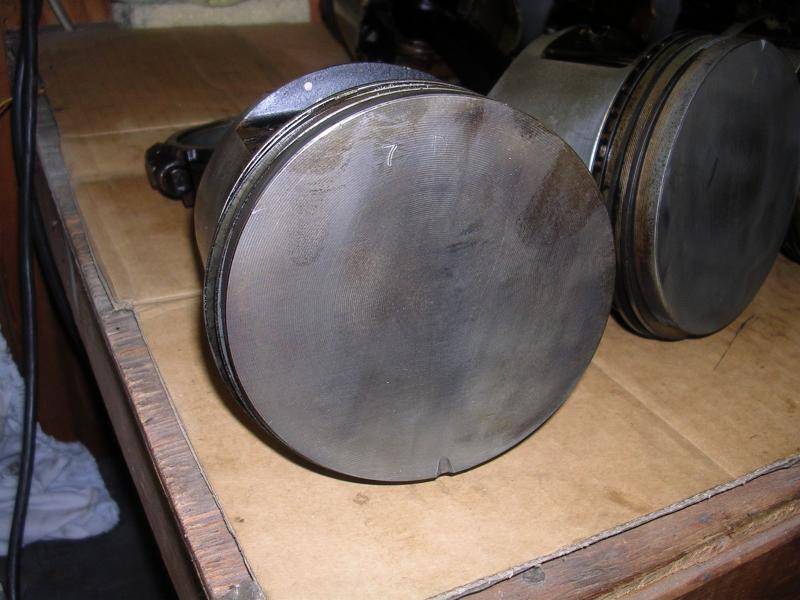

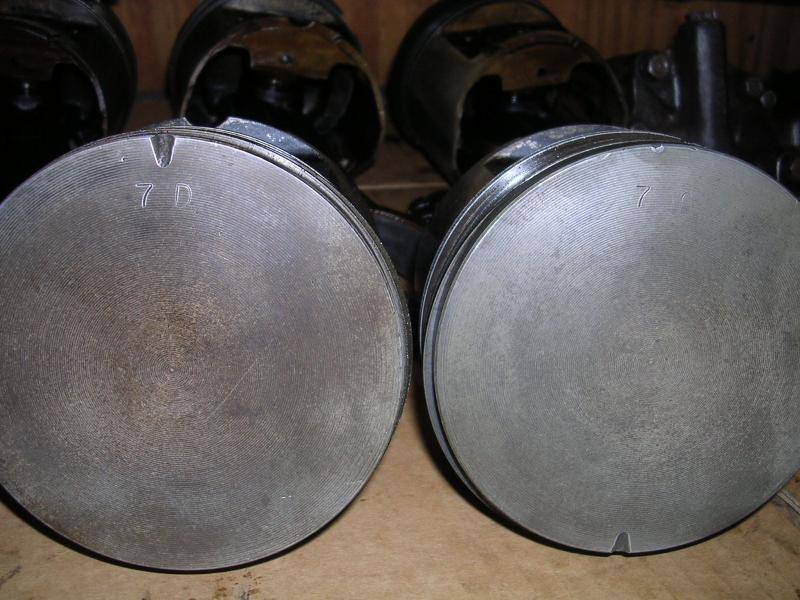

I finished cleaning the piston heads: Piston Head Markings: Pistons 1,3,5,2 stamped 7 D on top of head. Pistons 4,6,8,7 stamped 7 C on top of head. You & 70BigBlockDodge are right, original pistons and 7 D cannot be the part number. Pistons 5 and 7 pictured. It's interesting that sometimes the stamping is at the forward mark and sometimes 180 degrees away.

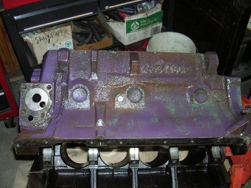

Thanks for the info about the same pistons in all 69 blocks. I took deck height measurements at the low point and high point of two different cylinders, #3 & #6. In coming up with .045-.050", maybe my measurements were just 1/100" off. Oh well, now I get to go back to the fun of block cleaning. I used POR 15 engine cleaner to take the grease off. Time for 3M Safest Stripper to at least rough up the old paint.
