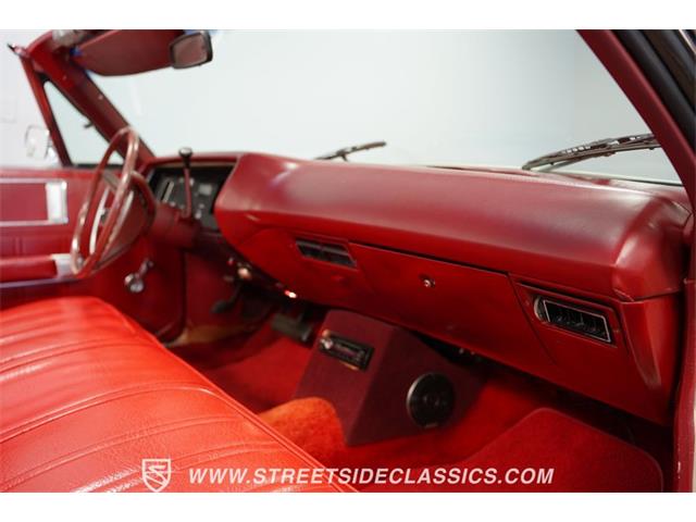

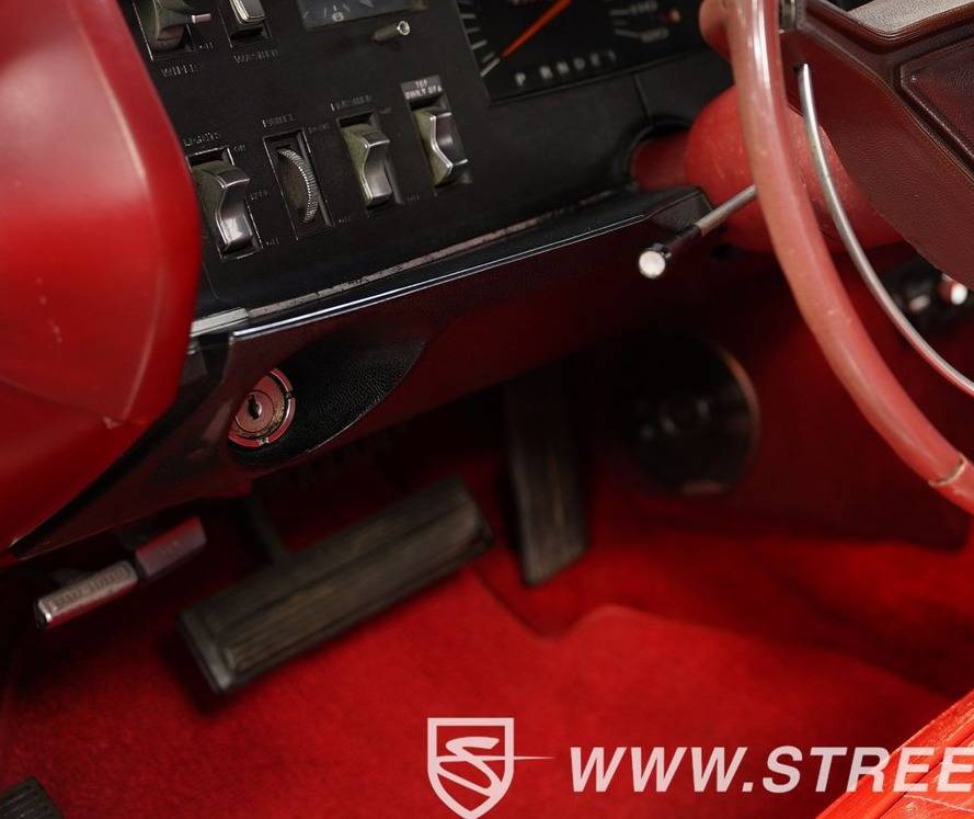

And what's up with the dash? (interior color doesn't match too).

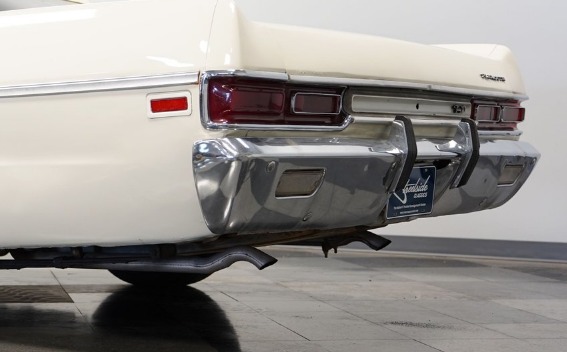

At least the tailpipes seem to be correct.

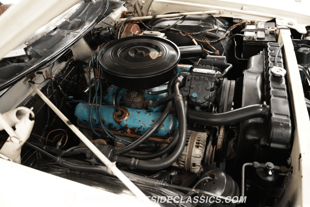

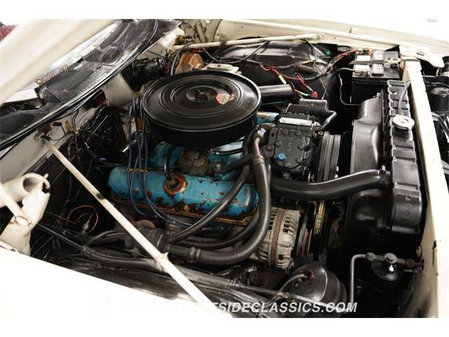

The factory cowl screen is missing, and has been replaced with expanded metal gutter guard held in place with lath screws (through the stainless windshield molding, too!).
(To add to the list)
Needs too much work for $20k....
I'll bet they pressure washed the engine compartment too, before carpet bombing it with tire foam....humph.
Believe it or not the metal screen is factory, the early 69s had it. Not sure when they went to the plastic but my 500 (a Dec build) had it as did the other Polara I had (not the CHP car).
It is stamped and formed to much the same shape as the plastic one.

Dang, did not know that, thanks.....did the factory at least tuck it under the lower windshield molding?

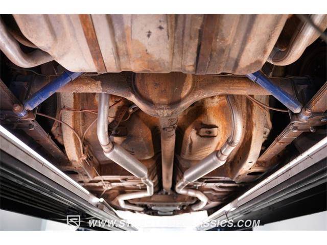

1969 Plymouth Fury Streetside Classics Y-Pipe2.www.streetsideclassics.com.jpg
WTF? Geeez... They cut the Y-pipe??? Heck when I had some slack time and the dim bulb in my head went off to dual exhaust my 1968 Plymouth Fury III 318 with the extra exhaust parts lying around the shop, I just torched a hole in the drivers side of the Y-pipe and grafted on the left side. Wooo Hey I even had the high pree'for'mance H-Pipe cross over built in (to compensate for the odd ball non matching mufflers).
:lol:
The missing transmission shield is par for the course so we won't go there other than if you ever bend one and it's going rat-A-tat as it's a very close fit to the flexplate bolts. Don't waste your time trying to straighten it out, I had to do one like four times R&R, just pitch the mud'rfucker and put in a straight one.
Not easy to do/find these days I'll bet. Maybe that's why it's missing? ha ha...
Yeah Stan, battery hold down purchase via the 'net these daze can be risky, I was going to go with a universal Pep Boys one but couldn't find a appropriate image as anything is better than a old used (?) shipping strap.
I don't even know if that one is correct for a 1969 but as Chrysler was pretty universal on parts cross models I'll bet it's the same. Heck I even had a 1968 Monaco LF fender on that '68 Fury after some stupid foolishness with a immovable object to hold some headlights, boy did I get some stupid comments 'bout that until I found a suitable replacement (cheep/free factor).
:lol:

That y-pipe is just like what I did in high school when I converted mine to dual exhaust using a donor car.
:lol:

Oh, another thing...those incorrect rear view mirrors gotta go.
