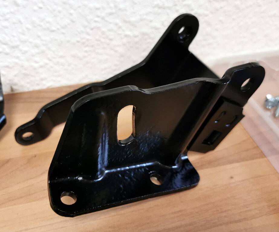

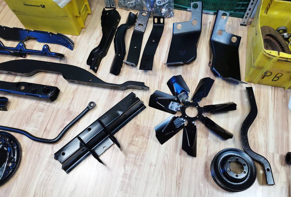

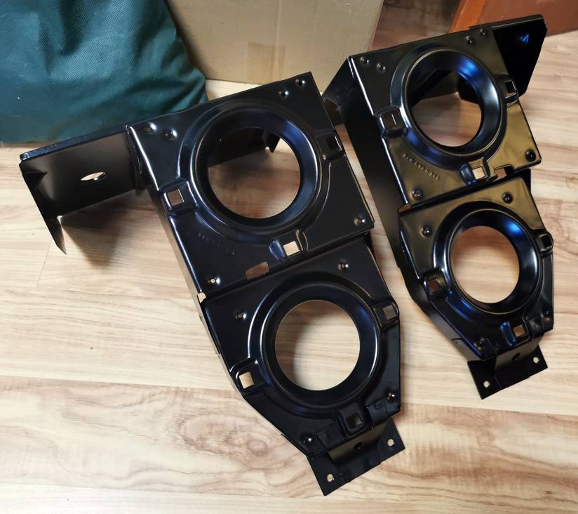

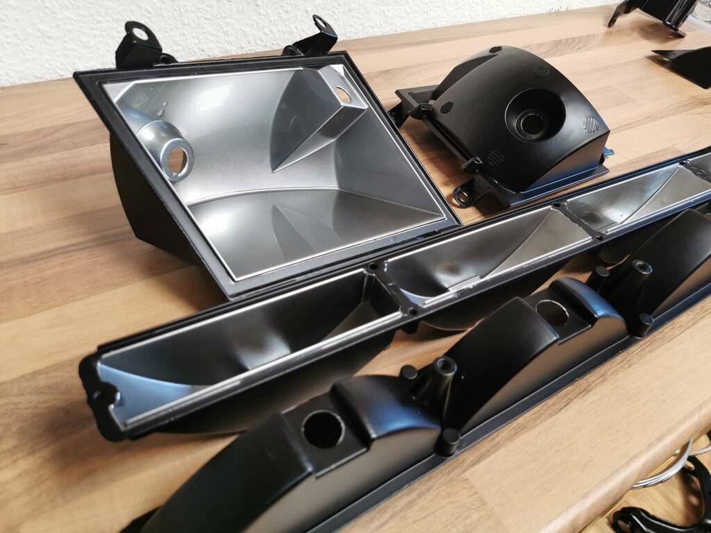

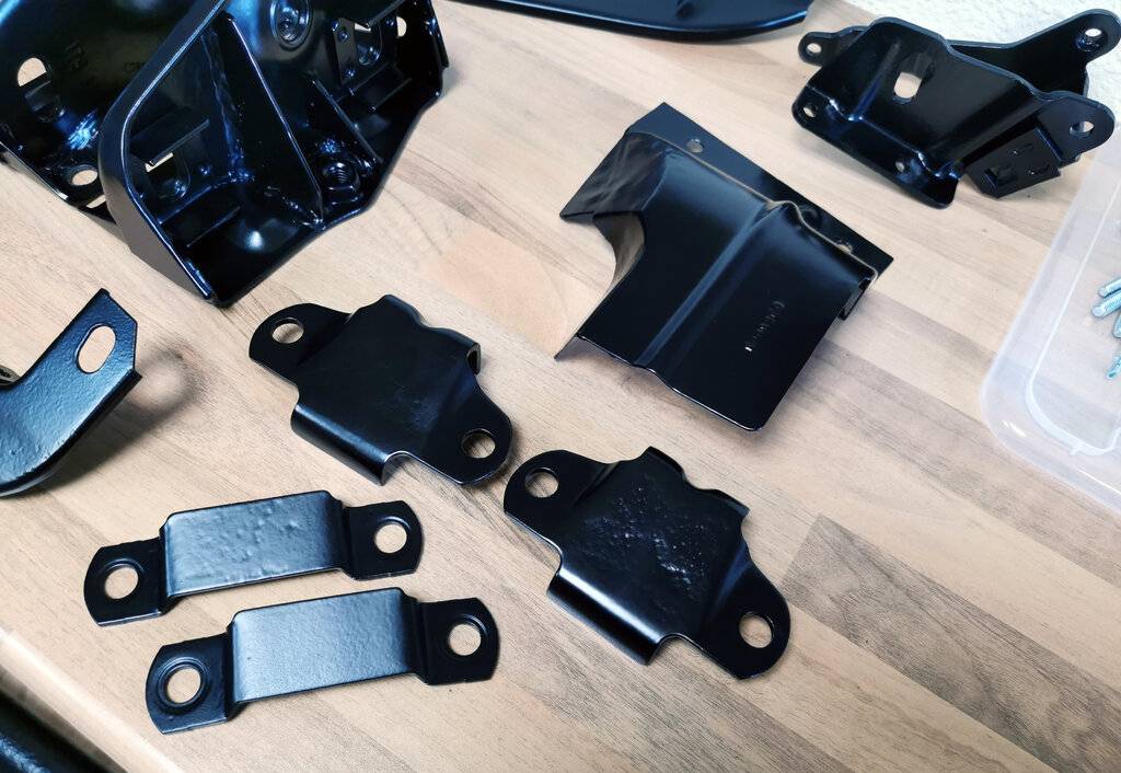

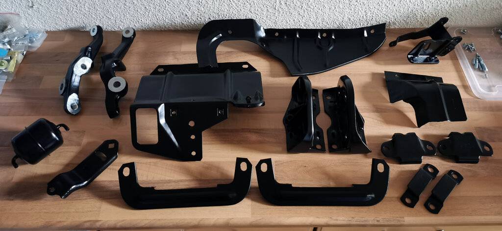

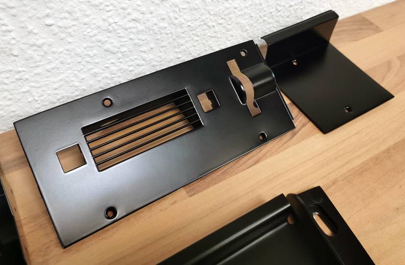

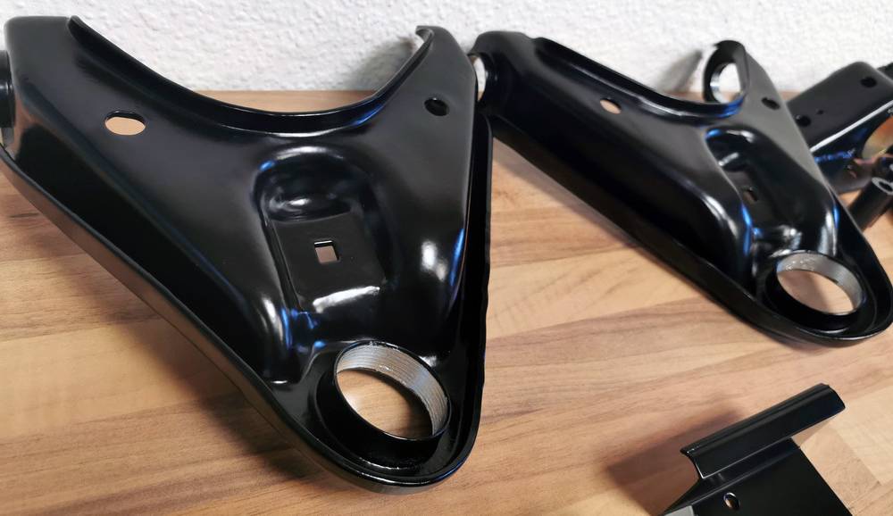

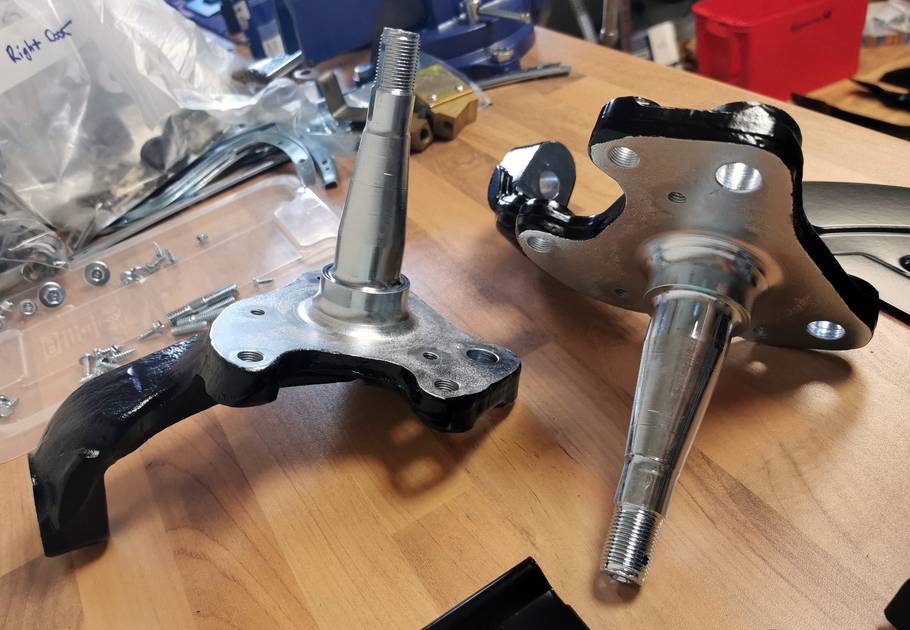

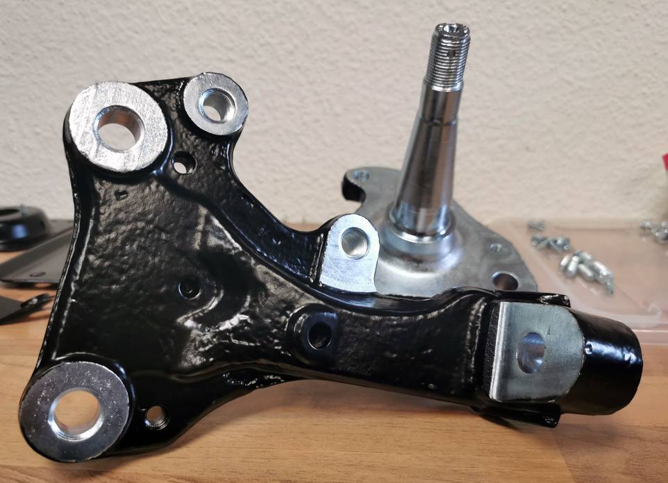

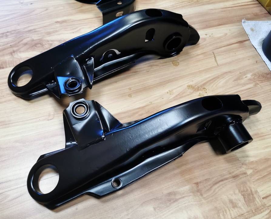

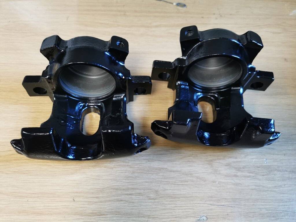

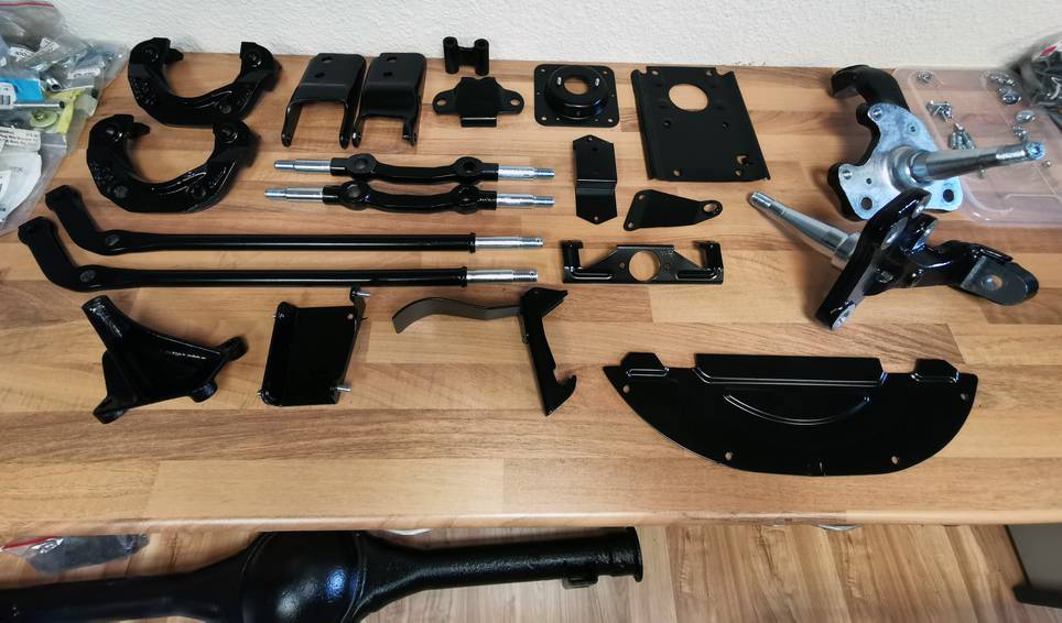

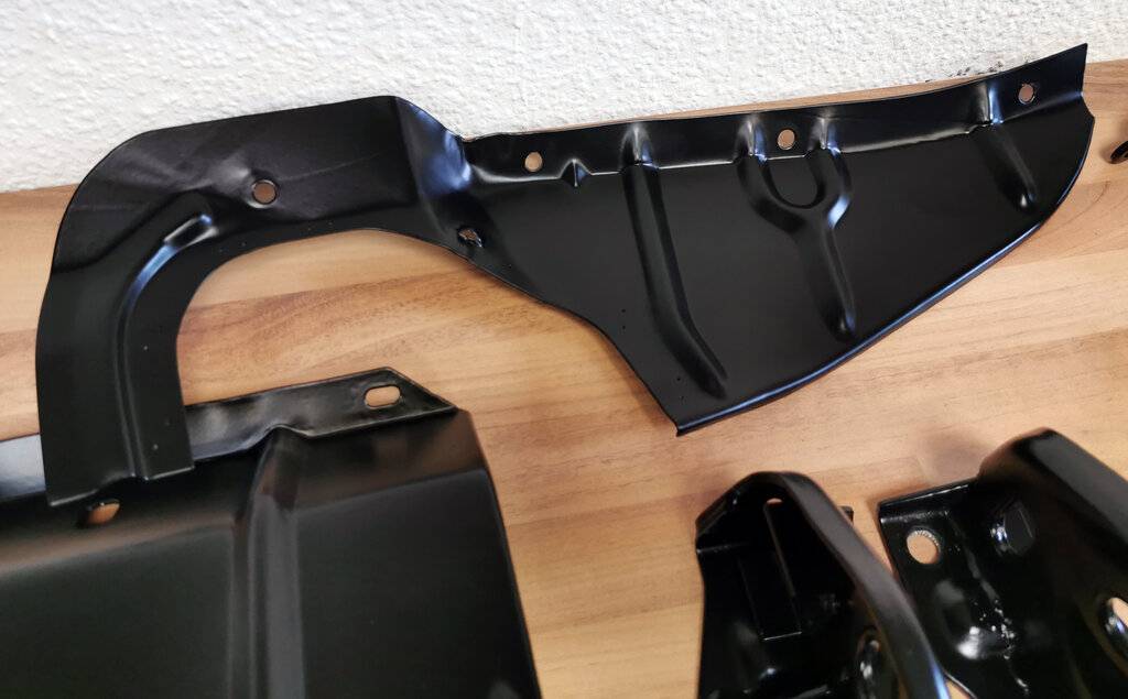

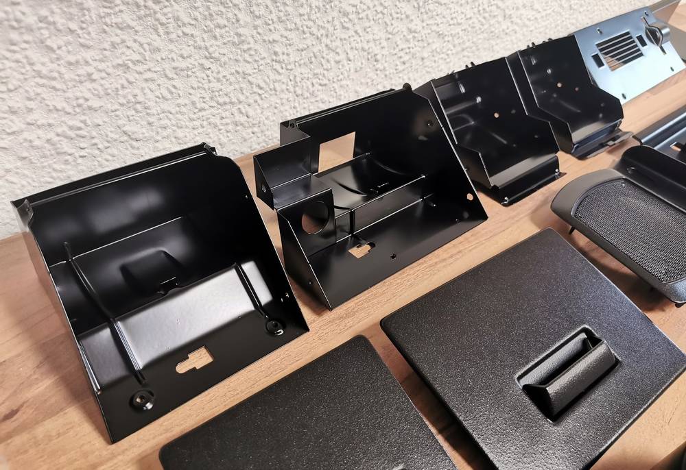

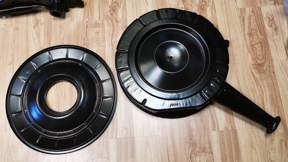

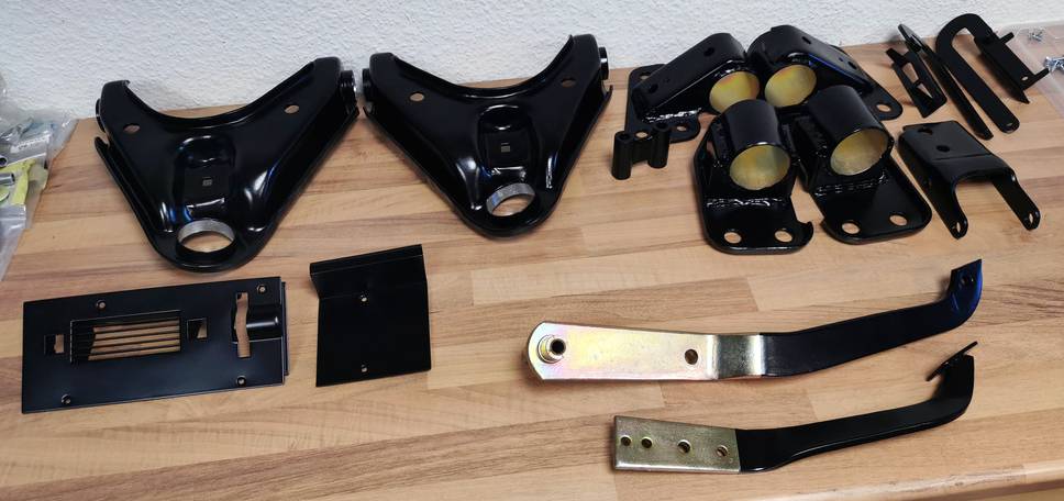

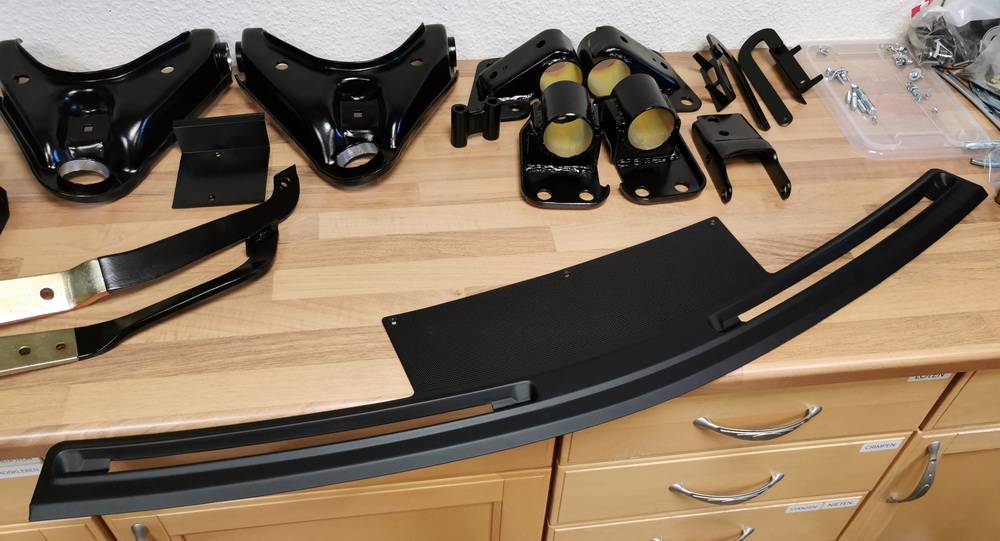

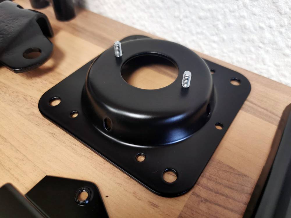

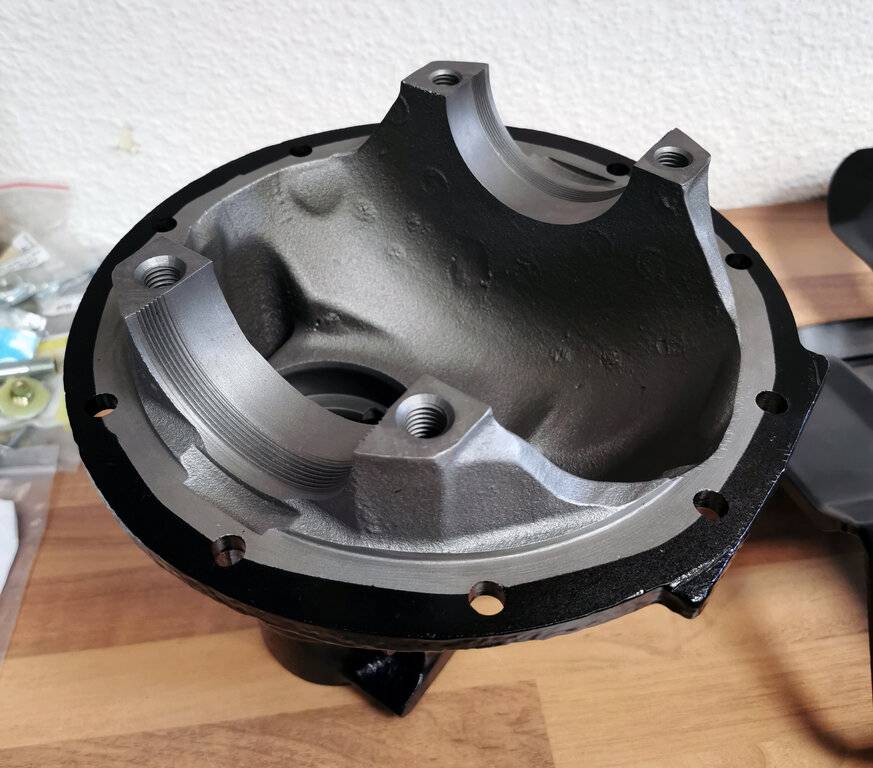

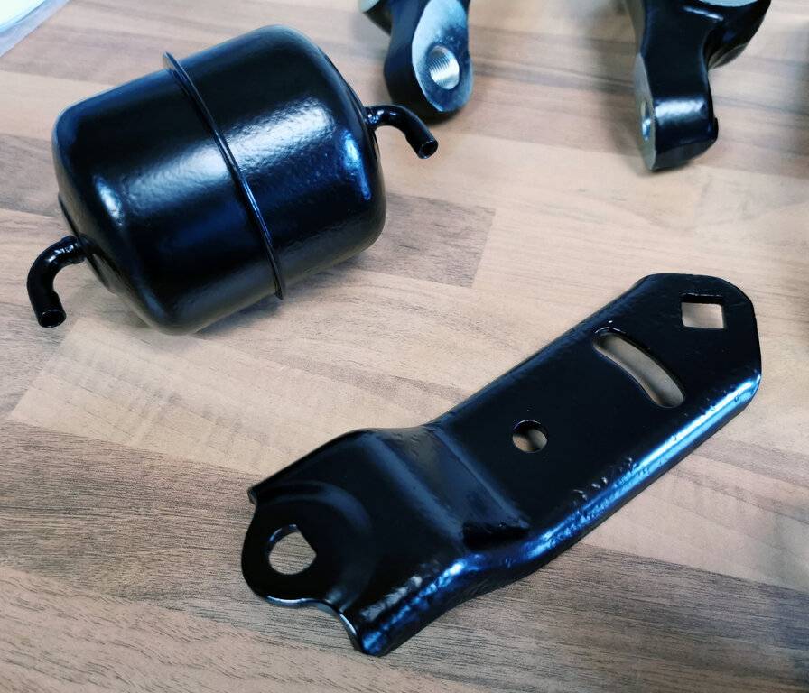

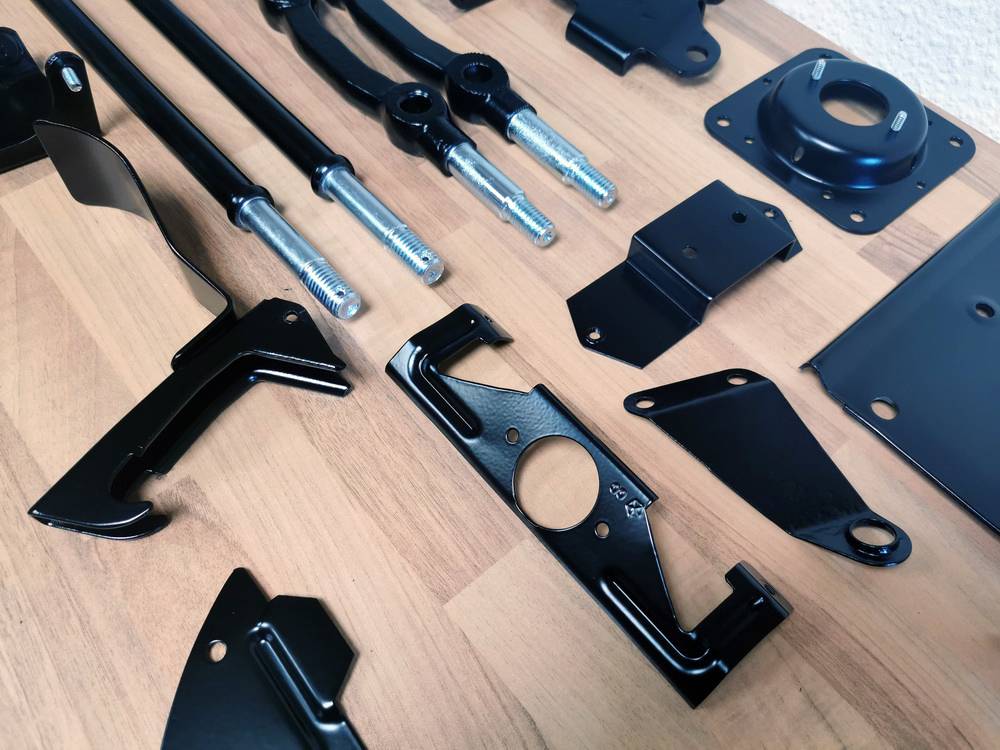

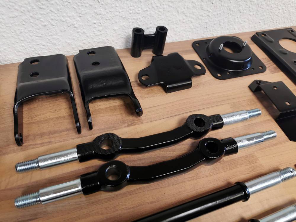

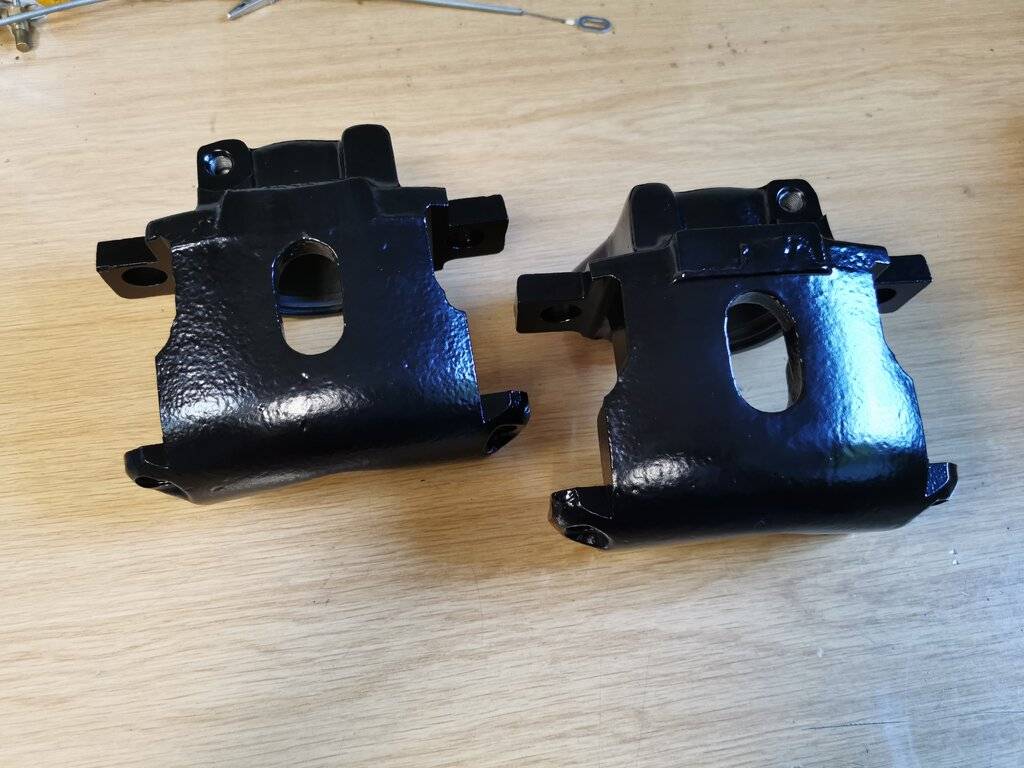

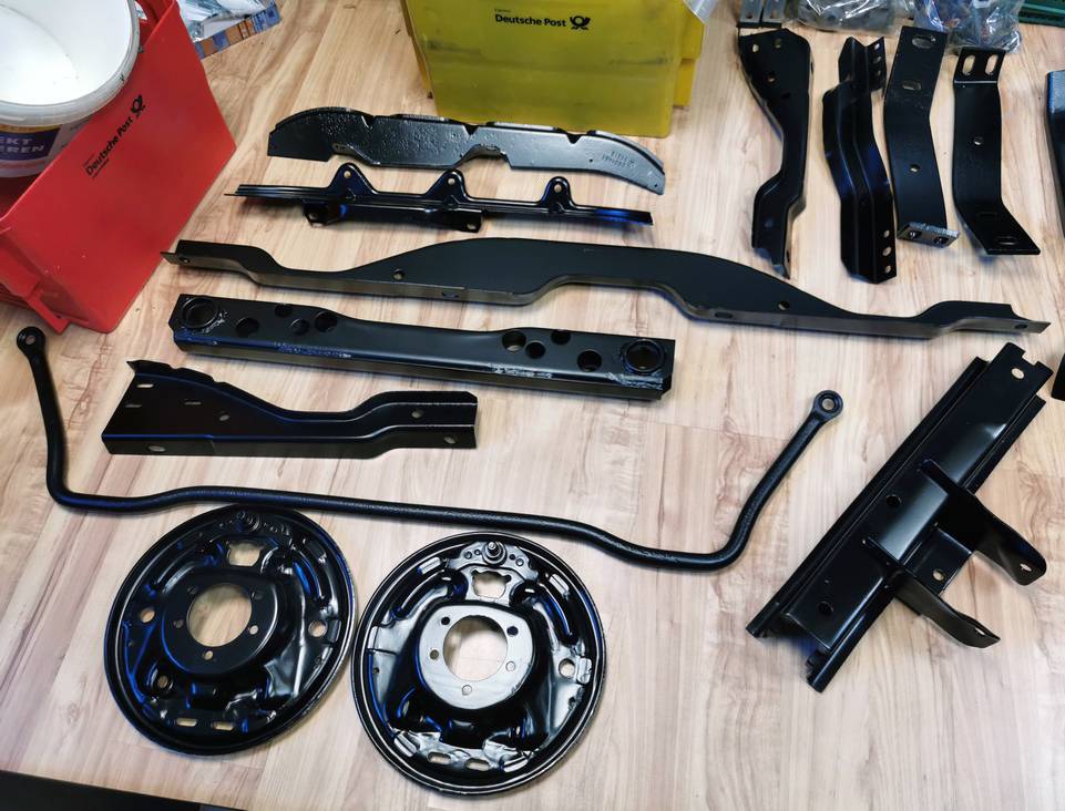

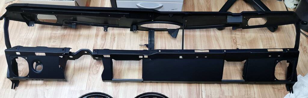

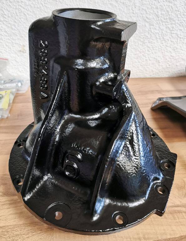

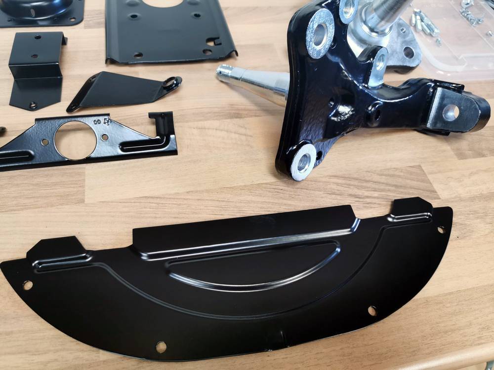

Another load of parts is back from painting. :) I'm really happy with how it came out!

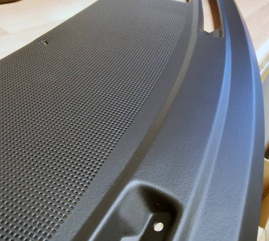

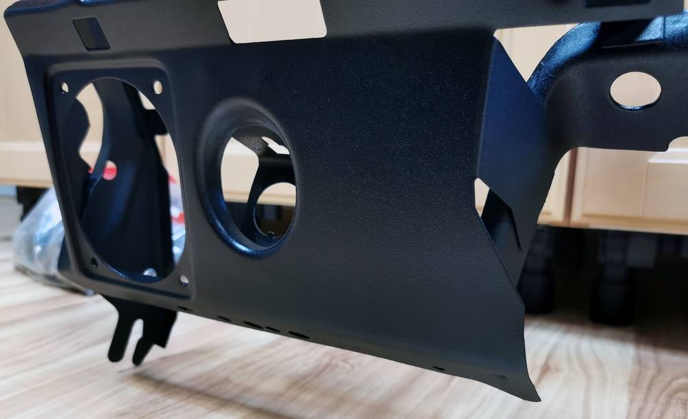

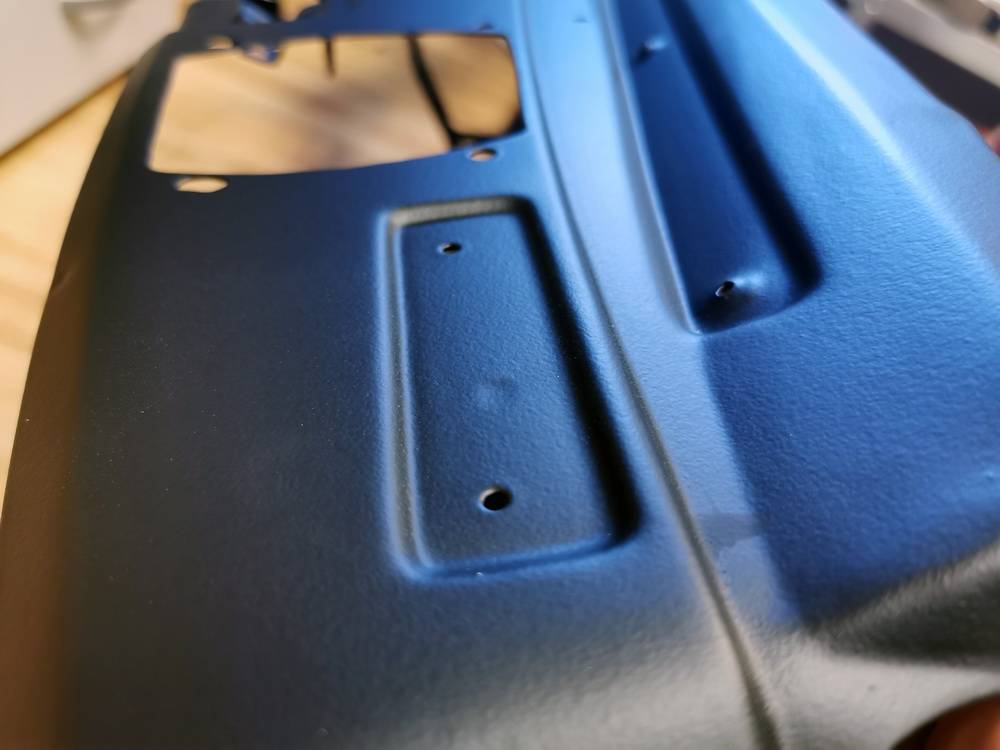

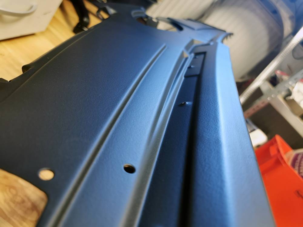

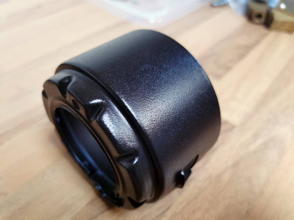

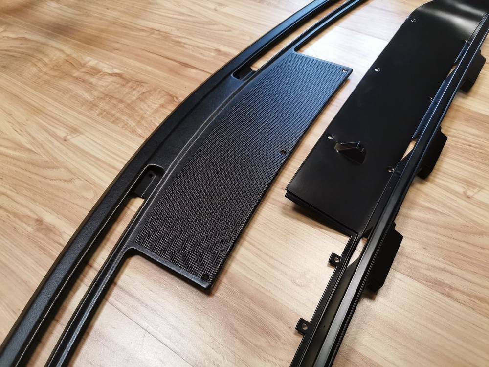

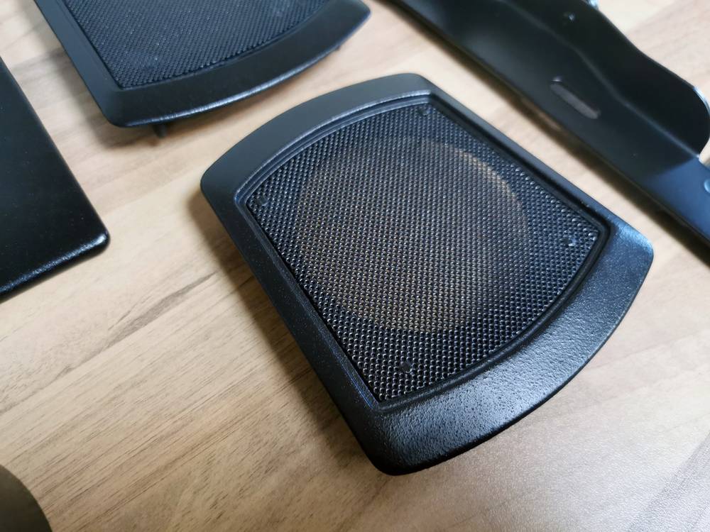

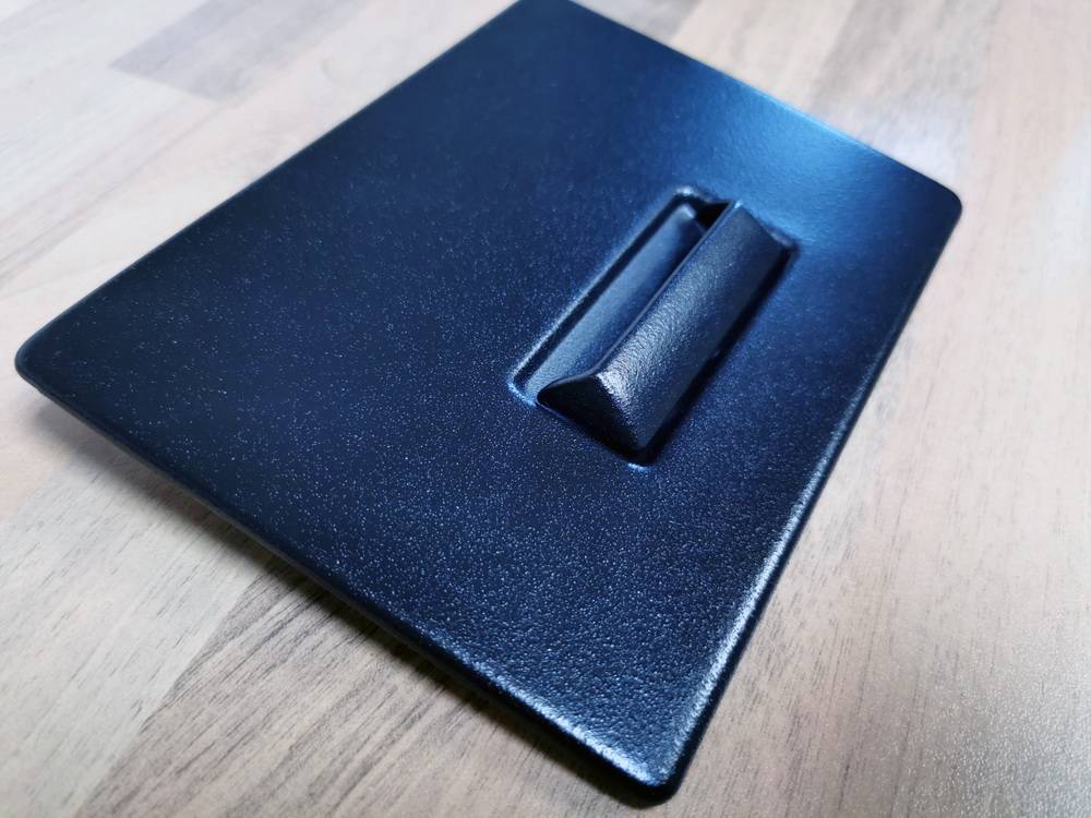

To find the right texture for the dashparts was not that easy. First attempt was just a smooth, matte finish. But that was just not right. The second attempt was a special "textured paint", but that was waaaaay to "gritty".
He sanded away the grit particles leaving the rough texture of this paint and coated it again with a matte clear and it came out exactly how I wanted it. I think it looks perfect!

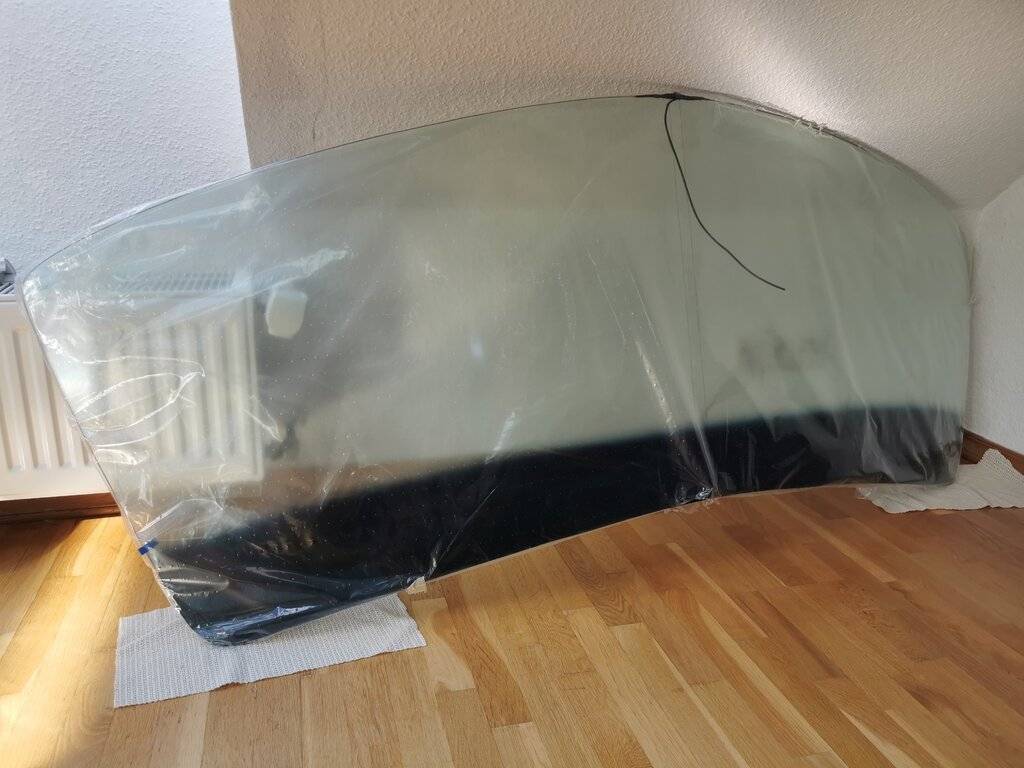

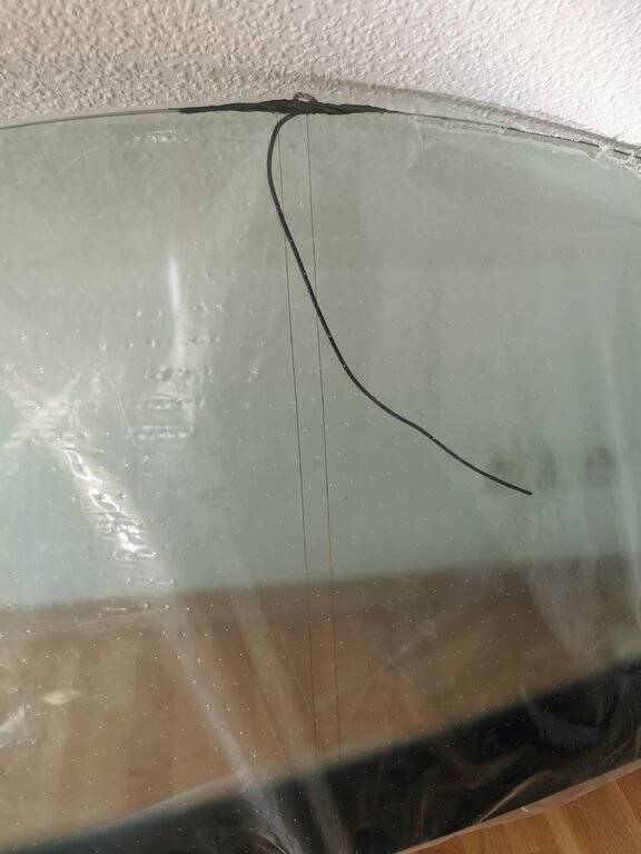

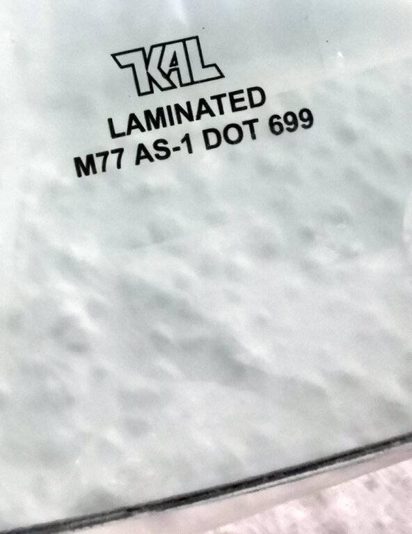

And here it is, the brand new Windshield. Fresh from the mold :D
Green tint, blue wedge and with integrated antenna like in the 70 Imperial. Bye bye ugly rod Antenna.
I don't wanna know what you paid for this haha. The windshield on my 70 is cracked and I'll need a new one eventually.
For a brand new windshield for a car over 50 years old made to your likings, 835€ ($990) is not too bad. It's made in Finland tho. I was told the company there bought all the original molds from the factorys.

Yes, it's from Kuttilan.
Obviously, they haven't bought the molds from Chrysler itself. ;)
But I was told they bought the original molds from the Original Equipment Manufacturer.
How true that is, I don't know. But in the end it doesn't matter, as long as it fits perfectly. :)

It will fit perfectly! They have made quite a few of those and fitment has not ever been a problem.
The prices are somewhere from 300€ up, depending what options you want in it. Shading, tint and especially the antenna makes the price go lot higher.
As it has with yours..:wideyed:
But not bad price for this kind of item!:thumbsup:
I can tell you exactly:
495€ for the windshiel, tinted green with blue wedge.
80€ for the antenna
145€ for personal delivery
115€ taxes
835€
