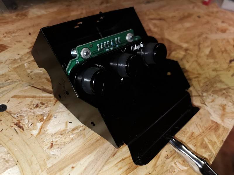

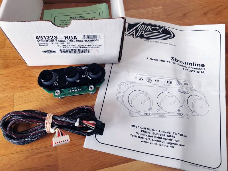

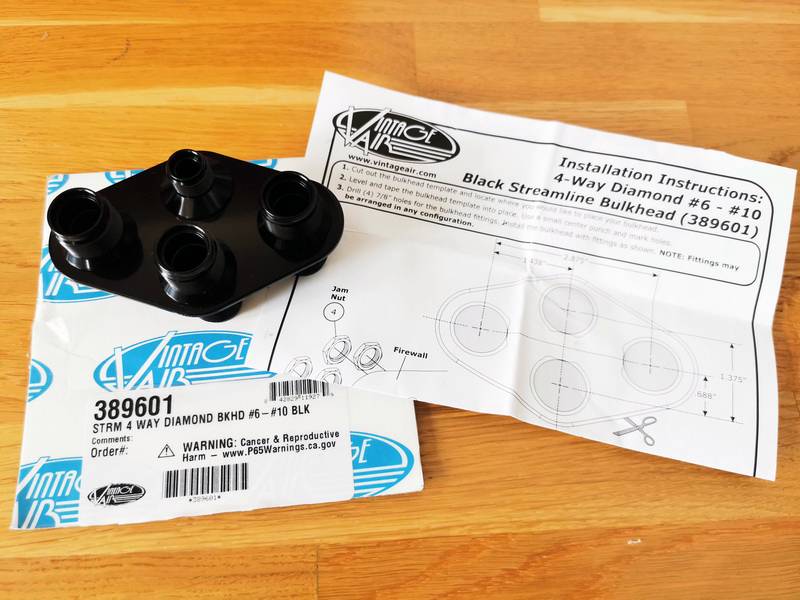

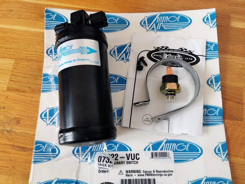

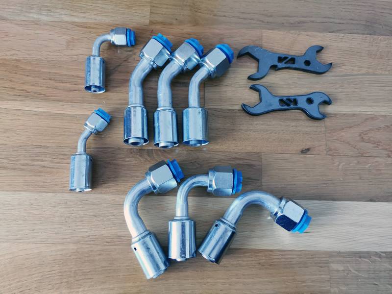

And another huge package arrived from VintageAir with all new parts:
HVAC Box with all the accessories, the Control Panel, hose Bulkhead fittings, drier and so on...

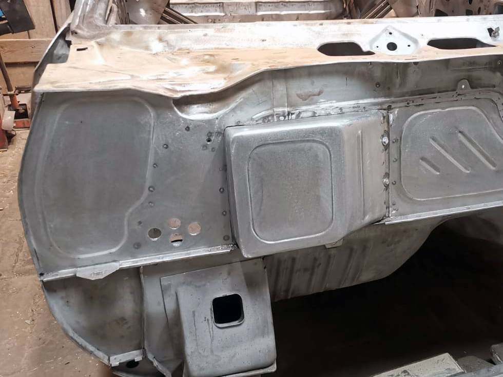

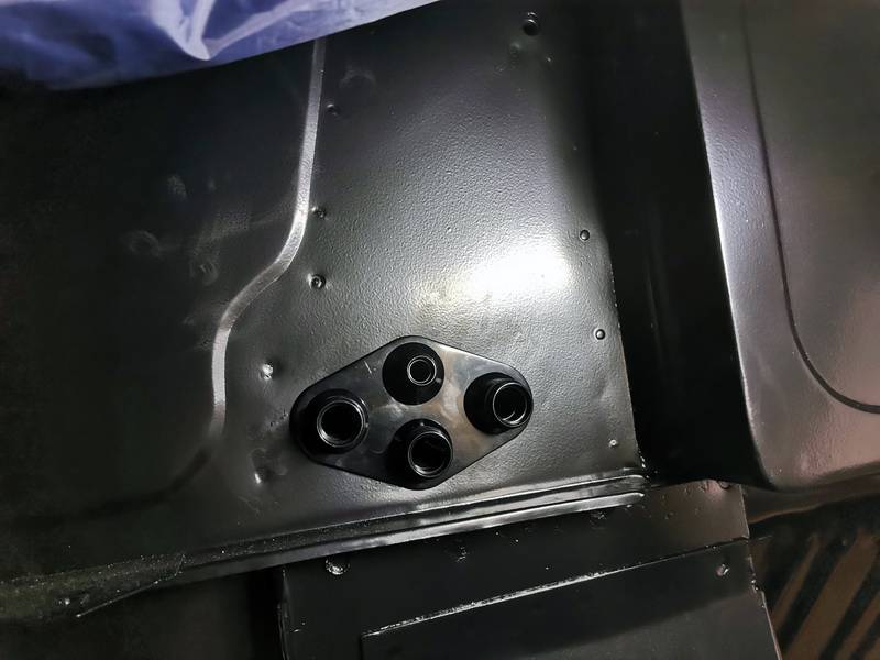

My Bodyman already drilled the holes for the bulkhead before the body went into the CDC bath. I checked the fitment and it's perfect!
Ireally like the clean look! :)

Next project is to integrate the HVAC controls onto the center ashtray. The general fitment is ok, I think I will make that work, but I still have to make major changes to the ashtray and the control panel because the circuit board is much bigger then the bezel itself.

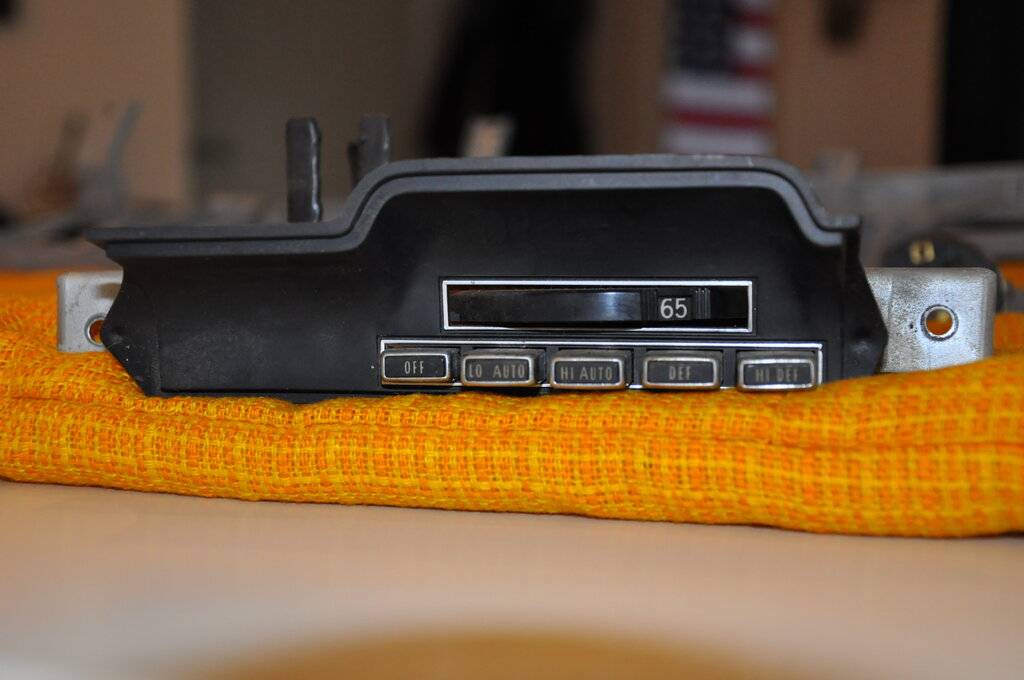

Will somebody post a sharp, clear picture of the stock controls for me?

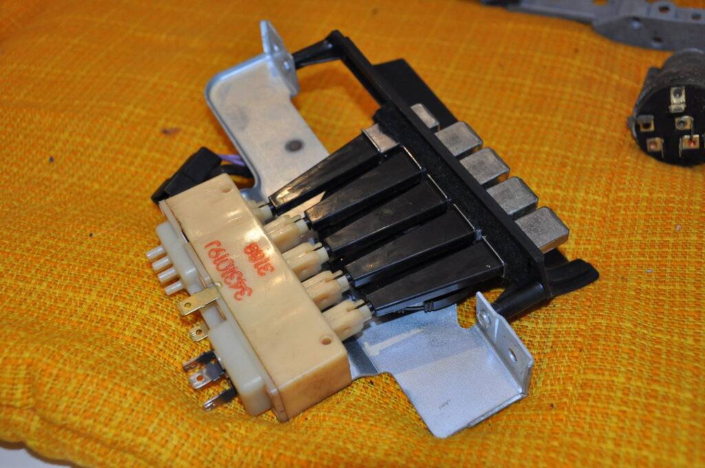

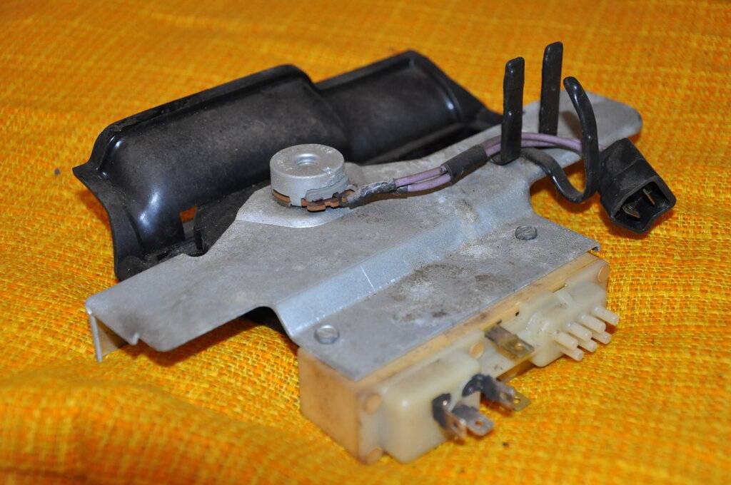

I looked into doing that but all the vintage air controls are electronically operated and not adaptable to the OEM vacuum switch. I saw no way to do it anyway.
There is always a way. I don’t know the new control circuit but people have inserted all kinds of controls into old radios...
Sure, there is always a way, but I'm not a studied electro technician and don't know how to do it :(

I wonder if it would be easier/possible to adapt the OEM manual control rather than the dreaded Auto Temp?

Honestly, I like the ashtray idea as plan B since I couldn't figure out a way to use the OEM controls.
Vintage Air doesn't offer any push button controls I could use. So I would havbe to build something that converts the push button signals to a poti value. And I don't even know where to start on that. :(

The manual control A/C was not available on Imperial, but it was on Chrysler and since they use the same instrument panel, a manual control would fit directly. I don't think it would be too hard to find one. It's a matter of adapting it. That's where somebody else would have to chime in. (Since I can't get Auto Temp to work in my '69, I'm thinking of trying to try a manual control myself.)
Chrysler and Imperial does not have the same A/C dash bezel! So unfortunately a chrysler unit would not work.
