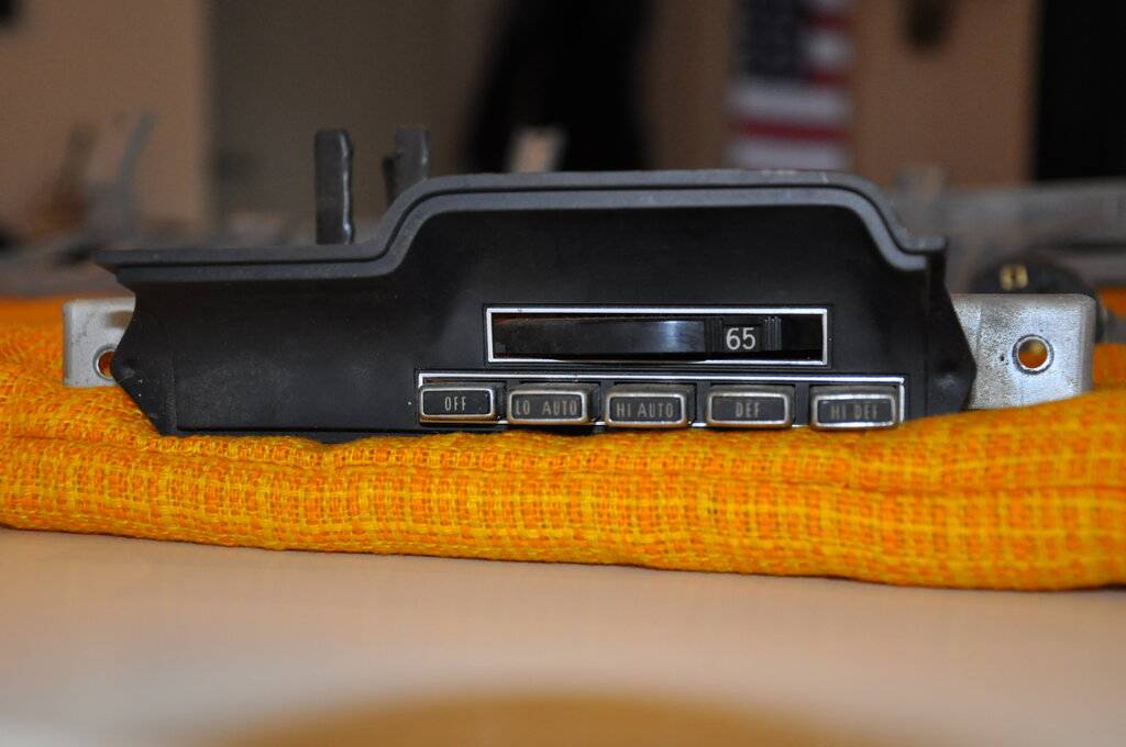

True for 1969, but in 1970 and 1971 you could also order a manual A/C.The manual control A/C was not available on Imperial

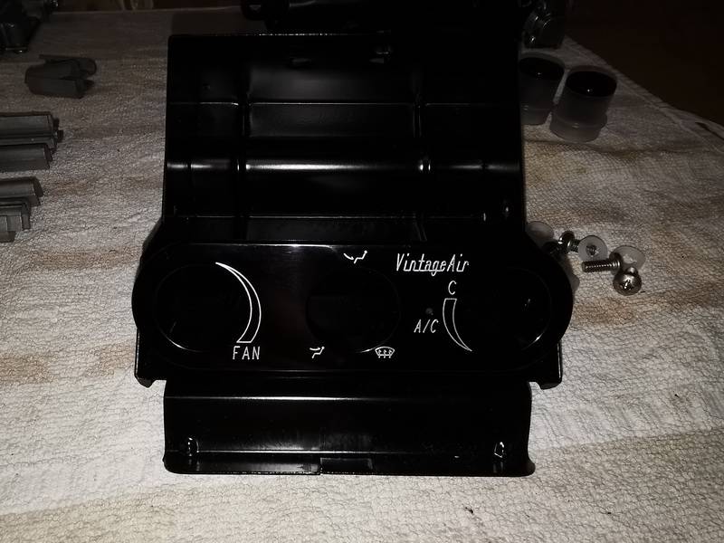

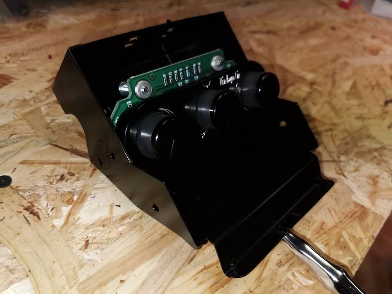

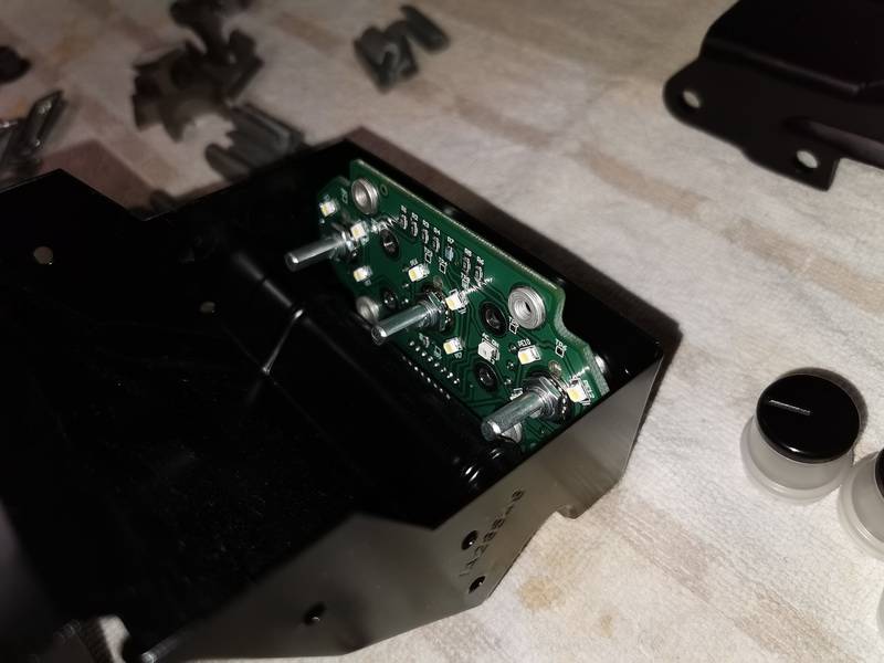

Just to be clear. The photo of the ashtray with the controls was just a fitment test. It's not going to look that exposed when I'm done!Just spit balling here... But I think it can be done without that much drama.
The unit looks fairly compact. It does fit in the ash tray, so it can't be too big.
The front panel looks about the same size. I would cut this out and make a panel for the knobs.
This control would mount here. The shafts could easily be extended to meet the new front panel.
The only visible thing will be the knobs, but hidden in the ashtray!

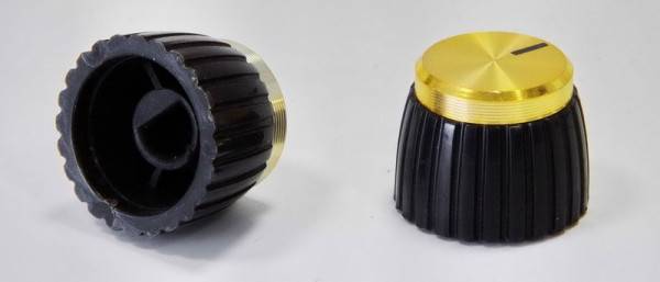

I'm sure, I could fit the knobs into the original bezel, but I don't want the modern knobs to be seen in the car. They would look out of place.

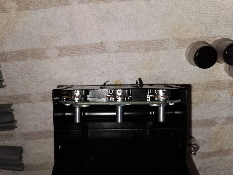

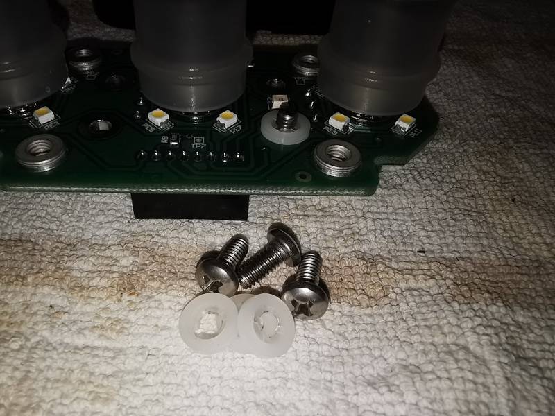

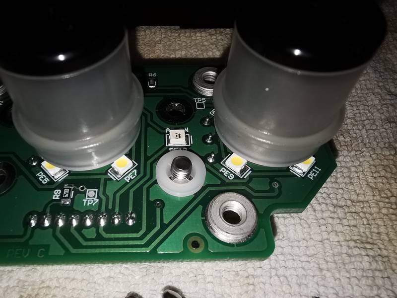

I thought about desoldering the potis from the cirsuit board for the ashtray too, but the LEDs on it are SMD and not relocatable.
