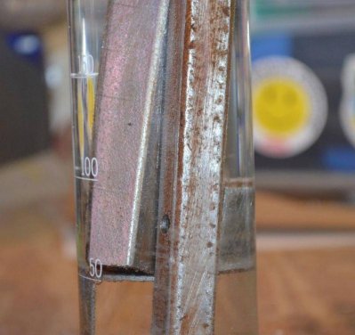

I'm working on something unrelated to my car, and I needed to get some rust off. I don't know if you have soaked anything in vinegar yet (I don't really feel like going back through the thread to find out), but here it is. Note the bubbles. That's the acid reacting.
I'll go back tomorrow, and the rust will be gone, and I'll weld them up.

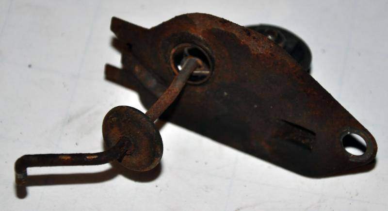

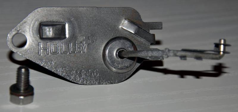

Looks good! I soaked my carb in vinegar for 3 days and it came out pretty good, too! If it would just not be that smelly! ;) I also made awesome results with Metal Rescue. It acts and smell like water and is very fast.
This was in Metal Rescue for ~6h. (It came out dull, so I had to polish it)
View attachment 37791 View attachment 37790
That looks great, I will have to get some and try it
