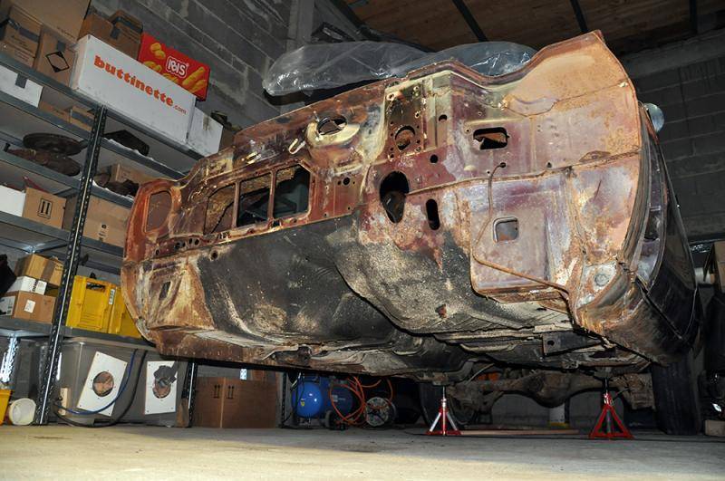

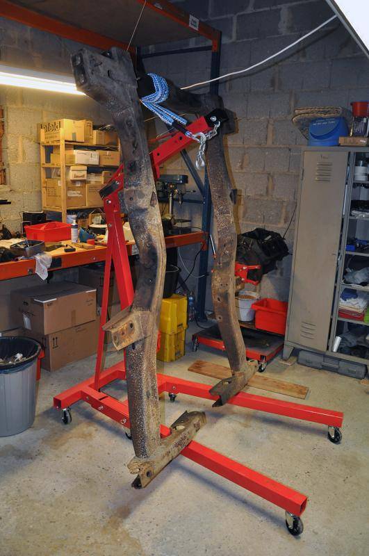

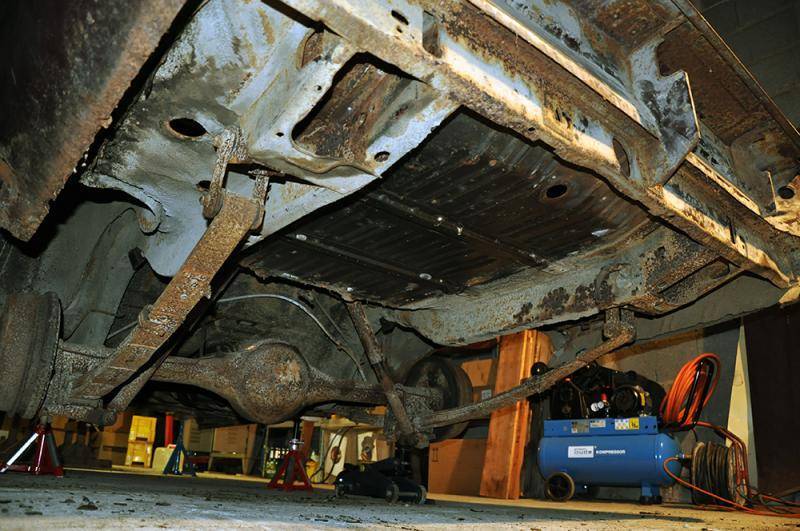

And today, I removed the torsion bars and the k-member. I've read a lot about problems removing the torsion bars lately, but mine came out pretty easy by hand!

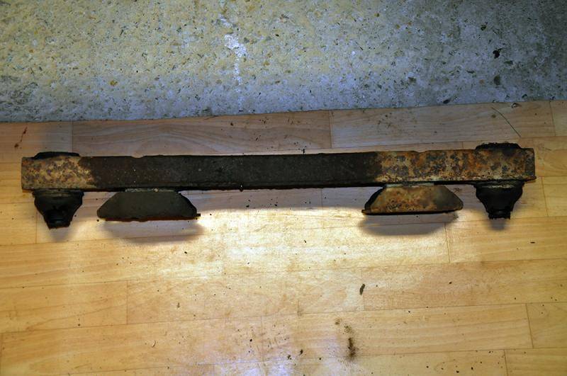

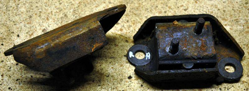

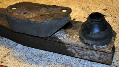

Is this the subframe that the torsion bars mount to, and are the inboard pucks the rubber isolators? If yes and yes, there is a rebuilder here in the US that I used for mine.
I was wondering what you've been up to. Nice to see you back at it.
Yes and Yes ;) The torsion bars are mounted to this bracket, and the bracket is mounted to the rear of the Stubframe (rear transmission mount bracket). The pucks are the rubber isolators!
Is this rebuilder selling the parts also?

It's the time of the year when I'm on one fair after the other for work. Not much time for anything... But I'm still using every available hour besides my social life for the Imp!
I'm going to try and do my isolators this winter if I can find the time. I've already been in touch with the vulcanizer.
Keep us in touch about the vulcanizer and the isolators please! The rubber on my isolators looks pretty good, but it's nevertheless a good idea to renew them when everything is apart!
Unless you're having some issues with your budget, I'd do it while the car is apart. The rebuilder (name escapes me at the moment, but it's in my thread) doesn't sell new ones, only rebuilds your cores. So that means you have to take your car off the road, make it immobile, and wait for the parts to get there, be rebuilt, and get back. Mine took something like a week. Depending on his work load, it may take considerably longer. Add to that the shipping to and from Germany, and it would be a major hassle.
Now, however, you could wrap them up, get them to my friend when he travels to Bad Durkheim this winter, and get them back before the car gets back together. 6 months of transit time doesn't affect the rebuild time on the car, I'd imagine.

Would the rebuilding process be similar to getting engine mounts redone? Not sure what the difference in the specs on the rubber would be though.

Fount it! Then and Now Automotive. Thanks! I will try to find a rebuilder in germany first, but will come back to them and your great shipping offer when I can't find one here!

Also, Then and Now has a piece of equipment that was used by Chrysler back in the day to build the prototype pieces, so they build them to the same spec as original (they claim better, since rubber formulations have come a long way). Maybe these things are simpler than I'm giving them credit for, but if there's someone who already knows how to rebuild them....

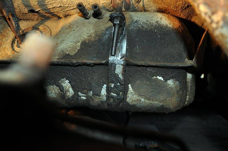

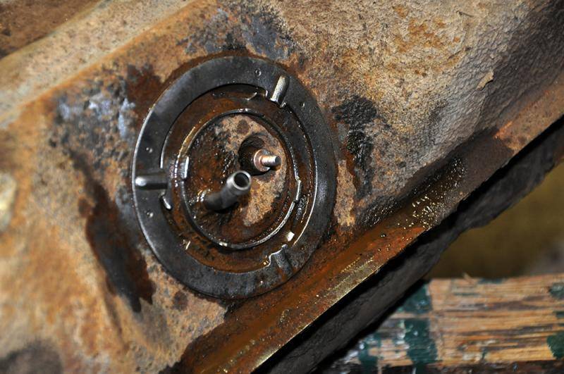

but lost this (possible to remove the sending unit without a special tool?)
and that. (tank is toast.... )

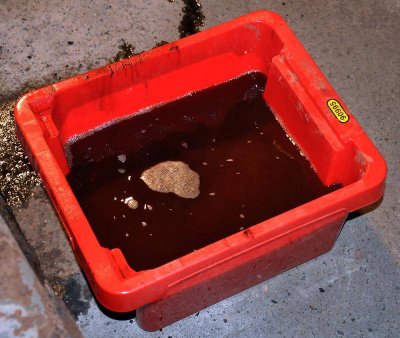

There was still a lot of gas in the tank, hope it saved the sending unit.
And it is still "good" after 32 years. Unbeleavable with modern gas.

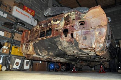

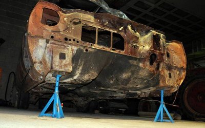

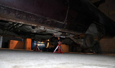

What's the best spots to put the jack stands when using four? The car is too tail-heavy using the current spots.
