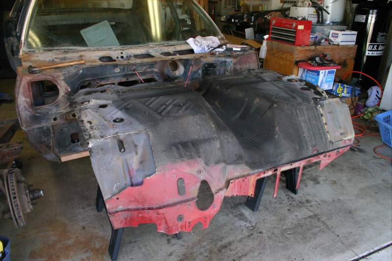

The only good way I've ever found is with a propane torch with a flame spreader. A good heat gun may do the job, but the torch definitely will.
I had great luck with a heat gun and putty knife, I'd heat a small area (4" square) and keep the heat on it and the spatula and start scraping leaving the heat on the spatula the entire time. The heat deflects into the undercoating and keep the spatula hot, the stuff just slides off.
This panel only took 20 minutes to clean, followed up with a wire wheel and scouring pads.

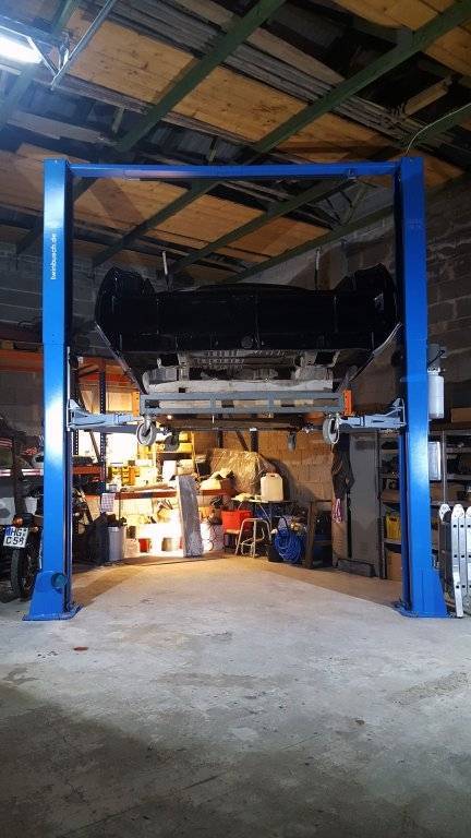

Thanks guys, that's an unanimous opinion :) Great! I will do it this way. I have a 5kg bottle of propan, should be enough I hope! And with the new lift, I have good access too.

Question: I was under the impression that you were renting the space. Did you buy the lift?
Yes I rented my work place and yes I bought the lift ;) It was time for a lift and I just have this work space... It's harder to move to another shop someday with this lift, but it's not impossible!
Whether he bought it or not he still sucks....:poke:
Great feeling to be on the "U suck list" ;)
It's a big 5 ton lift. Not that I will ever have to lift 5 tons, but it was the only lift with more space between the posts. With 3,34m I can get in and out of cars easily!

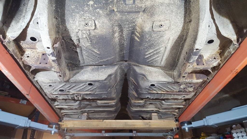

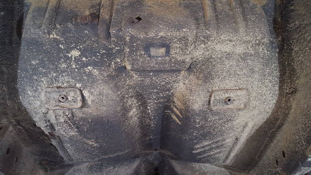

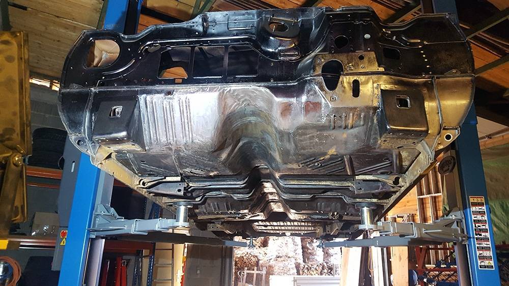

Removing of the undercoating is done! It worked really well with a torch, a spatula and a wire brush! Next step is stripping everything to bare metal.

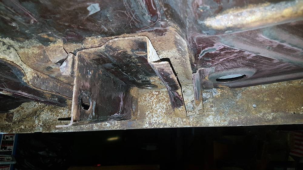

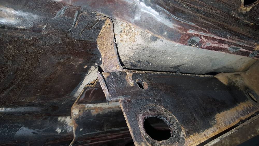

Just a few words about Chrysler quality control back in the day... One side of the Stub frame bracket is bolted like it should additional to the welding spots, the other side is not.... The bolt holes don't line up so they simply skipped bolting the bracket to the rocker... But hey, it lasted 48 years...

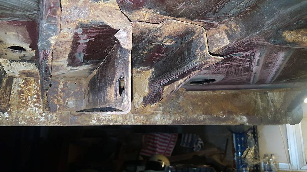

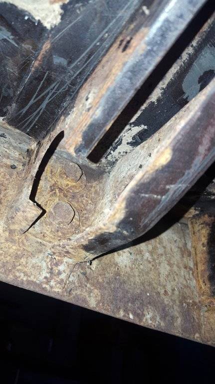

On both sides, these holding tabs are 'cut'. Are they supposed to be cut?

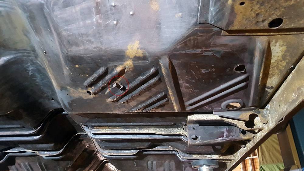

What is this clip for initially? It's on the underside of the drivers floor panel. There was nothing attached on my car.
Nice job in getting the undercoating off the underside of the body - it looks like it did its job over the years of protecting the floors and other areas. Not sure about whether the holding tabs should be cut, but I can try to take a look under mine. Usually, though, that clip you are referencing is usually used to hold the speedometer cable that goes from the transmission and up through the lower firewall and into the speedometer.
