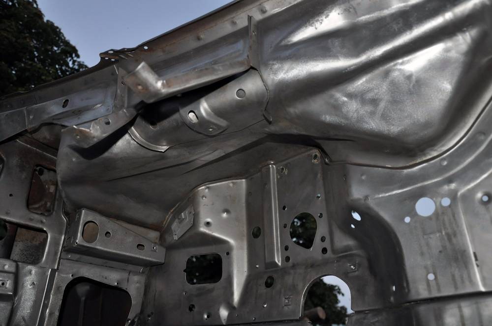

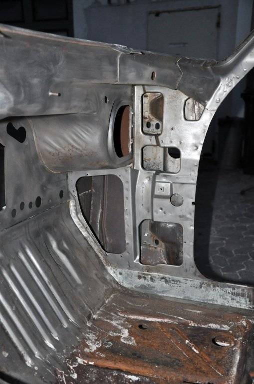

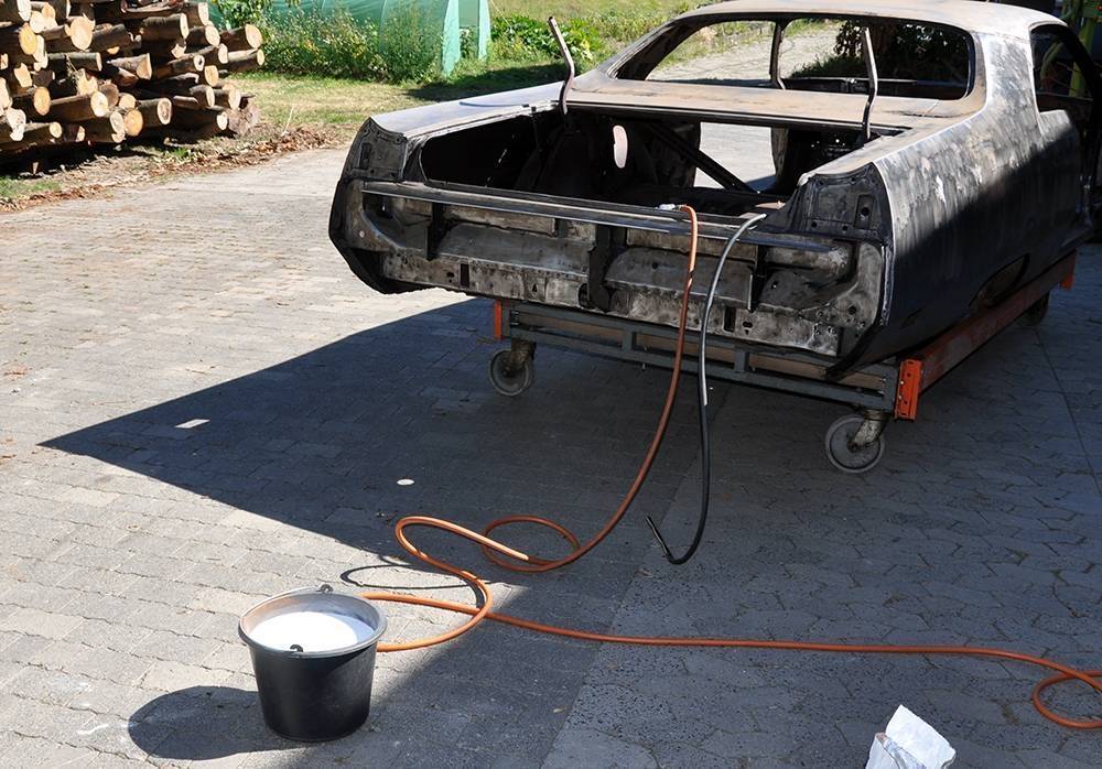

I took a week off to use the last few dry days to finish stripping the car body. I almost made it (excluding the trunk). Maybe this week after work, I will finish the interior.
I met a painter (that happens to be my neighbour) and we talked about the best way to protect the progress I made. I'm waiting for a quote from him for spraying the bare metal parts of the car with either Brunox or directly with a zinc chromate primer.
The hardest part was to remove all the spray glue...! The media blaster couldn't remove it, because it's too "bouncy" and the sanding disks gummed up immediately so I had to use a lot of brake clean and wire sponges. Not funny!

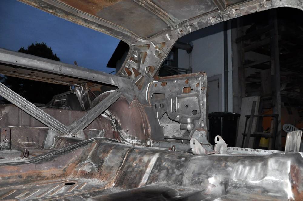

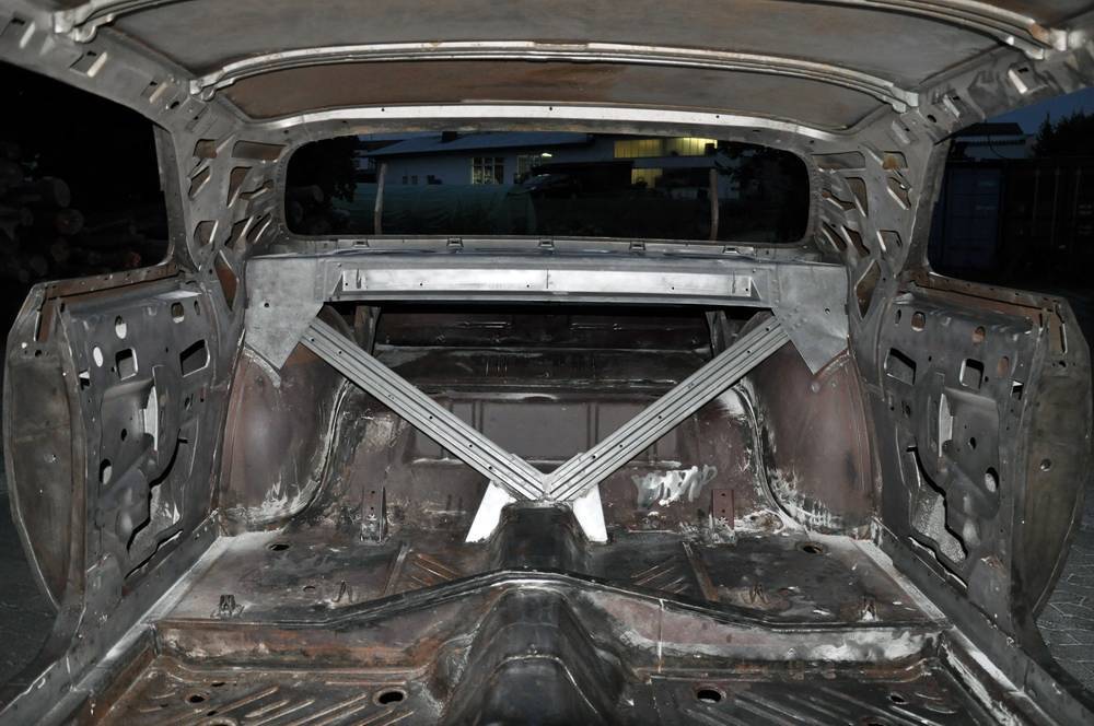

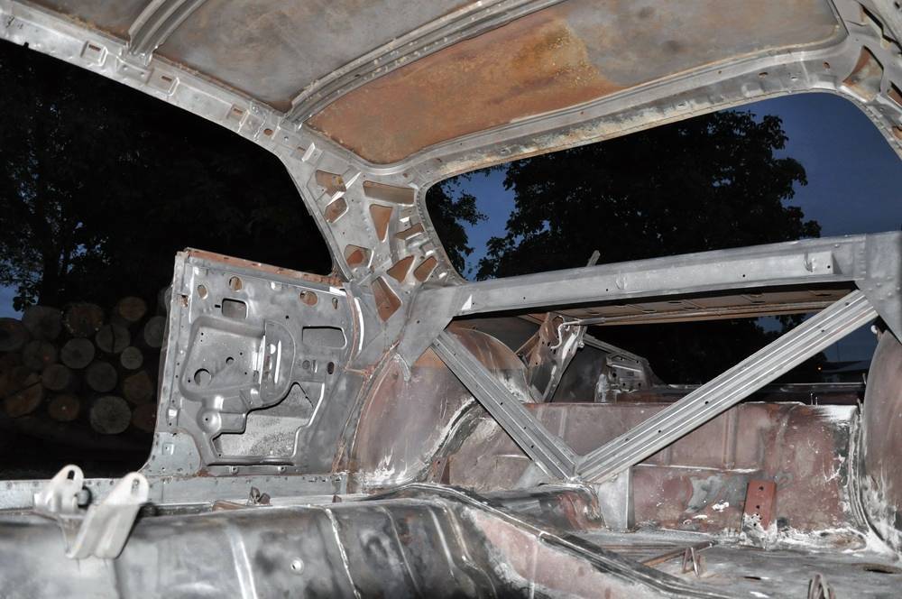

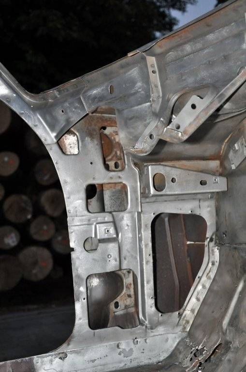

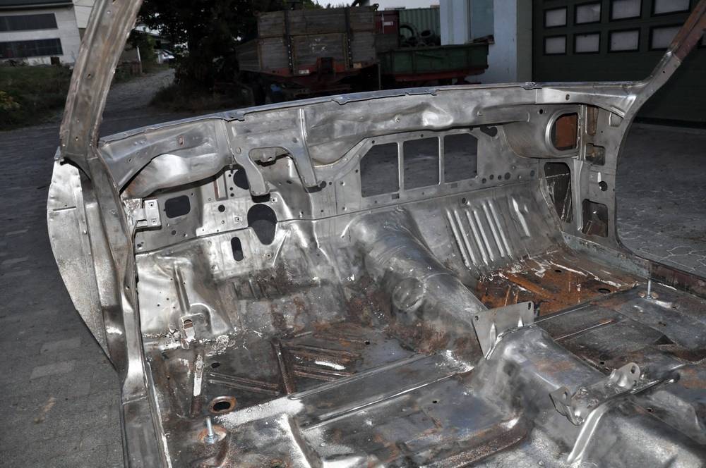

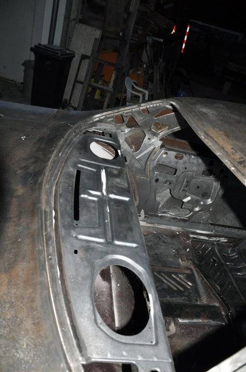

No updates on the car body yet. I'm waiting for the last few sunny days to finish stripping the interior of the car so that the body can go to the paint shop for primer.

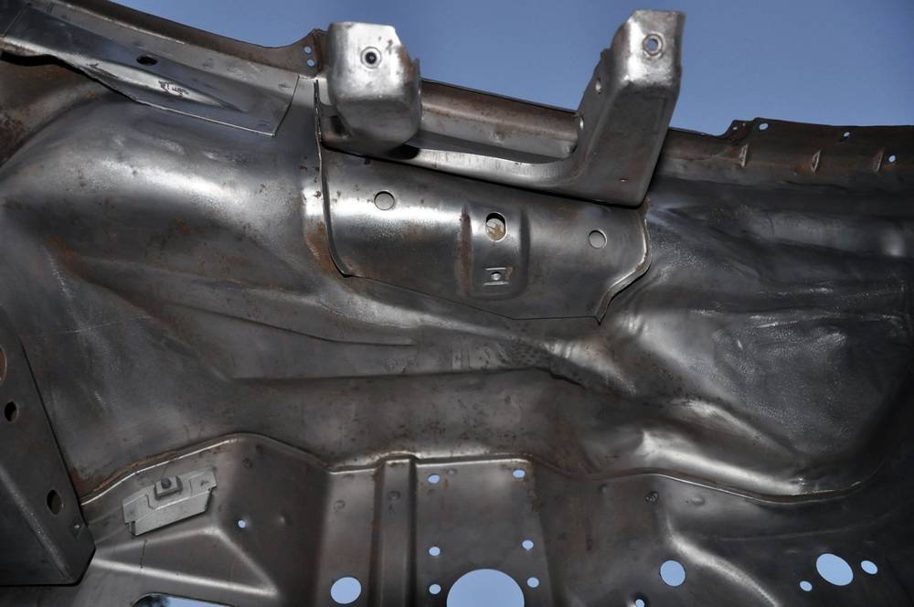

It's not much left the clean. Just the last pieces of this part. I will do the inner fenders, axle tunnel and the trunk next year. They will not be primered for now. Just the bare metal parts.
All I need is dry weather for media blasting...
Besides of the body, I media blasted a lot of small parts so that I can work on them this winter at home.

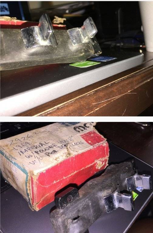

1969 Imperial 2 Dr HT, 4 Dr HT, 4 DR Sdn Door Window Lift Switch
Part number: 2926 308 (use 1 per car)
Factory parts book section number: 23-41-170
Part description: switch, right front door window lift, without power door locks, with power vent windows
Application: all 2 door hardtop, 4 door sedan and 4 door hardtop Imperial models equipped with factory electric windows, without power door locks, with power vent windows
Price is $45, and includes shipping within mainland US
To purchase or get questions answered, contact Allen @ xs29j8@charter.net

Thanks Stan! Wrong part for me but thanks for thinking of me! :)
I don't have vent windows.
I'm still trying to reproduce the rubber boots but all attempts failed so far.
