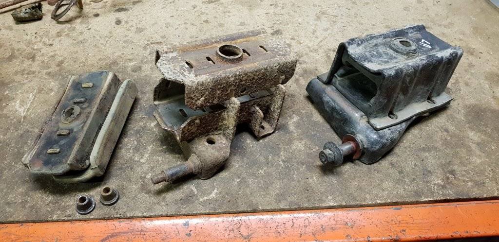

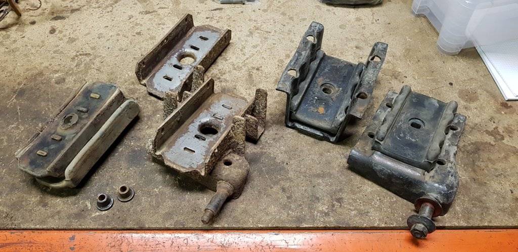

Which one would you use and why? What are the Pros and Cons of each one?

I’m assuming same application just different years? If that’s the case I’d use the one that’s not all pitted.
Yes, the left one is from my 69 and the right one is from the 72.
I like the original one, but if they changed it completely because of structural reasons or something like this, I would use the newer "better" one.
Ya, the condition is not important, I will make them pretty, no matter which one.
I just thought maybe one is a better design over the other. Either the early one and they changed it because its cheaper to produce or they changed it because of flaws in the early design. Something like that.
Same thing different design. The 72 looks simpler and was probably changed to make it cheaper... and in this rare case probably better. Why do I say this you might ask????
Because the 69 version, if not perfectly set up might cause metal to metal contact.... and squeak.
I also like that the rubber is better encapsulated and protected in the ‘72 version. It also more positively connects the leaf springs to the axle. Additionally, it also has the advantage of not relying solely on the crush of the rubber through compression and shear (under lateral loads) as well as tension on the U-bolts. On the ‘72 the U-bolt work primarily in tension.... as they should.... and the upper heavy steel cover and base take all the lateral loads.
In my opinion.
I also like that the rubber is better encapsulated and protected in the ‘72 version. It also more positively connects the leaf springs to the axle. It also hast the advantage of not relying solely on the crush of the rubber through compression and shear (under lateral loads) as well as tension on the U-bolts. On the ‘72 the U-bolt work primarily in tension.... as they should.... and the upper heavy steel cover and base take all the lateral loads.
In my opinion.
Javier
Thanks for your opinion on that! You're probably right. I guess that's the way to go! :)
