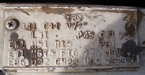

Are you sure A12 appears on the tag?
Wouldn't a better identifier be the 125 SPD and J99 VON?
Don't know. Here to learn.

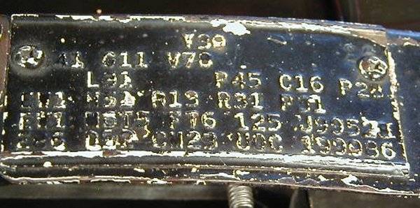

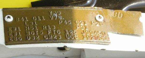

The 125 is the scheduled build date which would be in line with the 300H but not conclusive as many 300's aside from the H would have been on order also.
The order number is normally a 6 digit number, The first digit on this tag looks almost like a strikeover, not sure whats going on there.
Everything on this tag points to a 300H. The lack of the A12 group code makes it suspect as to it being a 300H. All I've seen have had the code on the tag. (Wouldn't be the first time a code was left off the data tag). Could be a white 300 with gold stripe and tan interior.
You'd need the broadcast sheet to verify.
Thanks. I'm thinking the earliest cars didn't code the A12 but could be wrong.
Mine has the A12 code and the Jan25 SPD, being actually built around late April.
