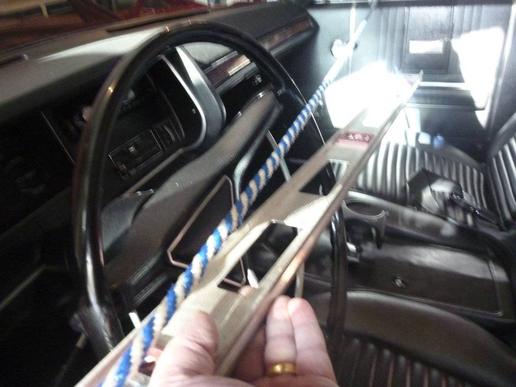

This is awful to admit but my steering column isn't straight and I never noticed it before.
Well I guess I'll never stop learning something new! After owning my car for 48 years I never realized my steering wheel was offset - so after reading this thread I had to check it out. I tied a rope from mirror to mirror such that it just touches the vent window frame on both sides. Then put a 4' level across the steering wheel and found about a 20 deg offset.
The rope just touches the wheel on the right side and is about 1" away on the left side.
I look upon this as a feature to make it easier for me to grab the right side of the wheel and haul my "man sized" body onto the seat without hitting the left side of the wheel. Poor man's tilt!

How should the tilt & telescope wheel not have the off-set?
A straight wheel (in the same spot) would require a totally different steering column with at least two universal joints which, as was pointed out earlier, would probably have cost too much.
As far as I know there are no different lower column covers only for T&T steering columns providing for a different angle.

As I said, I never noticed before, but now it bugs me. I'm sure I'll get over it but my wife noticed it yesterday with no heads up from me. I asked her to sit in the car because I had put some shims under the seat. She sat in the car and felt something was Crooked. Between the out of square steering wheel and the wavy glass in the original windshield it isn't as comfortable to drive as it should be.
The issue isn't with the column but with the column /steering box misalignment. Also the adjustability of the column is very limited and doesn't come close to making up for you misalignment.

IF you really want to get to measuring, you'll notice that the engine is shifted to the right in order to clear the power steering gearbox (chuck). So it's not parallel to the rocker panels. This was allegedly done to equalize the weight between the front wheels on power steering cars.
The steering column has a slight angle toward the outside of the car, related to the mounting location of the steering gear.
One other side issue in favor of the engine angled toward the rh side of the car is that this puts a slight lateral angle into the front u-joint/transmission interface, for vibration reduction.
