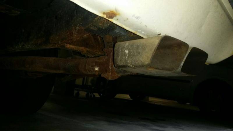

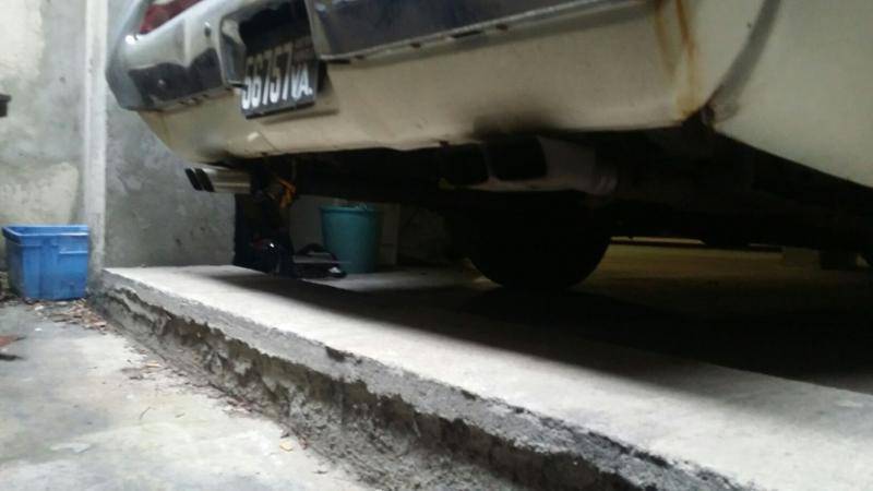

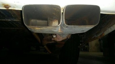

You have to admit. The GT tip does look like a hack job was done to "make" it work.
Fascinating stuff! 5 stars.

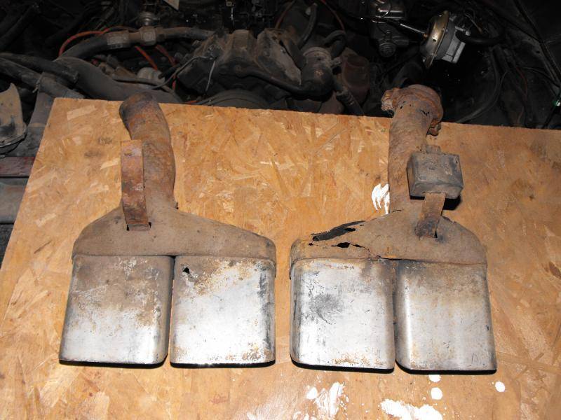

I've got this ones on my Hurst :
This is a pair of original tips
I see a genuine OEM Mopar factory part that they didn't do all that great a job of grabbing off the shelf and hacking it to fit on the Hurst...
