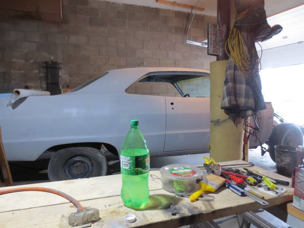

1970 B5 Sport Fury GT...Critters folly....back to basics

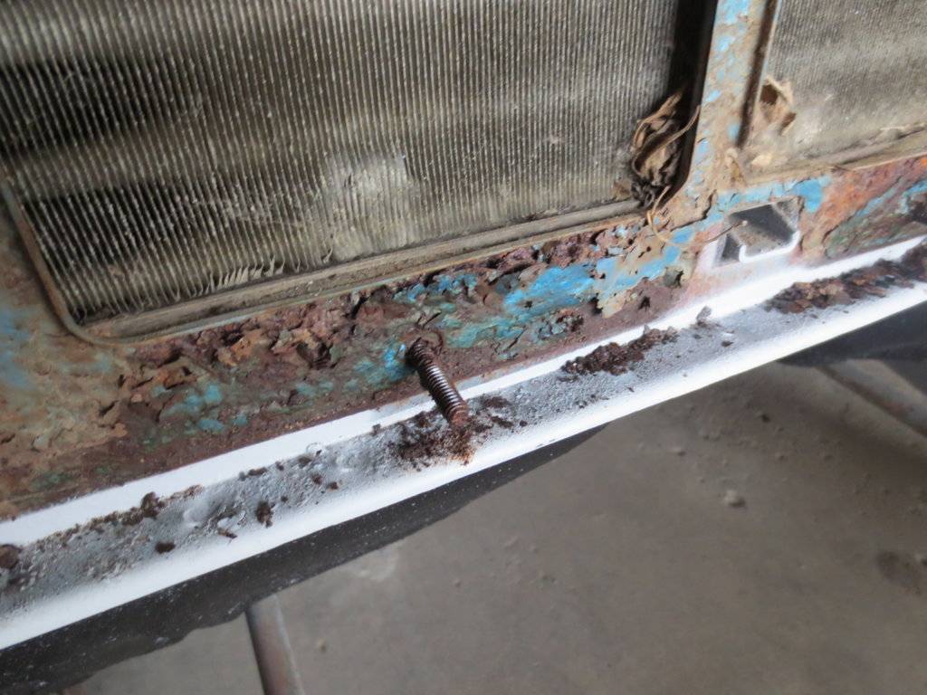

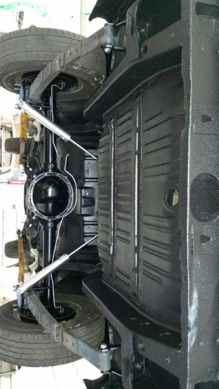

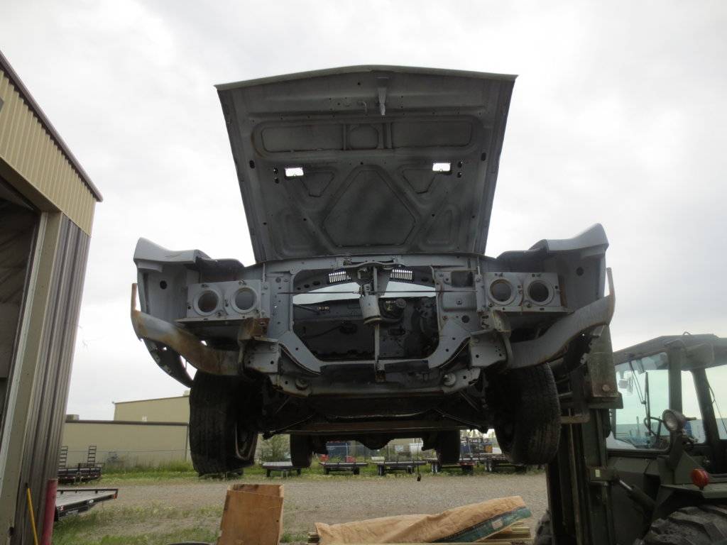

Really impressed with your work, Critter. Tell me, did you power wash the under carriage before you hit it with the Rust Bullet? It looks like it was pretty clean before you did it.

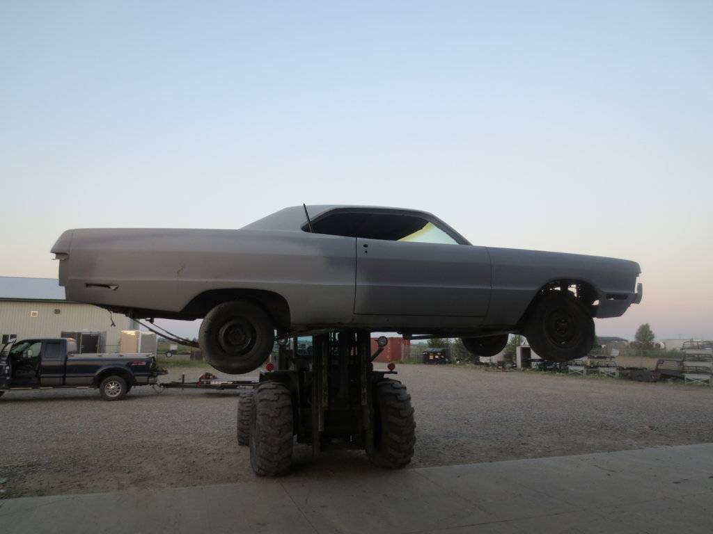

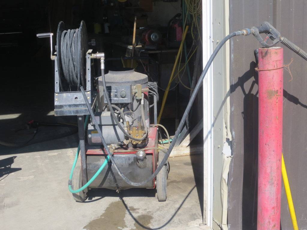

4-5 hrs blastin and vehicle was in the air for easy access...200Degrees + hot water and hold on tight spray blast 1000psi....Hotsy Hotsy Model 680SS Hot Water Pressure Washer
….any grease or dirt on that car is long gone...any lose undercoating long gone along with not lose in areas...then hit it up good with rust bullet cpl weeks later and topped it off with rubberized undercoating...that babys bottom is sealed good as well as a 2k primer coating in car itself...

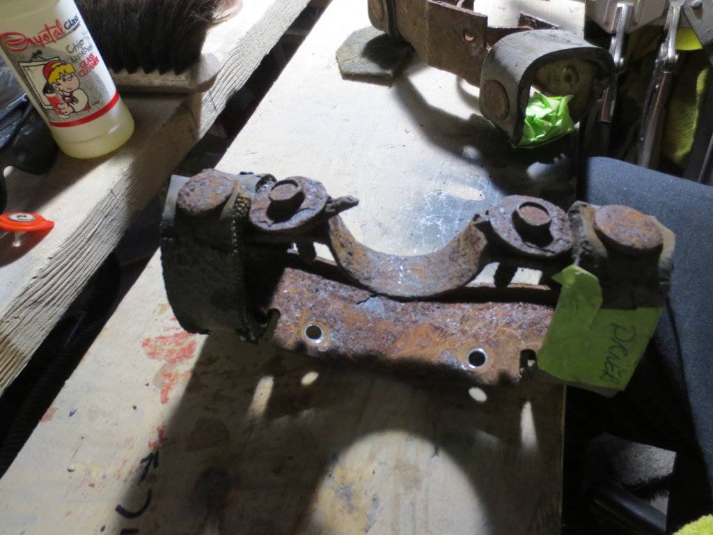

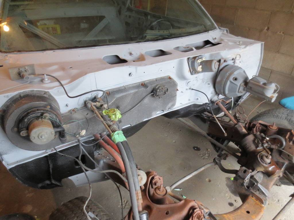

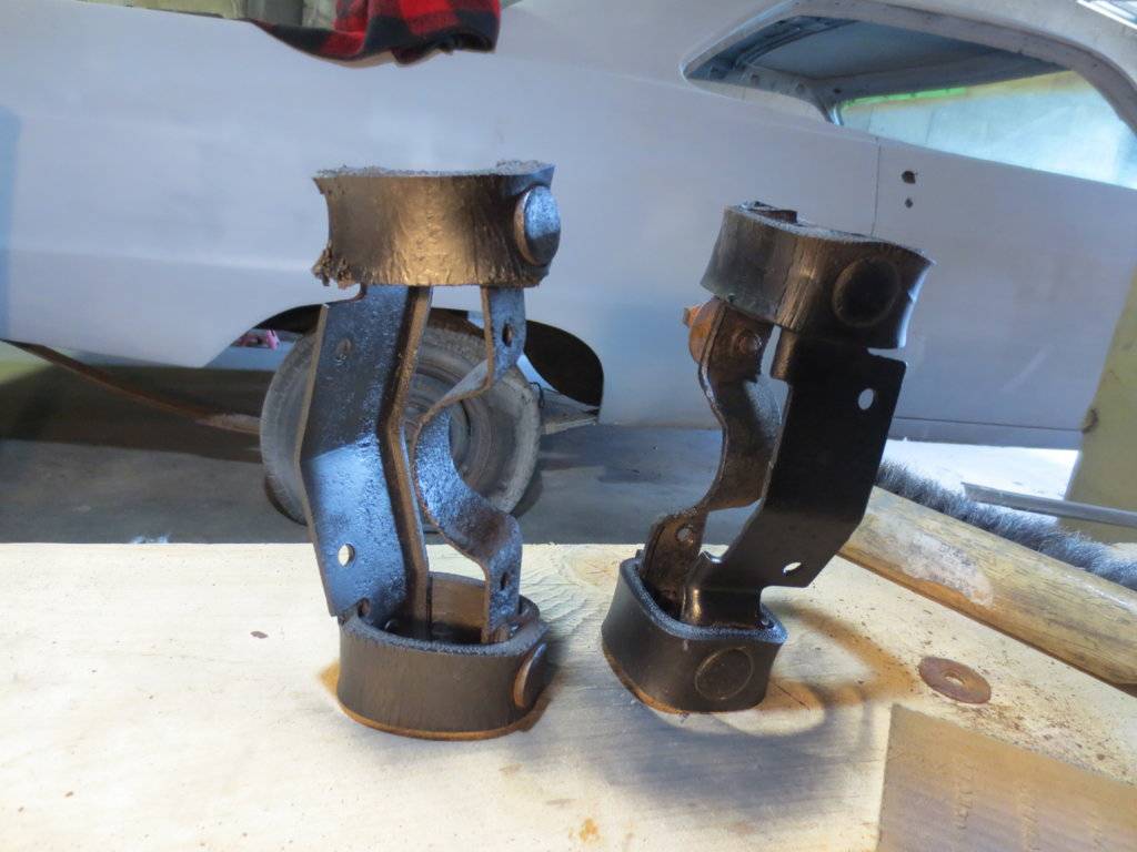

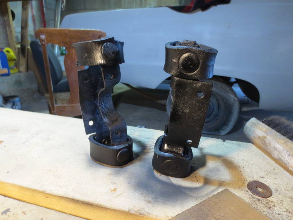

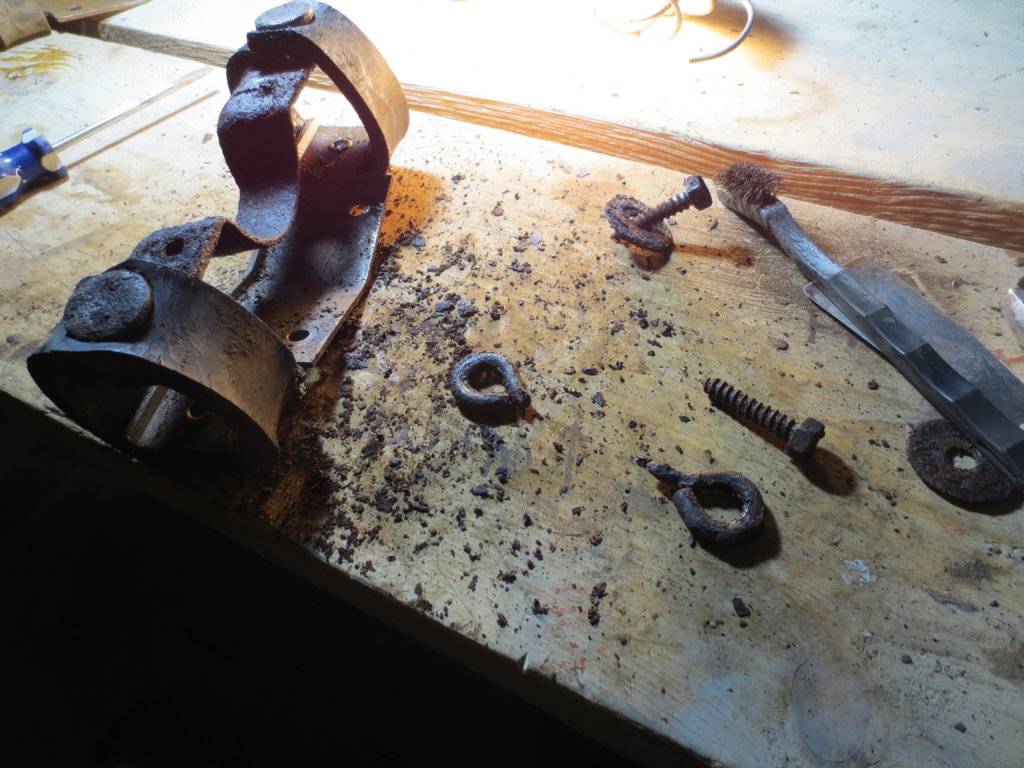

Cleanin up parts as l rip them off er surgical remove them srry....

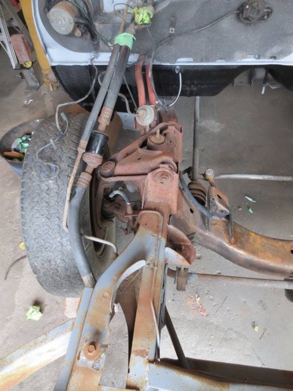

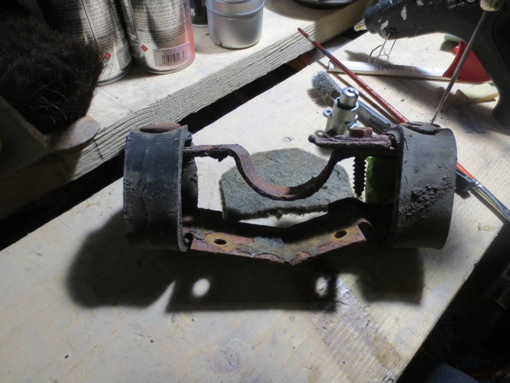

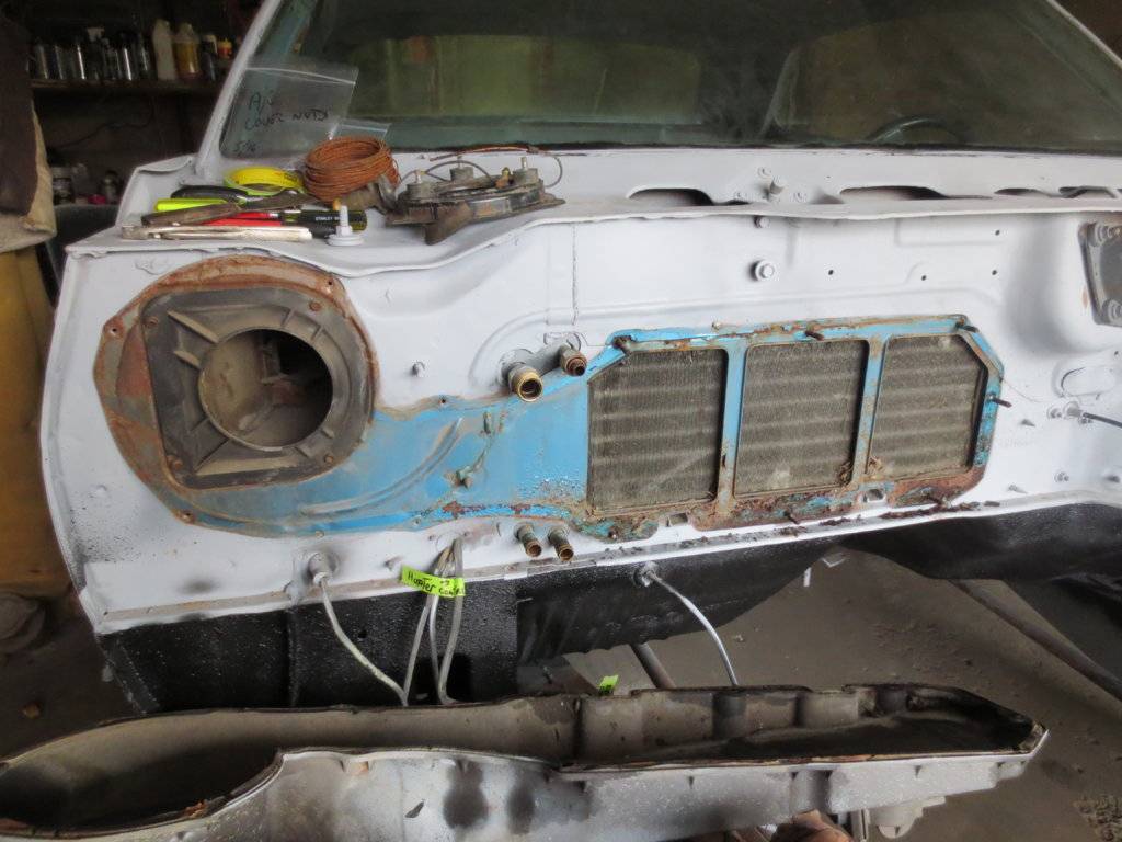

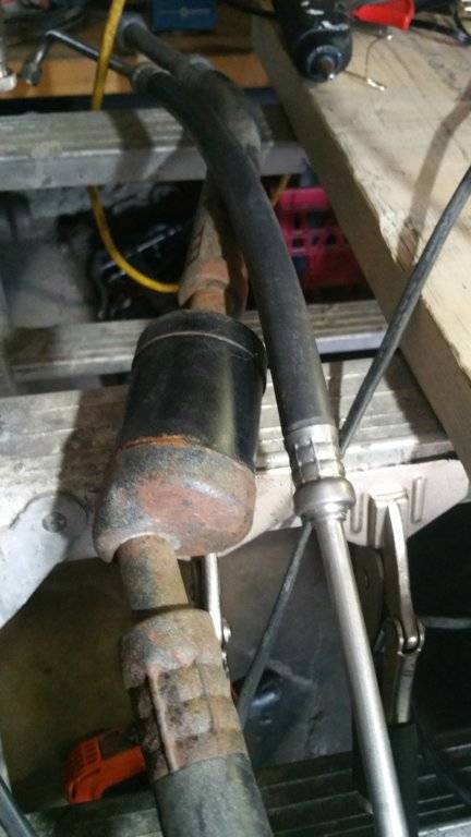

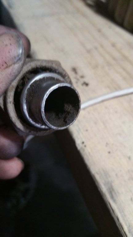

Am dealing with A/C hoses and cleaned up small one and it came out nicely....however l tried to blow through it and it was blocked......large one isn't but has black crud or dirt at conection and inside pipe at lip....question is what is it?....can these hoses be flused and cleaned ? Or am l better off getting new ?
Am concerned about crud or dirt in system and screwing up compressor or blocking a part of the system ..

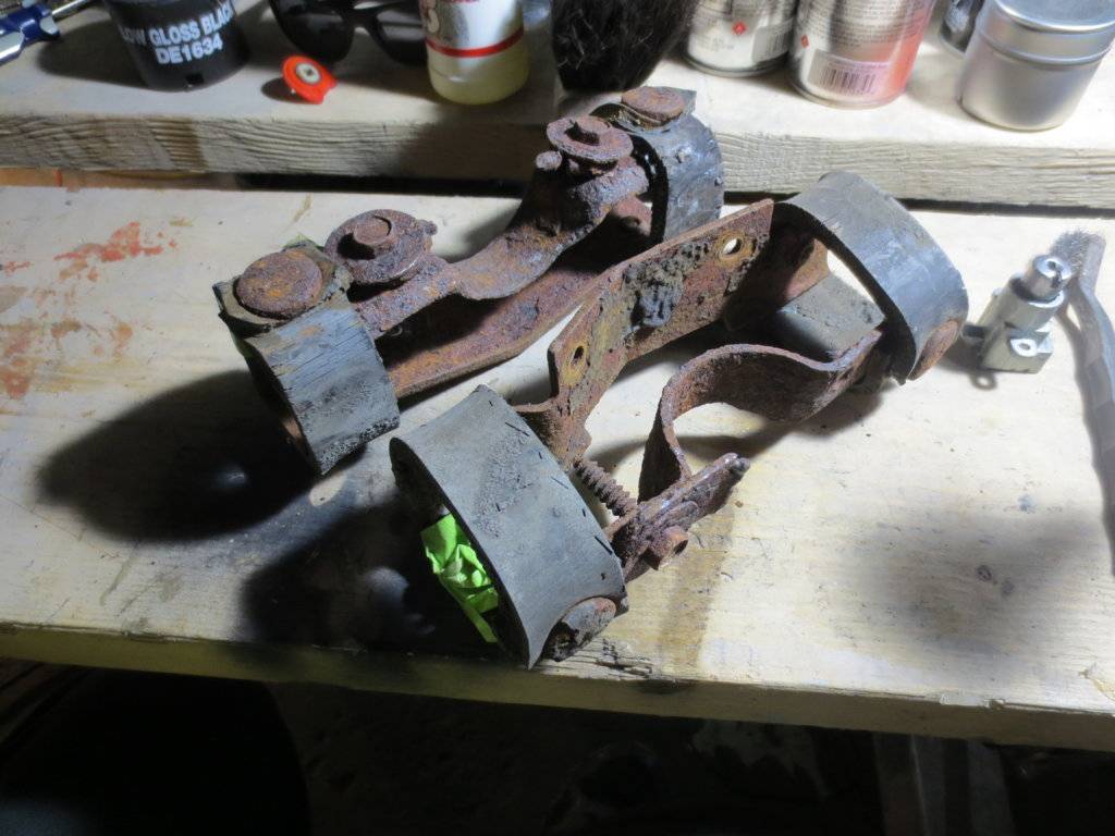

this oem for 70?

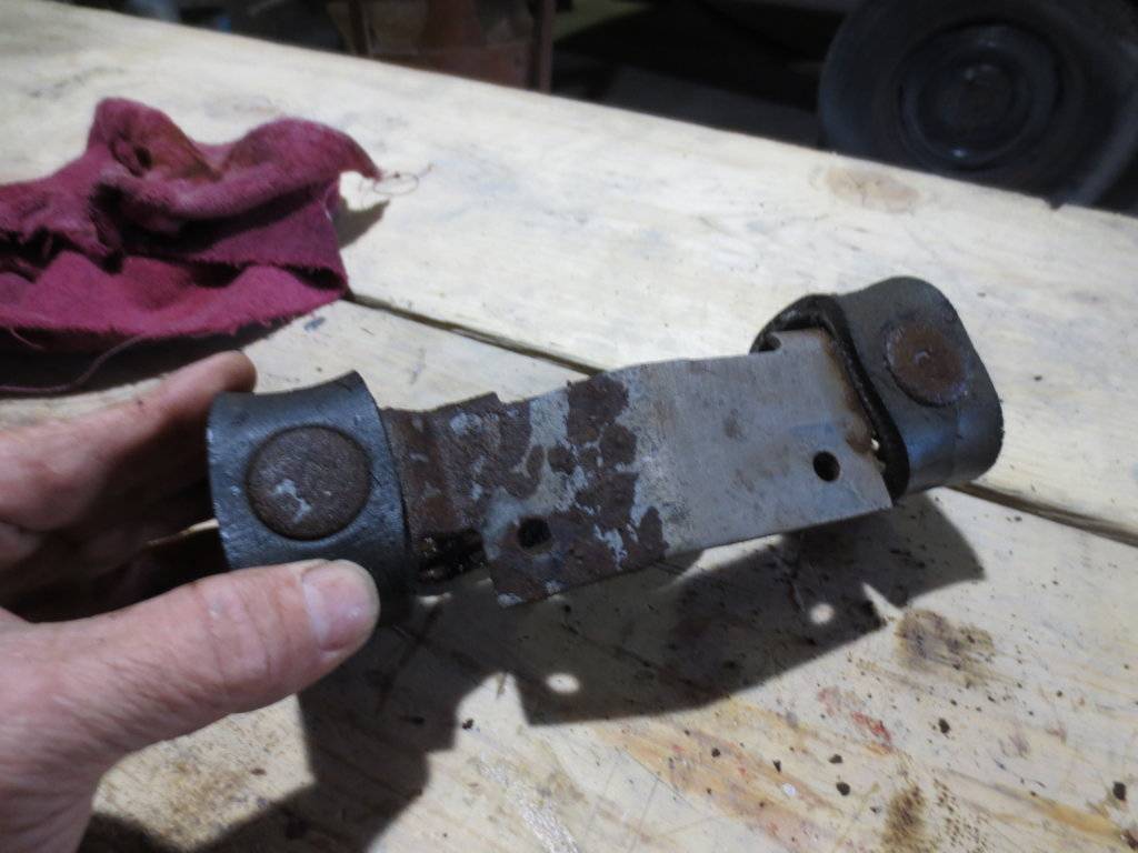

new insulation and gaskets required...

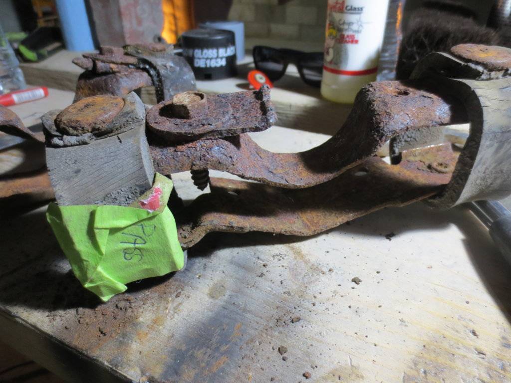

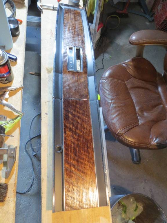

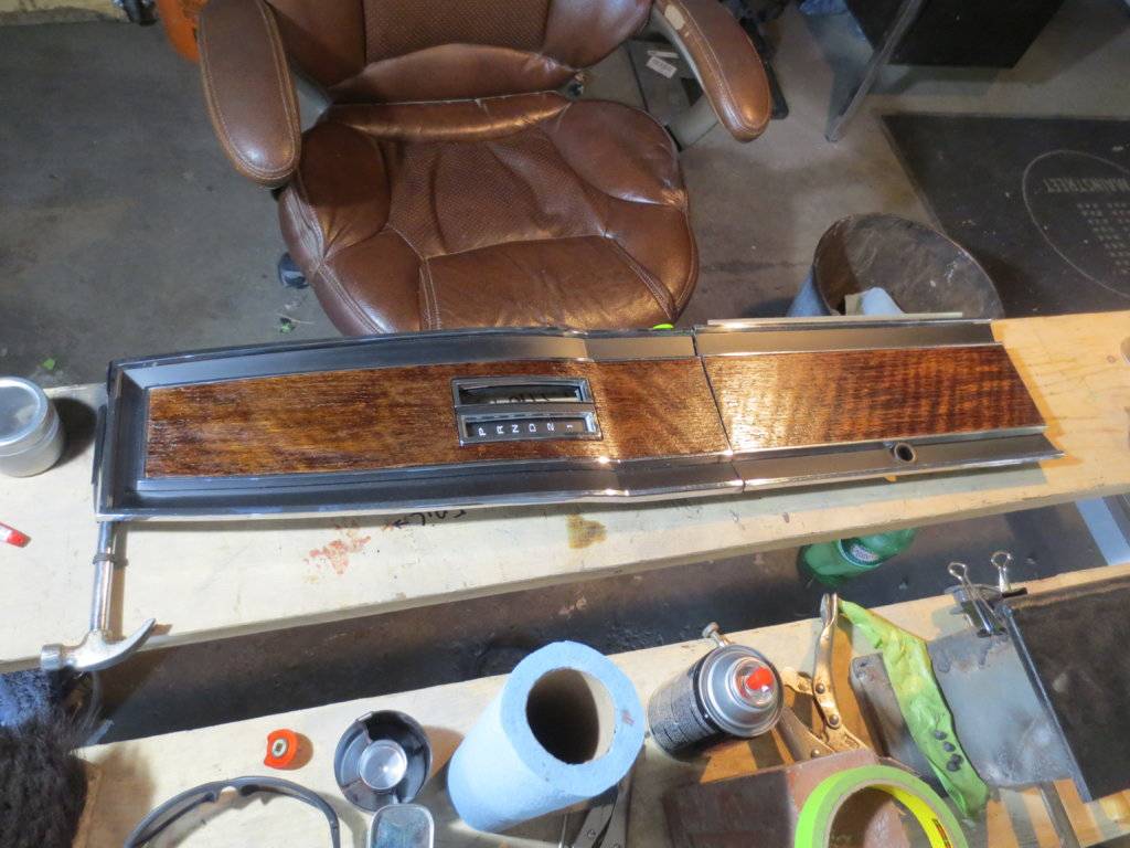

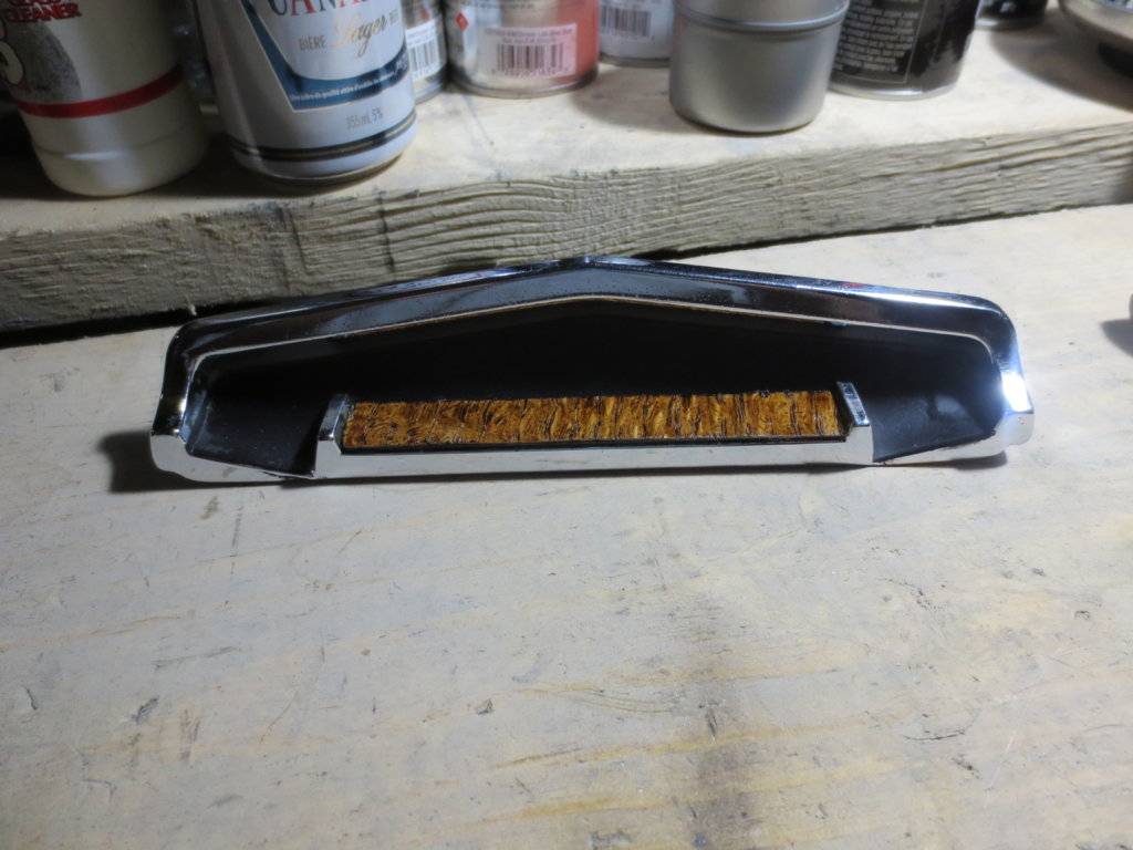

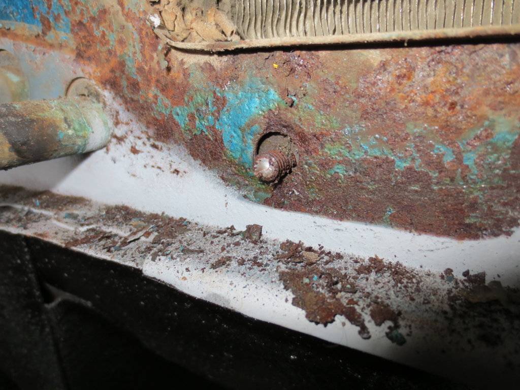

B5 blue...little bit of surface rust will clean up nicely
only broke one bolt....

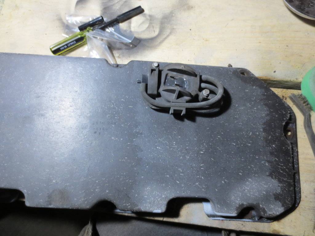

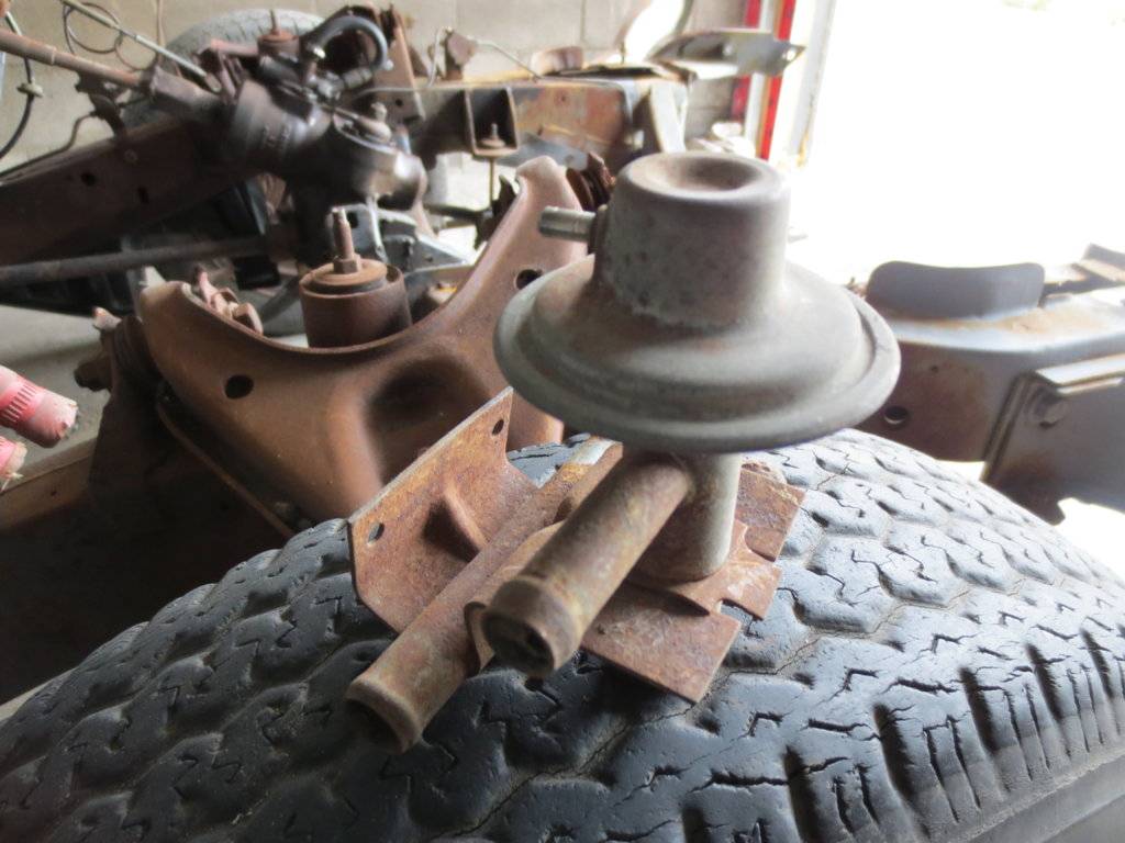

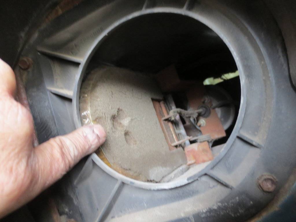

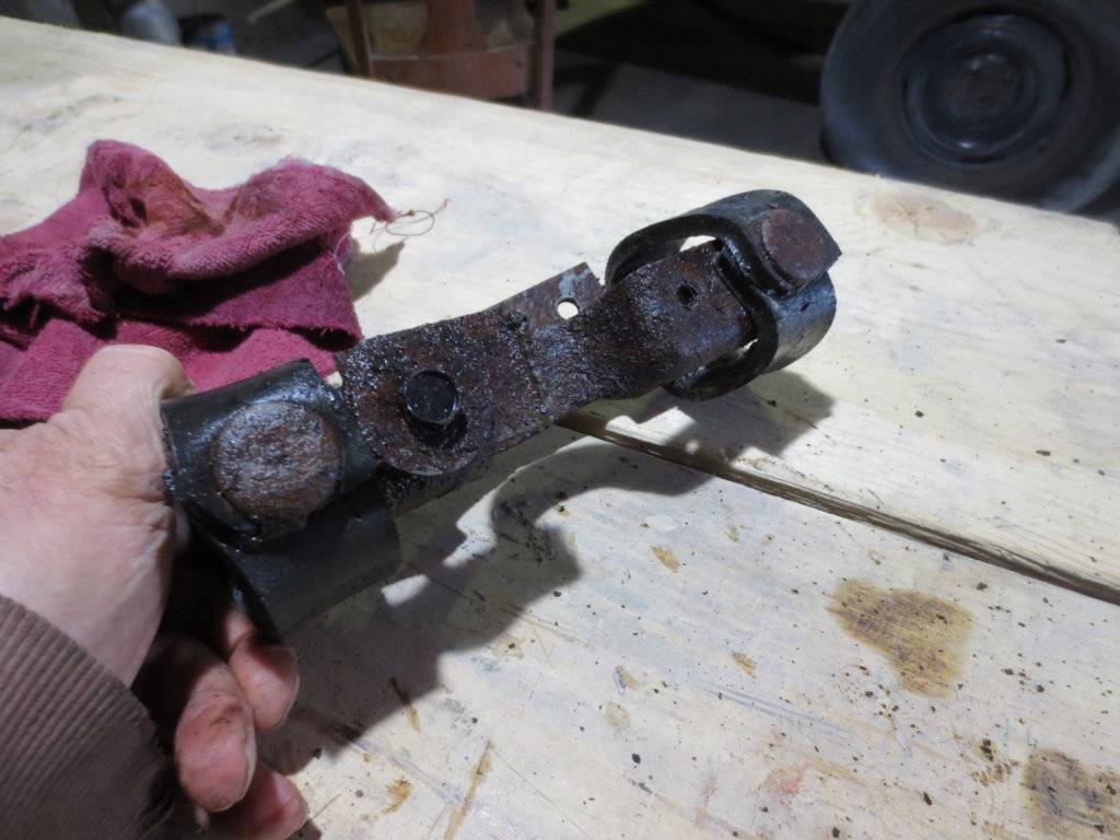

what the heck is this and how do you test it????
Am concerned about crud or dirt in system and screwing up compressor or blocking a part of the system ..View attachment 212794
Looks like the compressor has already been killed. You can clean hoses that don't have a muffler on them, and the evaporator... maybe the condenser if it's not a parallel flow type... everything else is a disaster waiting to happen.
