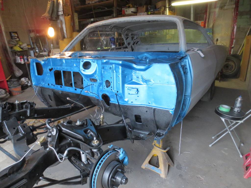

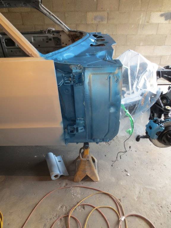

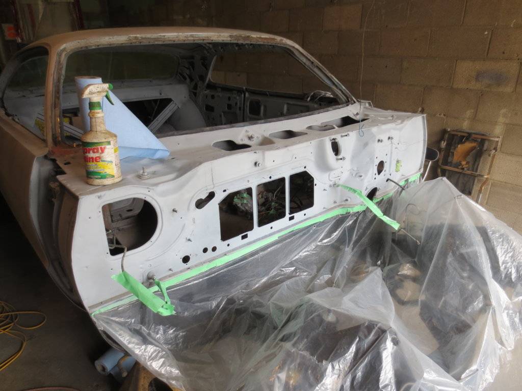

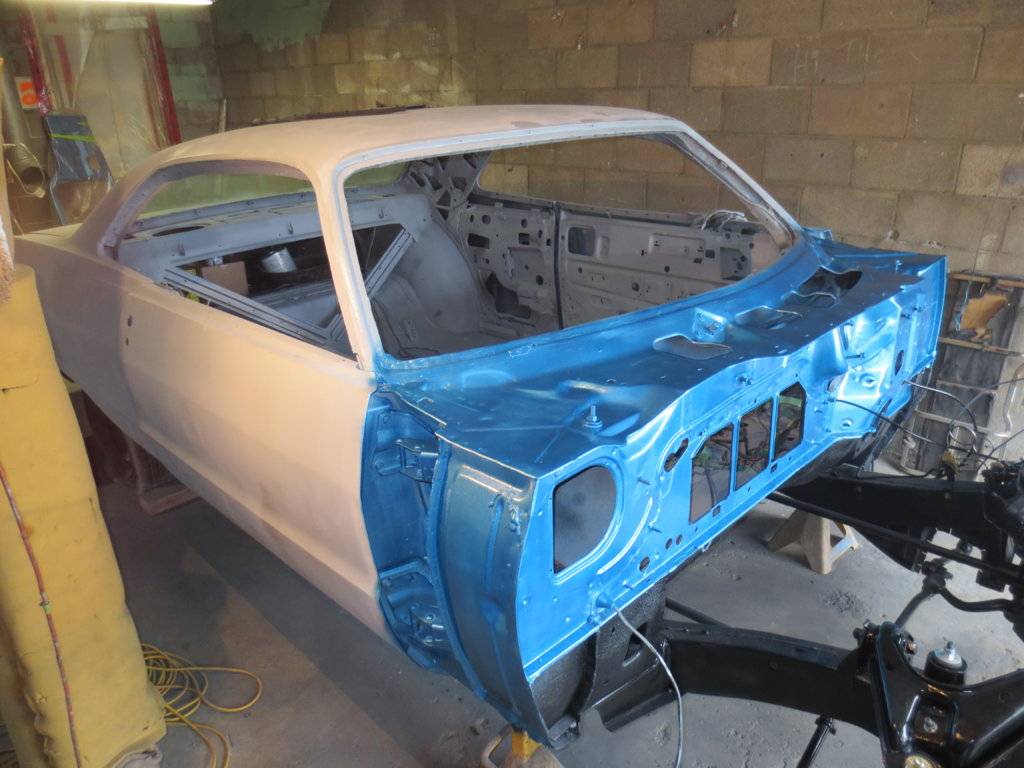

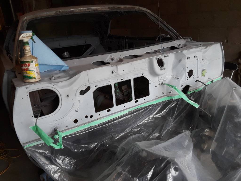

1970 B5 Sport Fury GT...Critters folly....back to basics

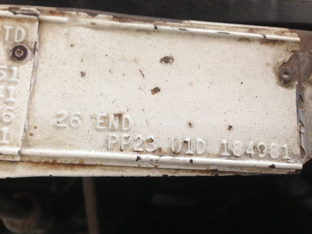

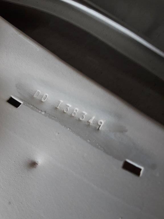

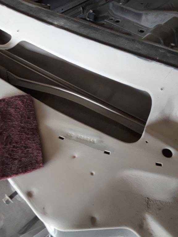

Rivets D? :confused:
that's the way it came...
...wish Paul woulda left my 71 the same way...sooner have rivets over screws

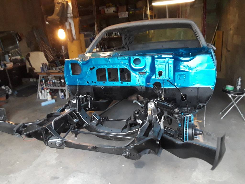

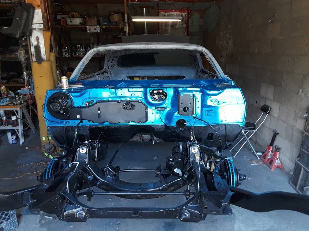

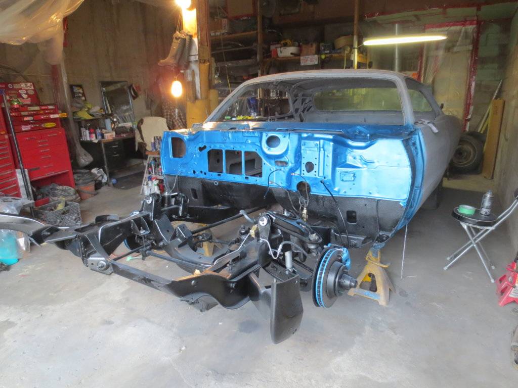

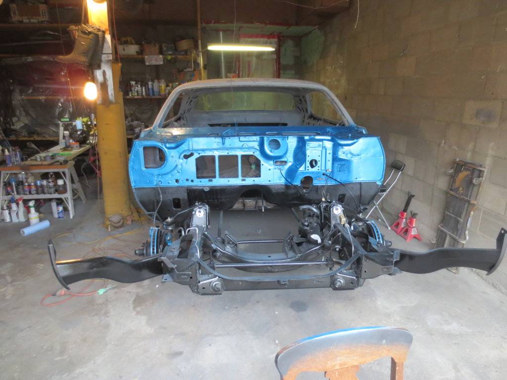

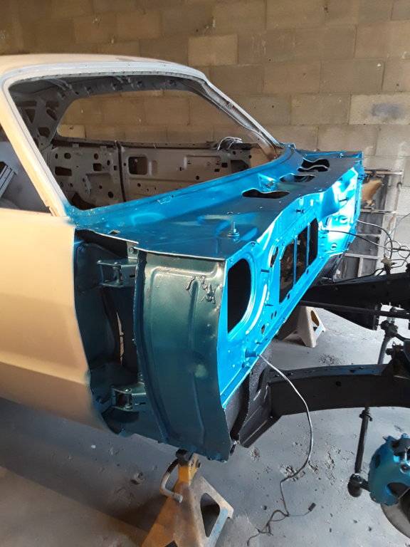

Critter. It looks like you are making some progress in baby steps. Looks good so far. Can't wait to see more, please keep posting if you can. The finished product should look awesome.
Hope you drive the wheels off it. :steering:That's what our cars are supposed to be for, driving. Not trailer queens. Those are Hemi B-bodies.

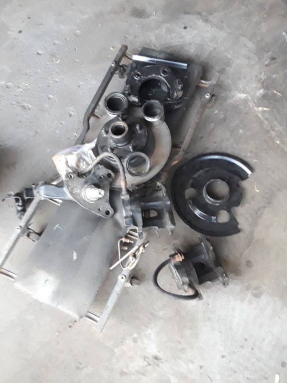

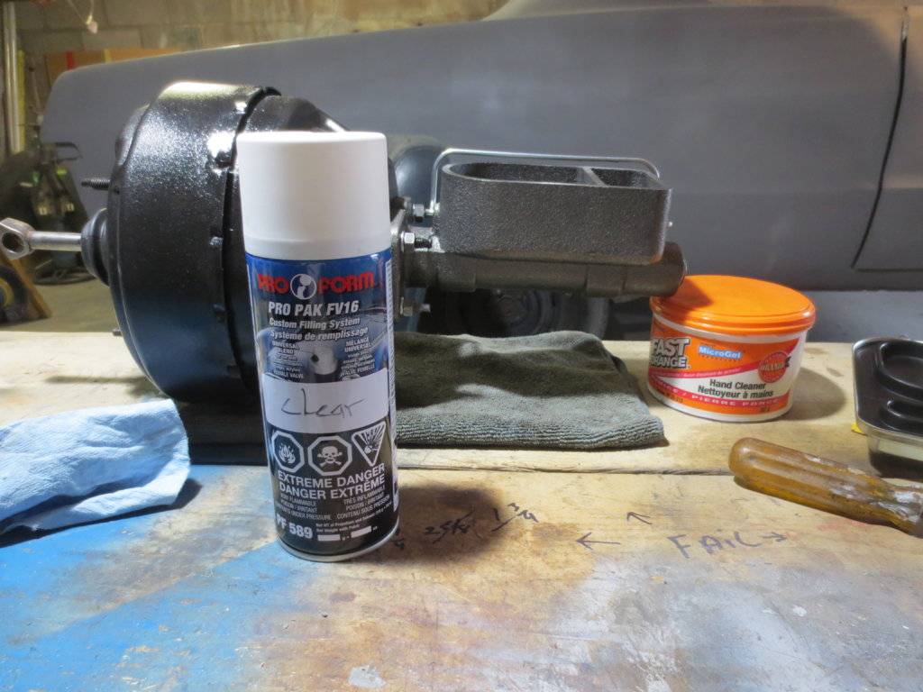

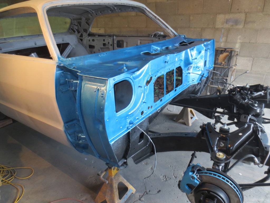

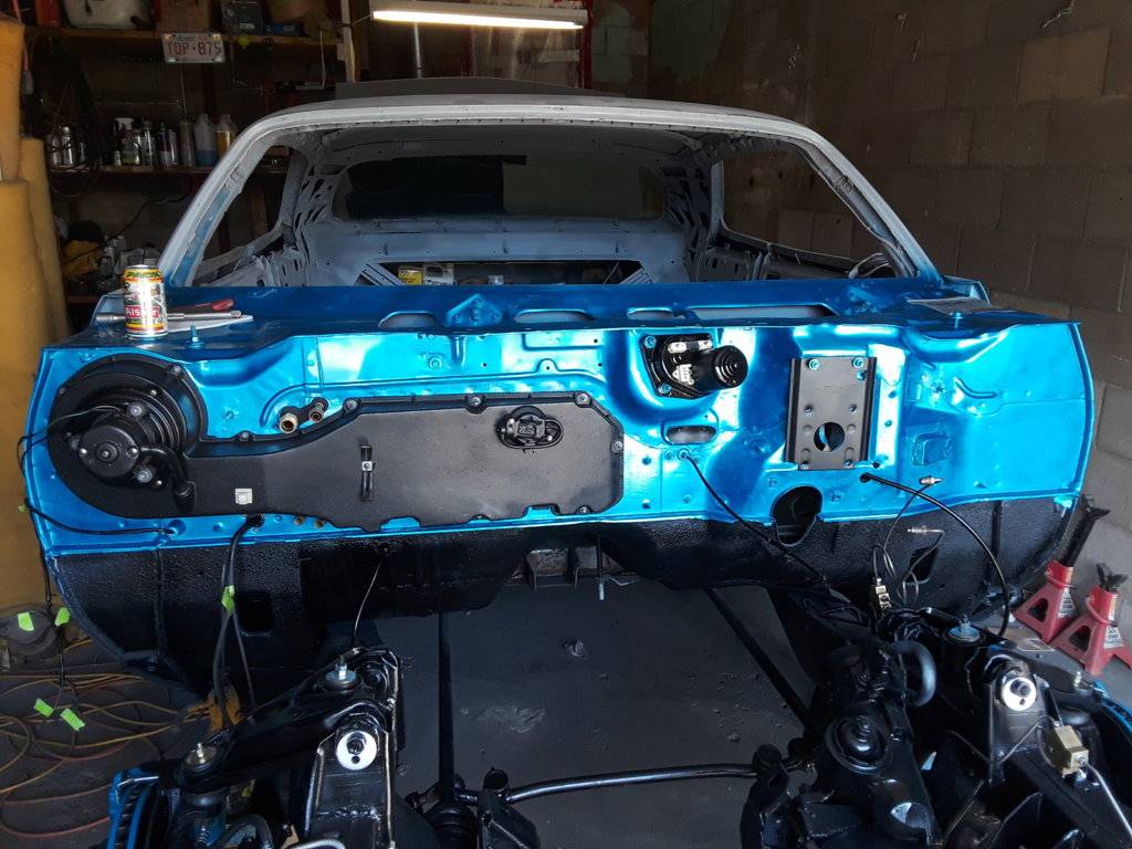

Another day another part.....rebuilt old brake booster...master cylinder was toast...hada replace....
Just curious : where did you get the new disk brakes ?
Got them through napa....had originally set.for car...toast ...and had a 73 setup to swap out on another fury...the 73s were pitted so went new....funny thing is l have one 73 caliper and a 70 on there....there basicly the same but had to grind a little on the ear to get the 70 caliper to seat properly whereas the 73 was simple for into existing 70 setup......used rotors from 73 set
