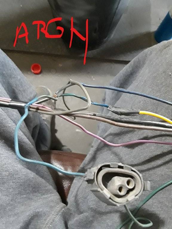

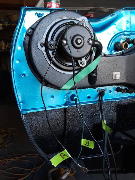

I don’t know but I miss Canada and it’s Old Style Pilsner...few questions...got car in pieces for most part so everything is a learning process as to where stuff came from or hooks up to and what pieces lm missin ect so is a learnin process...made the mistake of looking at the wireing harness and figured its gotta be done sometime...electricals not my strong suit...
first question
On fan motor is black and green wire...assume black is ground...where is this wire normally grounded to?View attachment 288609
I had mine labeled as grounded to one of the bolts of the wiper motor.few questions...got car in pieces for most part so everything is a learning process as to where stuff came from or hooks up to and what pieces lm missin ect so is a learnin process...made the mistake of looking at the wireing harness and figured its gotta be done sometime...electricals not my strong suit...
first question

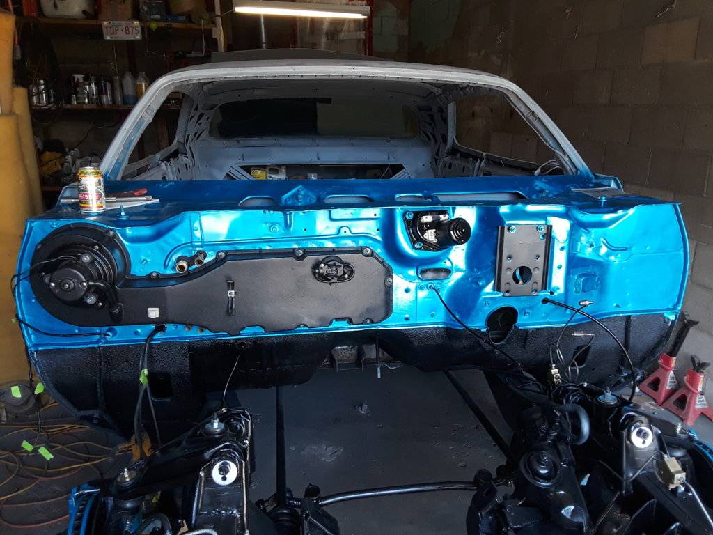

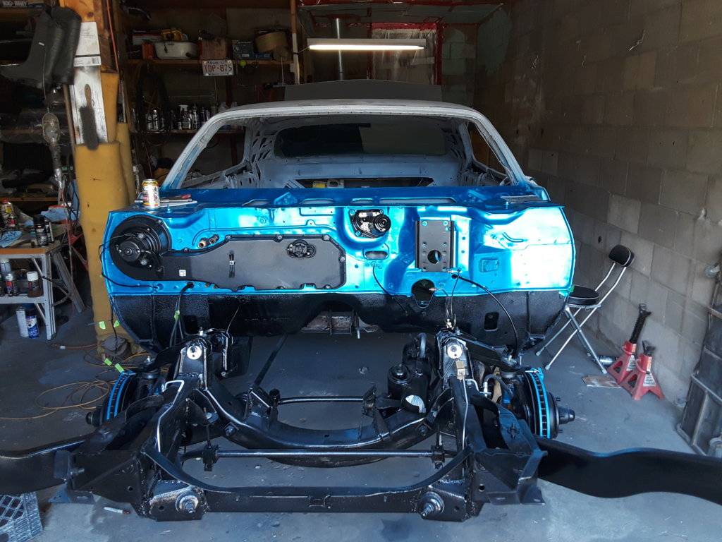

I take it this is the end goal? Love the blue.
The stub and firewall look great, good to see you making progress on it.
In other words, you won't be afraid to actually drive this one...this GT is gona be built the way l want it......ease of maintenance being key here...….
On my SFGT, the fan ground wire attaches with a screw that holds the heater box in. It's to the left of where the evaporator lines enter. In fact, in your picture of the fan motor, the green tape you have holding the drip tube points directly to this screw (upper right where it wraps around).
Hope this helps.
