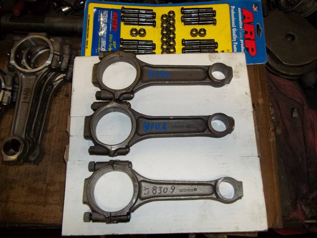

IF you want to chase factory part numbers, the heavier 6-Pak rods will need a crank that is balanced to match their heavier weight, which will generate a different factory part number for the crank. I suspect the factory 6-Pak pistons, having a taller compression distance, will be heavier than the normal 440 pistons of that model year, which will need a different crankshaft balance to be correct, too, AND a different factory part number for the crank.
The basic crankshaft item will be the same, ONLY the labor operation to do the balancing of it will be the difference, I suspect.
The torque converters are "generic", when built. Those that went with an external balance motor got the additional TWO weights on either side of the drain plug (of where it used to be) on the torque converter. Direct Connection used to sell the weight kits, I believe. I know one of the old Race Manual sections detailed the converter weight issue.
Of course, the external balance crankshaft damper is specific to the "external balance" motors only.
I'd always believed that the steel cranks stopped with the'71 model year . . . UNTIL I was looking through a '74 and a '75 Chrysler parts books I'd purchased from a dealer (as surplus items). That's when I noticed that it listed a STEEL 440 cranks ONLY with 4-speed B-bodies in both '74 and '75 model years' 440HO engine. Automatics had a different crankshaft part number.
From what I remember reading in the '80s or so, the factory 6-Pak rods were "overkill", but needed for the stock classes. Not unlike a '67 Camaro Z/28 with a 780cfm carb on a 302 cid engine, in that respect. I seem to remember reading why those same rods ended up in some 440 "U" motors, where they would have been even MORE overkill, but they did.
LOTS of weight in those B/RB pistons/piston pins!
