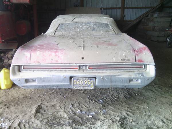

For Sale 1970 chrysler 300 convertible - $2000
Wow I could really really use that for the ev2 car but it is so far away shipping would kill me as it would be at least $800. Anyone out there have a rust free front stub out of a vert I could buy instead??
Bluefury361 you dont happen to have the front stub off that 300 rag for sale? I have decided to roll my ev2 vert out and get the resto going on it. I had thought I would cut out and box the bad frame rails on it but would love to get a stub instead to keep it more oem looking.

If it's been around for over 2 months on CL and the forum, it's over-priced and from what I hear it's missing a lot of parts (why no pic of the front end??). Not cheap, just know what we will pay for stuff and will wait for the right car at the right price. E and B body guys ran the price of their cars through the roof with all the "RARE 1 of ___" crap for all these years, it just doesn't translate to the C body, sorry. Dude, you've chimed into every for sale thread on how cheap we are. You are starting to sound like Dan. Just saying.

You "chimed in" on my ad. Im allowed. That car looks rust free to me. Yes the paint is shot but quarters look solid. Its worth 2 grand all day. If it has a big block.... Bonus. My fault man. I comment when I see the same 3 or 4 dudes bashing other peoples stuff. I'm not saying everyone on here is cheap. But Cheap C body guys are on here and you guys better look in the mirror....
