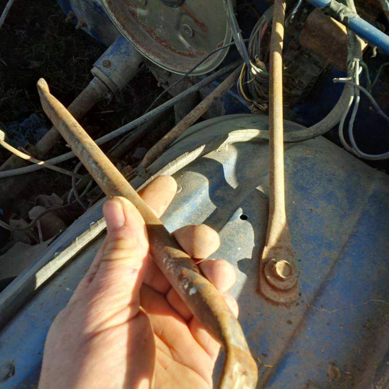

It just seems like if there was any serious movement at the point where it meets that sheet metal inner fender that it wouldn't take long to elongate the hole through the inner fender.
I was going to check but I can spend an hour searching the stupid Parts Book looking for body parts without finding it. Trying to find thzt brace in the book is like looking for a pin in the haystack and I don't possess the concentration.
I was thinking the FSM may have an exploded view of 4 speed setup for servicing or maybe in the Brake Booster/master cylinder area there may be a line drawing showing nearby parts.
The brace closest to the master cylinder would be damn close to a booster if there was one there. Probably would have to be the one that is small diameter.
The braces probably stabilize the brake/clutch pedal structure on the other side and the sheet metal it's attached too i.e. the firewall

Don't forget the under dash bracing as well. I believe the four speed cars received a different inner apron with the bolt holes. Also, bracing clears power booster that appears no different than autos. -Rem

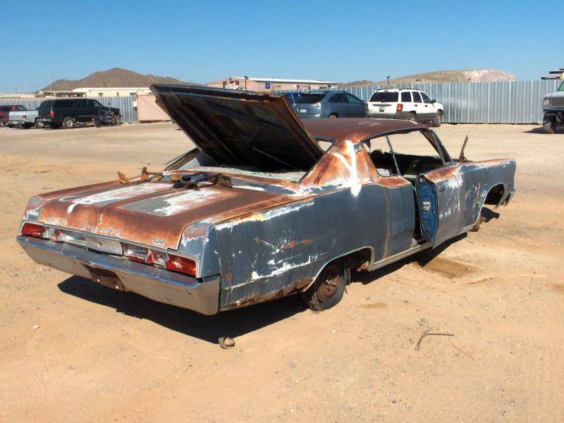

This 1967 Sport Fury (originally a 383, 4-speed car) was featured in an article in the February 2009 edition of Muscle Car Review, entitled "Low Buck Muscle", basically about unique cars in a wreckers yard (apologies, scanned it but site doesn't accept pdf's? Little help...?).
Was in the same crappy condition back in '09 of course. 'Tis at Desert Valley Auto. However, have recently learned that ALL 4-speed related parts and hardware (including the hump) have now been removed (pedals and hump were still in the car per photo of the interior in the mag article). It can be taken that the engine/gearbox/console lonnnnggggg gone.
Roof and RHS 1/4 have been sold too (why would you buy a rusty quarter...?), quoted front fenders (which seem dented BTW) at $400 each, and hood/bonnet (which I can bet is not great either) offered at $350. Crazy...
Nice, polite people those DVAP folks........NOT.
The braces are a standard part listed in the 68 Parts Book.
6-46-3 STRUT, Pedal Bracket to Wheelhouse
Upper 2881912
Lower 2881913
(Not in the 69 Book)
