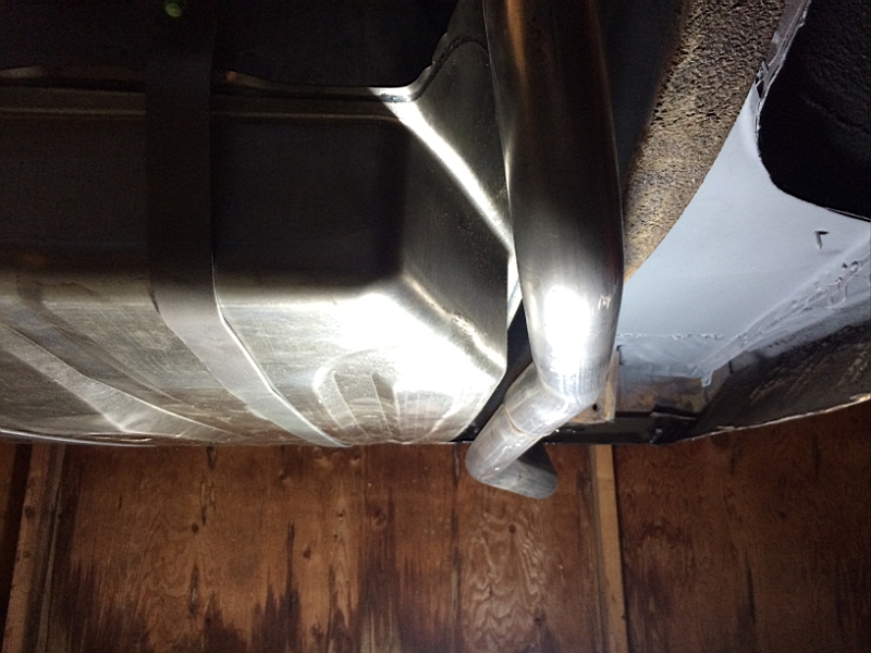

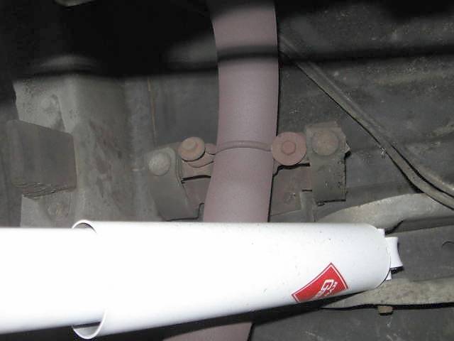

Here are mine going up and over the rear axle. Most all know what the tips look like so no need to put that pic up. First pic is an original pipe in the original hanger. Next two pictures are the new pipes with alternate hangers following the same route.

Using factory bent pipes and NOS clamps is obviously ideal but in most cases not realistic. Looking at the 3rd picture above it appears that the new hanger has a good bolt on attachment point to the body. Swinging down the arm then welding allows for very precise location of the exhaust pipe. Positioning pipes for both factory appearance and to avoid interference is a bit of an art form. Then there is also the problem of finding someone with the skill to do it properly. I really liked the TTI system for ease of installation although it doesn't appear close to factory underneath. IMHO the NOS or custom route are likely not worth it for most applications.
If possible, make a Supreme effort to locate correct factory pipe hangers and saddle hangers in their correct mounting locations. They ARE out there. Really....
