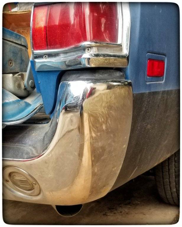

UPDATE: So, I got my Accurate Exhaust mufflers and tail pipes installed today. Because of the lack of availability of C-body mufflers being reproduced (they weren't sure if they could even get them) and me not wanting a super quiet exhaust note, I went with the Hemi HP (that's what they're called--because what Hemi isn't HP?) mufflers which are a little shorter than the stock C-body mufflers and what were used on all Hemi cars back in the day. Like the Hemi models, HP C-bodies in 1970 sent a 2.5" pipe to the muffler and a 2.25" (tail) pipe from the back of the muffler. So this is what I ended up with.
Upon installation, I started it up and then I walked around to the back of the car. I've gotta say, it sounds exactly how I want it to. Has a great tone when standing behind it, a nice rumble when you accelerate. No drone, no annoyance. And it actually seems to have added some performance over the glasspacks that were on it (not sure if this is possible or if I actually feel better putting the pedal down because it's not so damn loud). Accurate did a good/"accurate" job on the tail pipes. They don't go over the leaf springs and have the nice turn down ends.
Overall, I'm sure happy with what I got.
