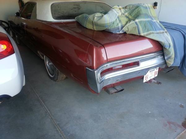

Buy a new trunklock , take a screw machine with you and drill the old one out.......

For sure, when you drop by we can talk about how to get your interior all original again and correct. That is all doable. Also, before drilling out the lock, you could also take out the back seat and if you are not a really big guy, you might be able to crawl through the area behind the seat and get to the lock mechanism and turn it to open the trunk (maybe with some pliers). That way nothing gets messed up on the decklid opening. Kind of depends on how much stuff is in the trunk. Good luck.
Pulling the back seat is the way I'm going to go. I think I'll be able to reach with some pliers.
Remove rear seat. Use a 1/2 socket and multiple extentions. Tape them together. Unbolt latch from decklid. Remove lock cylinder and any decent locksmith can make you a key under $20. That's exactly what I did on the last car I purchased with no keys (similar process for ign. key). No destruction.
The car I did it to had two POOL LINERS in boxes, in the trunk. I was able to pull them through and get at the latch.
Doesn't Legendary refurb door panels and the dash pad for Fusies?
I just reach through and use a screwdriver to turn the latch
As long as everything is in place, you can't turn it with a screwdriver. You either damage linkage and such, or unbolt the latch. Took me about 2 mins after I removed the pool liners.

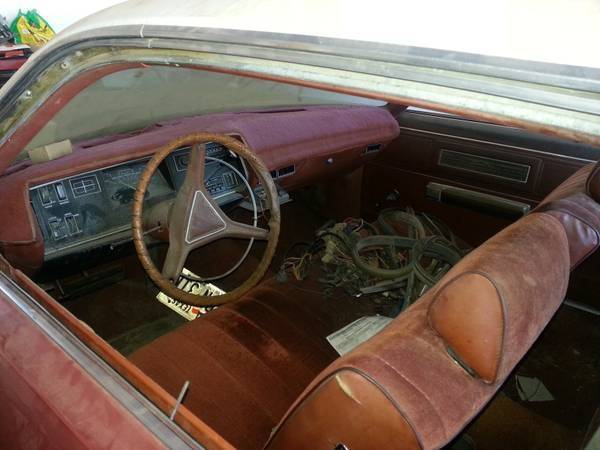

Tail lenses are stuck in the trunk at the moment. Hope to have them out today after I pull the back seat. The wiring is a bit of a mystery. I put in new headlight and taillight bulbs because they were all blown out. Turn the light switch on and get nothing. Turn the car on, and they come on, but as soon as I rev the engine, all the bulbs blow up. Did some tests and it looks like the alternator isn't charging the battery at all, it instead is running direct to all the wiring in the car with no regulation. We changed the voltage regulator and that made no difference. Found some melted wires under and back up in the dash. Also found a lot of hacked and spliced in mystery wires.
