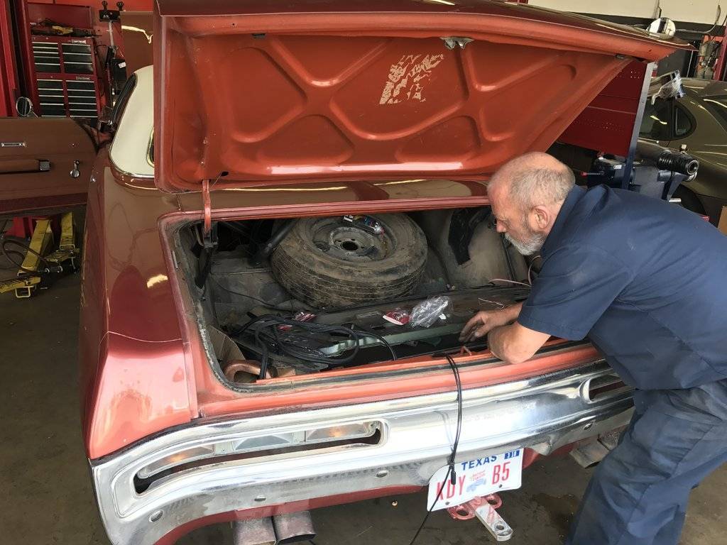

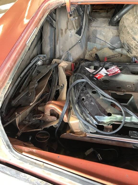

Tail lenses are stuck in the trunk at the moment. Hope to have them out today after I pull the back seat. The wiring is a bit of a mystery. I put in new headlight and taillight bulbs because they were all blown out. Turn the light switch on and get nothing. Turn the car on, and they come on, but as soon as I rev the engine, all the bulbs blow up. Did some tests and it looks like the alternator isn't charging the battery at all, it instead is running direct to all the wiring in the car with no regulation. We changed the voltage regulator and that made no difference. Found some melted wires under and back up in the dash. Also found a lot of hacked and spliced in mystery wires.

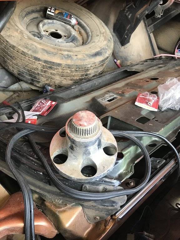

Got the wiring sorted enough to get me on the to road with working headlights and brake lights. Crawled through the back seat and popped the trunk. Found the tail lenses, original spare tire, an extra door, and bunch of other parts I haven't really looked at yet. Drove as far as Santa Rosa, New Mexico and got a flat tire. Also noticed a small pin hole leak at the top of the radiator. Replaced the two front tires with the best Santa Rosa, NM had to offer. Ha ha! Well at least the size of the tires is correct. Dealing with the radiator now. The adventure continues...

I see good parts in your trunk.
