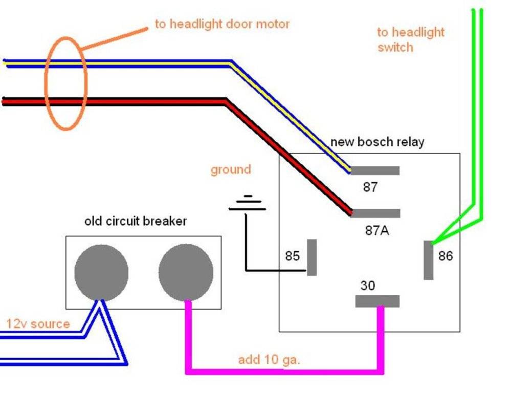

Here is a fairly good bit on how they work. However the relay is an impossible part to find and then are just apt to not work. I used a modern Bosch relay.
One upgrade which reuses the breaker (5 amp) on the old relay.

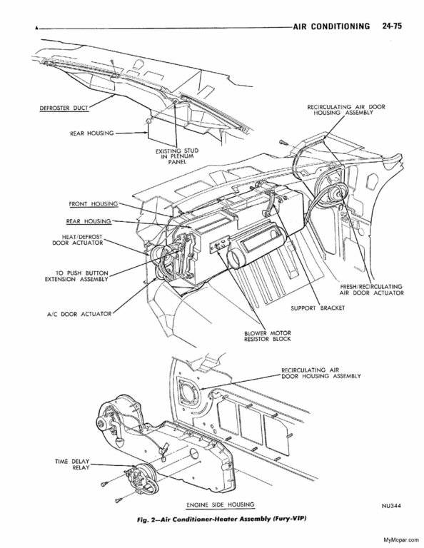

Is there a cover for the blower motor in above pic? Or just the door with actuator inside of it.
No cover. That's how it is. Door is inside there. You can replace the foam on either side of the door that catches dust/dirt. Mine just disintegrated upon touching them.

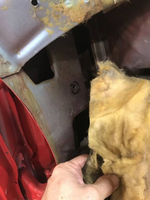

70Tom, what did you use for insulation in the upper corners of dash area. Shown is the factory insulation piece that has a snap that holds it in place. Mine is old and rotted.

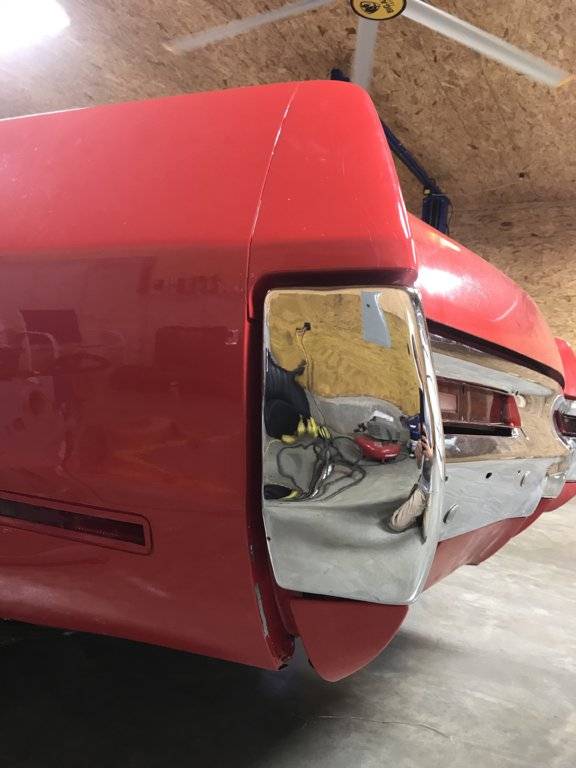

Looks a little wide at the bottom. Maybe the bumper isn't vertical, ie need to pull the top back, ie loosen the bracket gto frame bolts and rotate the whole assemble clockwise a few degrees. I didn't have a picture of my rear bumper, but found one of the front. The gaps are the same front and rear.

Fury440 bad a** looking car! Did all Furys have a lower grille? Between the valance and bottom of bumper? I see a lot of holes for bolts/brackets on my car but have nothing.
View attachment 147806 70Tom, what did you use for insulation in the upper corners of dash area. Shown is the factory insulation piece that has a snap that holds it in place. Mine is old and rotted.
I bought that stuff from DMT. It’s cut exactly like the original pieces and has the plastic push in rivers.
There are 2 brackets that connect to the bottom of the valance with 2 bolts each and then 1 bolt each side to the frame.
