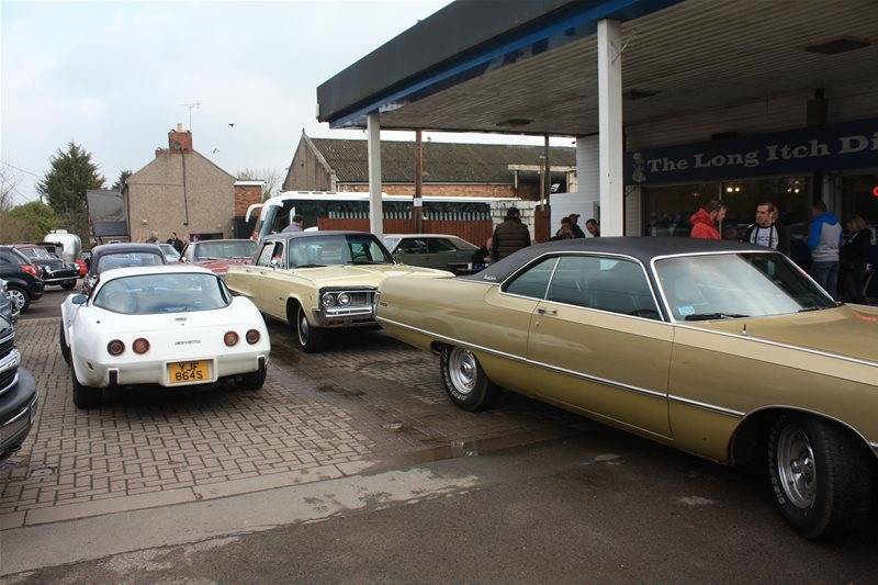

Before I post an update on the Fury, I thought I'd share a few photos I took today at a breakfast meet I started with a few other guys 10 years ago. Inspiration indeed!
C bodies make my corvette look European-sized!

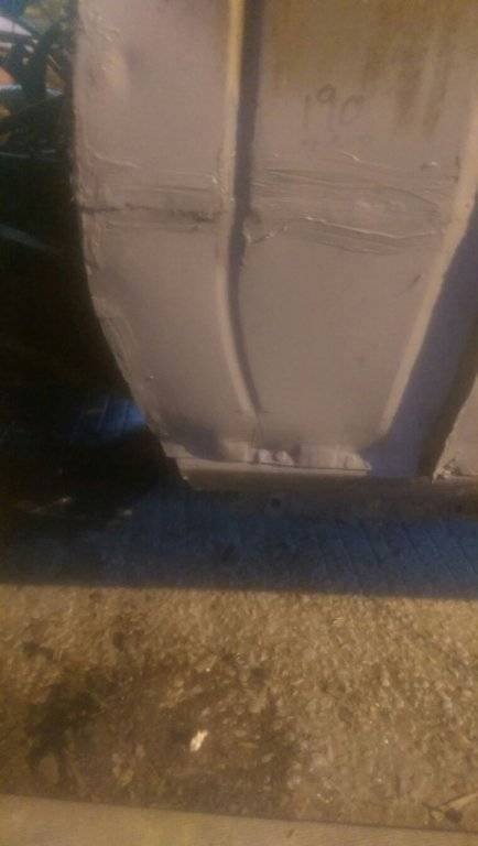

You can see from the last shot where the rockers have been exposed just to be sure they were sound.

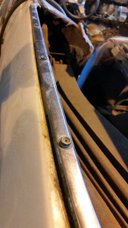

Not sure what you guys call the round fasteners - actually I'm not sure what we call them either, but am I right in thinking I need to drill these out to get that chrome trim piece off? Are replacements available? Do I need a special tool to fit them again?

Gary, if you go on amazon you can get the shop repair manual as a reprint. Those snaps are not original. It had hooks that went over the chrome peice. I bet. Wolfen has that trim peice
Go to Mymopar.com and look in the Tools/Reference section to download a Shop Manual and a Parts List.
The roof rail is incorrect, '70 used plastic hooks attached to the cover instead of the '69 dome fasteners. I can take pictures of mine if wish.
Domes ended in 68. 69 had clips like yours.

Those press down clips certainly are not right, the chrome strip should have nothing on it, I will take some pics tomorrow of the one I have which is also available if you wish to replace yours, That chrome strip also screws in from the underside, not the top.

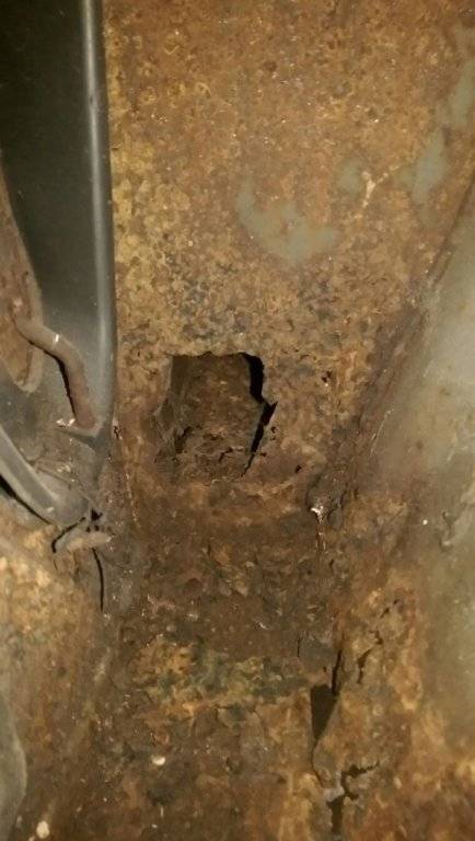

So, more rust.

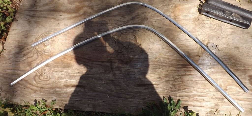

Here is pic of the strips, they are stainless and are scratch free with no dings. PM me and i will let you know a price. Cheers,

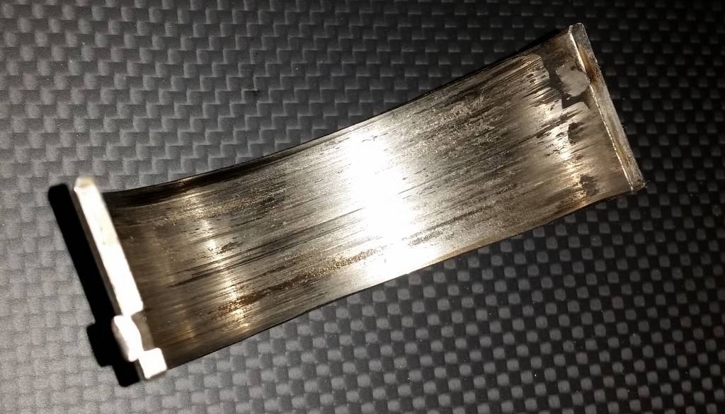

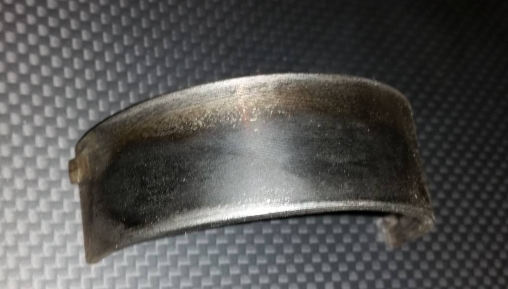

So the engine that I pulled out was taken to a machine shop. Two pistons were a little stuck in the bores. Even with all pistons removed, the crank still wouldn't rotate. This is main bearing number 4:
Engine builder thinks it got hot, although the car ran just fine prior to being parked. The main cap now doesn't snap into the register though. New set of mains and an align bore would be more than buying another block.

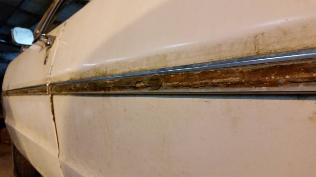

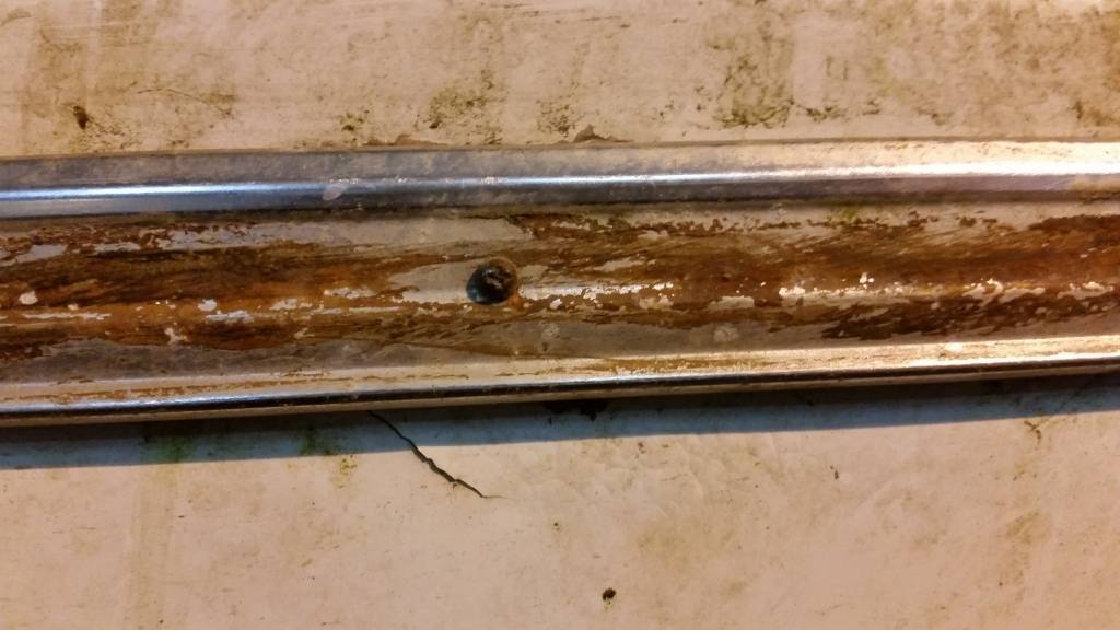

So, more trim questions, I'm afraid. Someone has at sometime done something horrible to the side trim on this car:
Lurking beneath the gunk (looks like dried glue) are screws:
I'm guessing they're not factory? What should hold it on? Those fasteners with a threaded bar and a flat oval head that rotates to lock into the trim? (That description makes sense to me!)

Hi Gary, there should be plastic clips that are pressed into holes along the body panel and the trim clips onto the plastic holders. I will get a pic tomorrow for you to see. One end of the trim does have a nut on the inside of the panel to hold the end on. I have a full set of dent free trim for this model of car but they are very long.

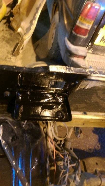

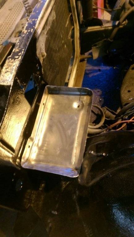

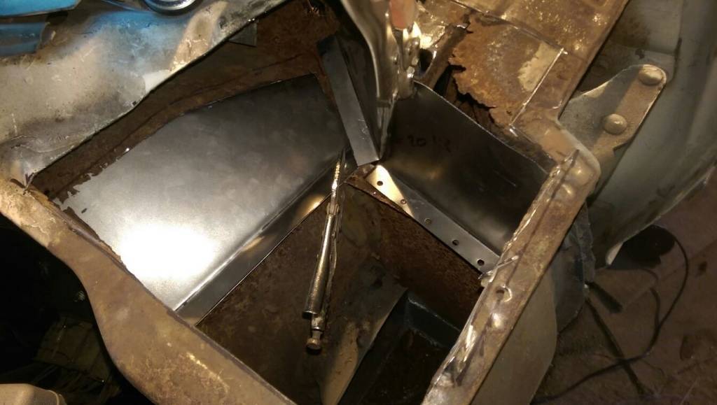

Time for an update. Driver's side patches welded into the area under the cowl.
Painted and then the top patch goes on.

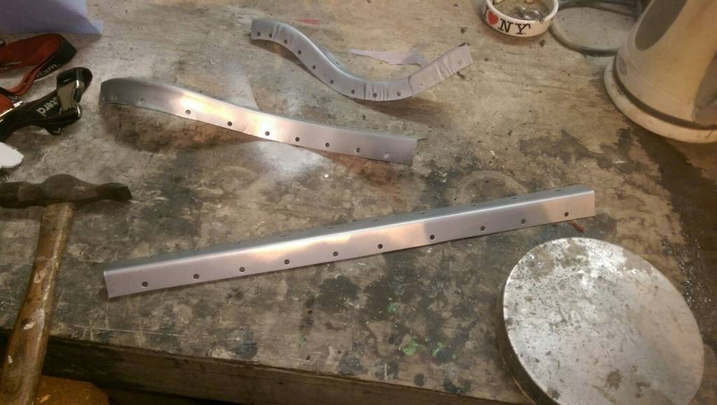

Patch made for the window surround, but not welded in until we test fit the new windshield.

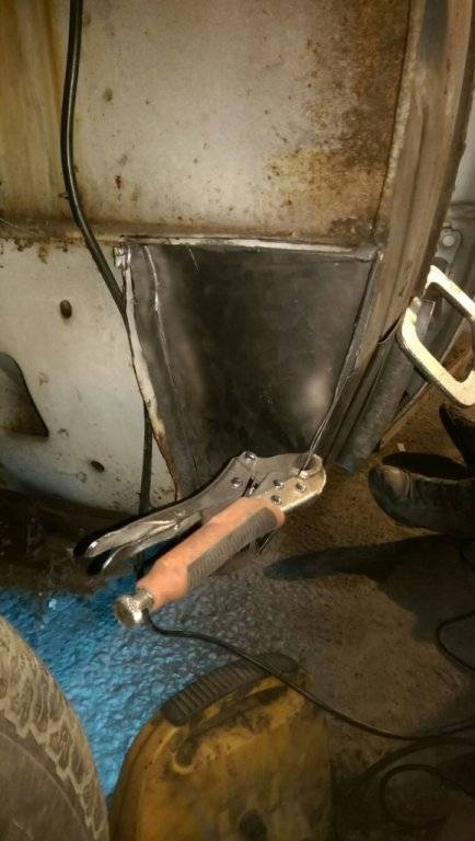

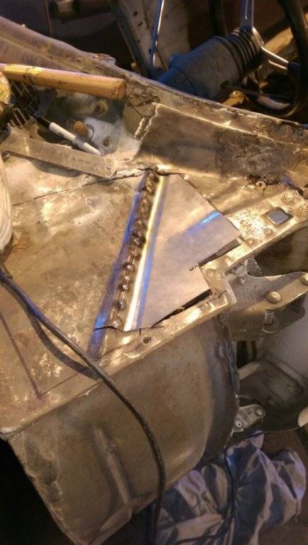

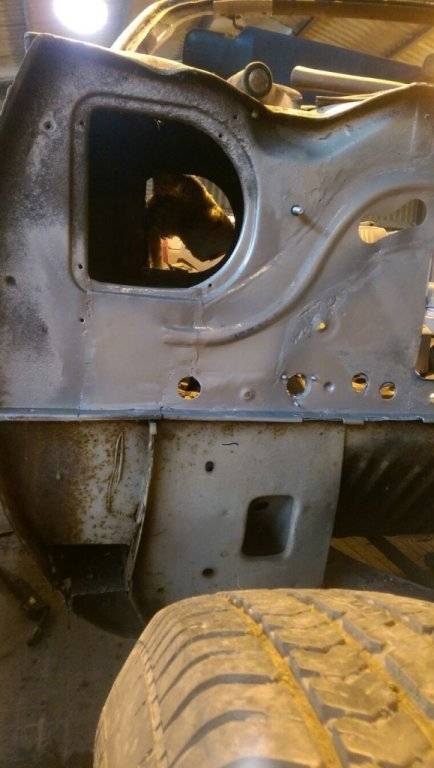

Then it's on to the other side. I bet Swamp that side wouldn't be as bad. Swamp won the bet. Here's the bit behind the heater assembly.
More patching:
Got to give credit to Swamp's partner in crime Moomin for among other things, making the S shaped patch.

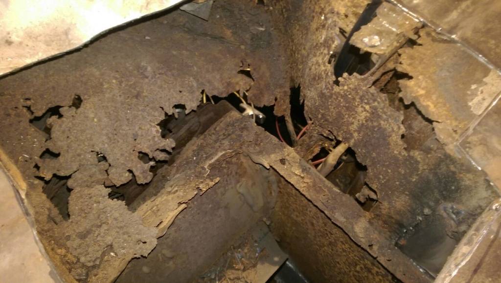

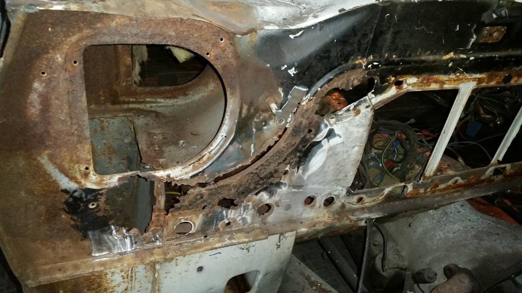

Obviously, there's more rust behind the firewall.
Which needed some cunning patches.
Shrinker/stretcher and bead roller both earning their keep. As with the trunk floor, holes drilled for self-tapping screws prior to welding in place.

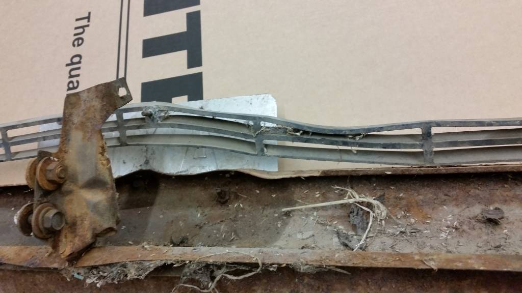

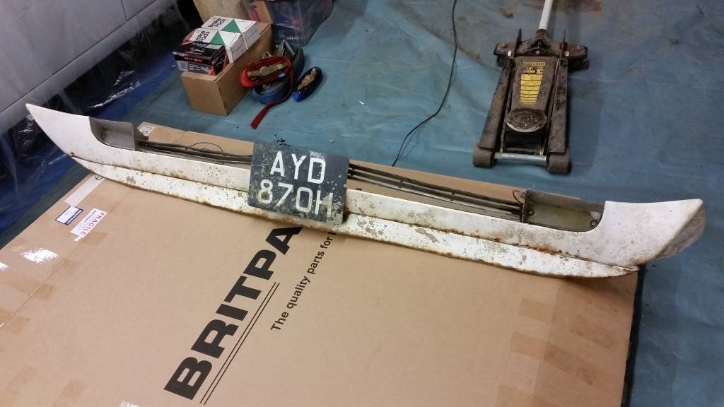

I have some garage space and some spare time to take on a little bit of plymouth work too. Figured the front valance had my name on it,
Reckon I'll break the grill trying to straighten it?
