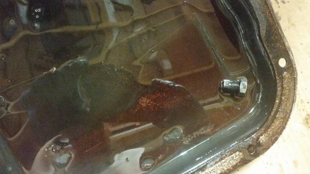

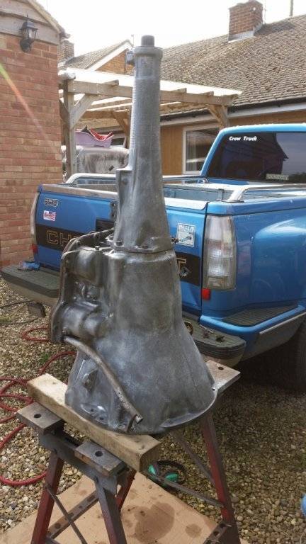

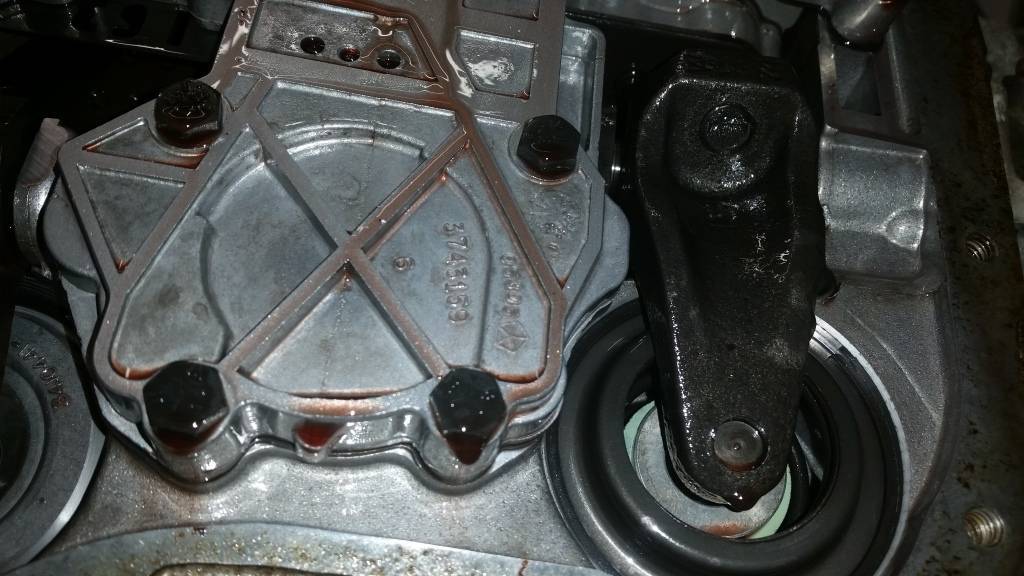

I pulled the pan off the trans and found some shiny stuff (expected) and an inch of broken off stud with a nut on it (uh-oh).
Came from the lever on the right, you can see where it broke off in the lower right.View attachment 121878
Now, I have no idea how an auto trans works, but I figure this is probably not good, so it's been off to the trans specialist I use and they found a broken clip on the reversing band, which apparently puts extra pressure on that stud. All replaced and back, cleaned up and ready for some paint.

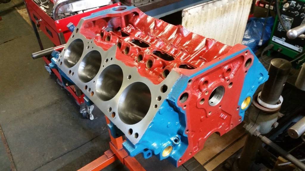

Meanwhile, the engine has been coming together over at the engine builders.
It's further along now than in this photo, but I'll post about the engine in more detail when it comes back. That should be later this month.

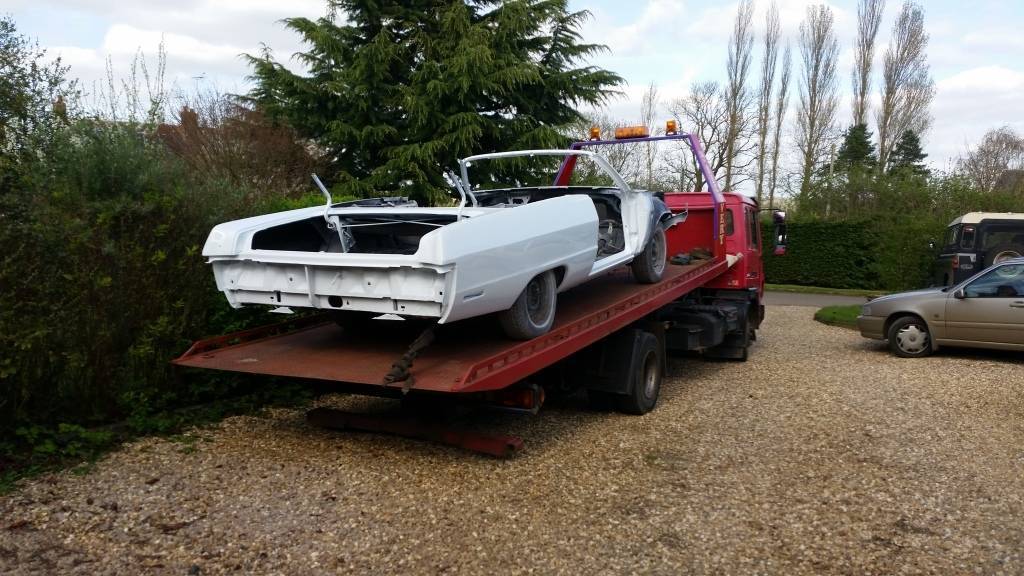

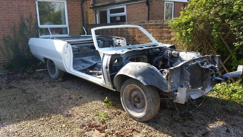

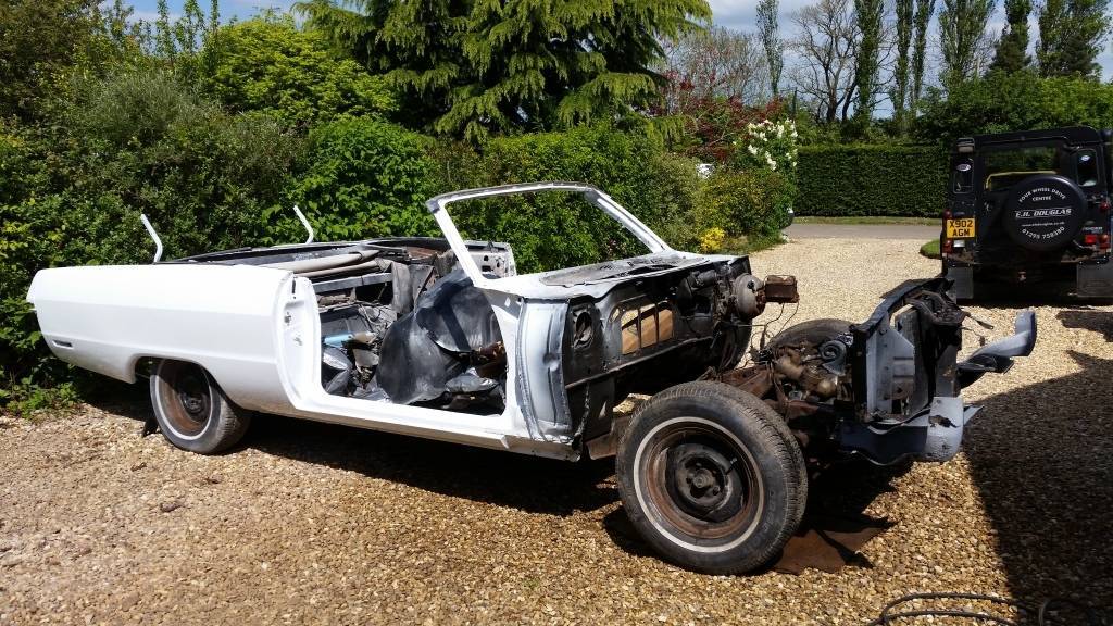

So the big development is that the car has come home. Well, most of it has anyway. This was Wednesday of last week.
View attachment 121881 View attachment 121882 View attachment 121883 View attachment 121884
The other panels are painted, but still needed some final buffing and polishing so they'll be coming back in the near future.
Now it's over to me, so this is where I'm going to start asking loads of questions.
Like, do you think the driver-side front will be good for much more than 60mph?

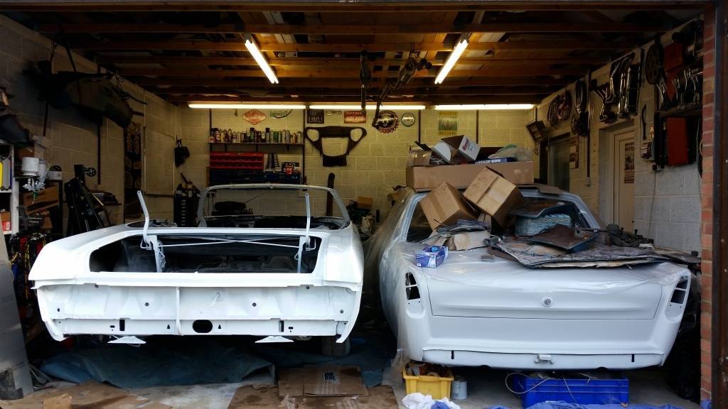

What is the other project in the garage?
Thanks for the updates! We're long on dragstrips and junkyards, short on castles; so I love when overseas members post car pics that obviously weren't taken in the US.
Just one note from your comments because your seem to be the intelligent, history-buff sort that would care... Dodge was the only Chrysler make to have ever been an independent. Plymouth was a 1928 creation of W.P. Chrysler (essentially using the original Maxwell chassis to do low-priced battle with Ford and Chevrolet).
I did not know that about Plymouth. I do seem to remember that WP Chrysler worked for a train company that experimented with making cars, and Chrysler left to set up his own company when they decided not to make cars.
As for the other project, it's a 1964 Ford MkIII Zephyr 4. Ran it for quite a few years, but have had to deal with a load of rust. Bodywork needs some finishing and paint. Ran/runs a 3.5 litre Rover V8. Managed a best of 15.1 at the strip.

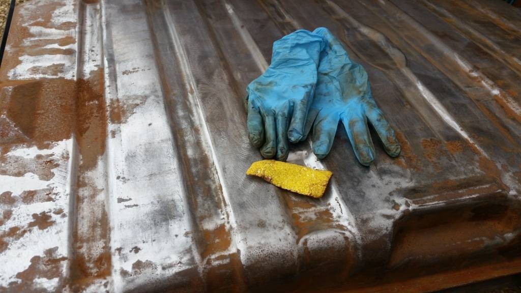

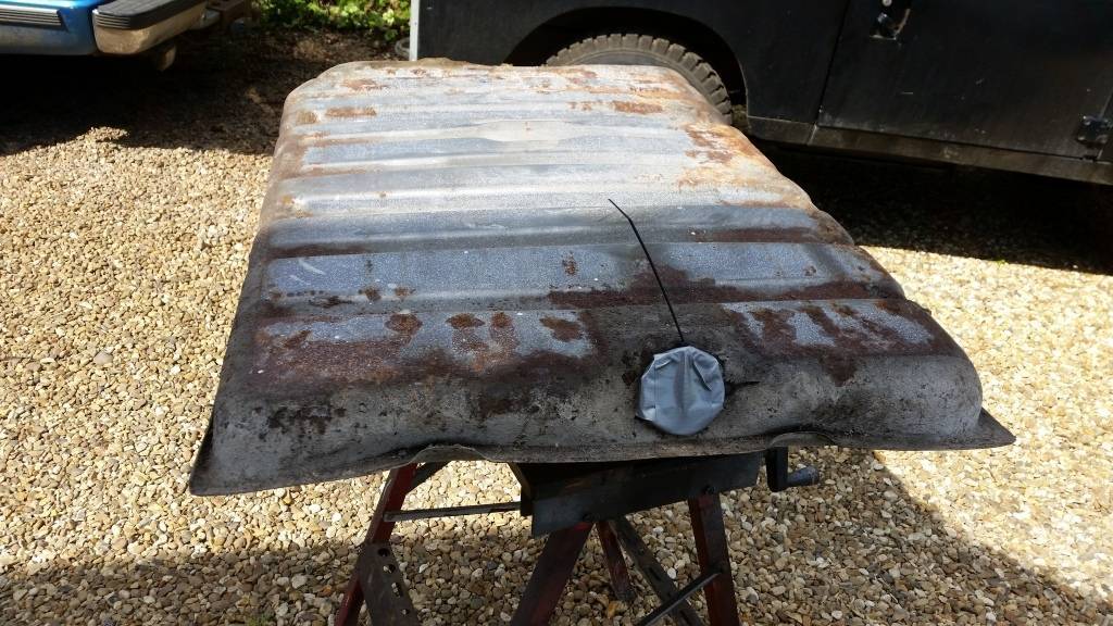

So the gas tank is pretty crusty. Figured I'd knock the loose rust off and hit it with some rust converter before painting it. I know it should be all shiny and galvanised and if there we spares on the UK ebay I wouldn't be doing this, but I just need to halt the rust for now.
I thought this bit was boring.....
....until I got to this phase.
With most of the rust off, I hit it with Jenolite rust treatment.
Red oxide primer.
And finally black chassis paint.
When that's dry I'll flip it over and repeat.

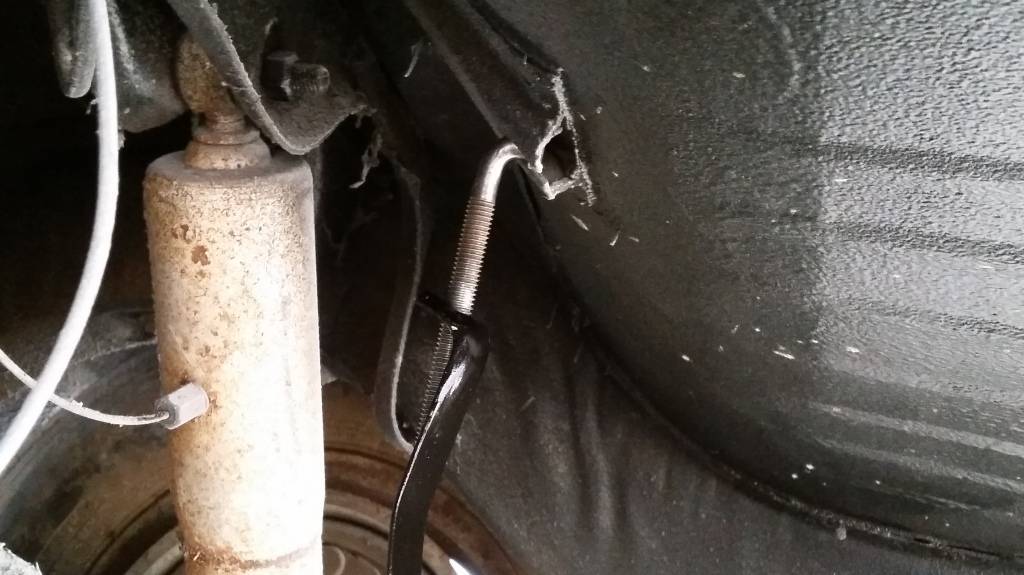

So is this how the gas tank straps attach?
Yet to try it with the tank in, but this seems a little insecure. Anyone?
Thanks for the reply, Polara_500. Is it normally a struggle to get these in? I'm finding that even with a ratchet strap pulling the tank up I can barely engage the thread (in fact I can't on one side). From the state of the threads, it looks like the nuts were halfway up the thread before.
This is someone else's photo from a 69 Roadrunner I think and it shows a similar setup:
Except the slots that the J-shaped bolts go in are closed at the bottom, mine are open as in the photo in my last post on this thread. This makes loads more sense. Have I lost something in the process of trunk floor replacement?
UPDATE: I just found the photo I was looking for on Fury440's website. I have a bit missing!

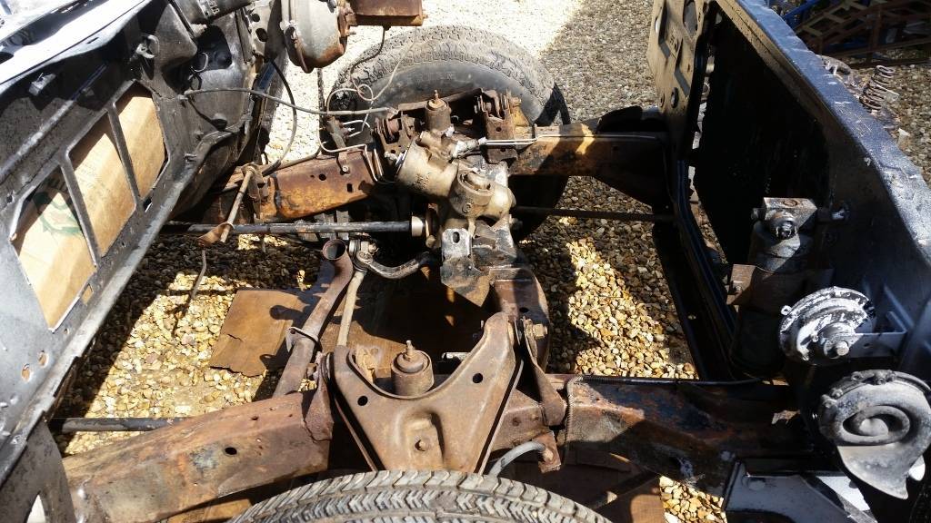

So, at the other end of the car: the engine is going to be back soon I think. Haven't called about it as I'm really not ready for it yet! Engine bay is a little crusty.

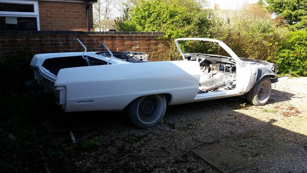

After more stripping, three jet washes and two de-greasings:
Could get excited seeing it out in the sunshine:
You'll notice the side trim has been deleted. I'm thinking about a blue strip in it's place. Something to match the interior.

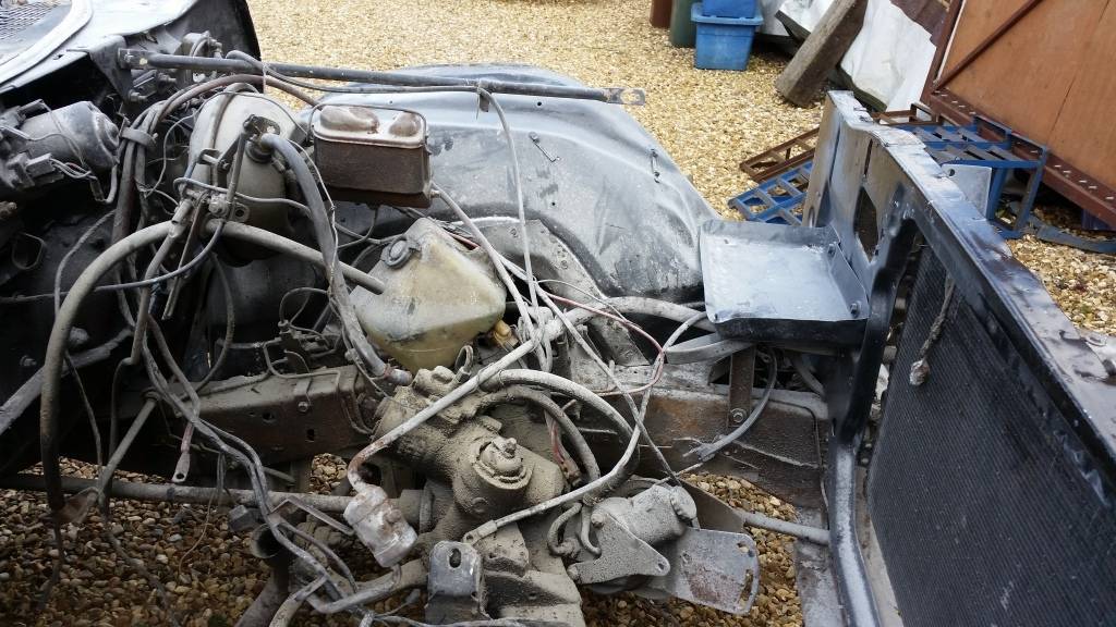

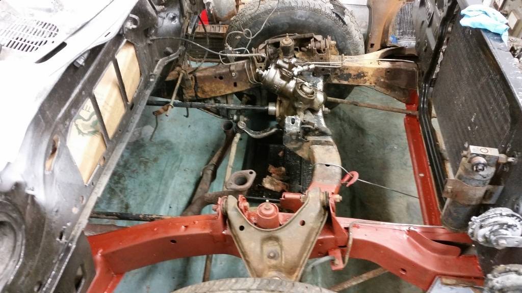

Started painting today. Couldn't go much further as the steering box puked a load of fluid when I was maneuvering back into the garage.
Must confess that I'm tempted to take this all apart. I'm going to try to resist, though as a) I don't have the time b) I don't have the spares.

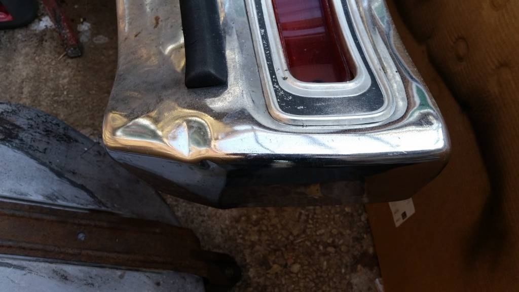

So I figured putting something big back on would feel like progress and have the bonus of more room in the lounge.

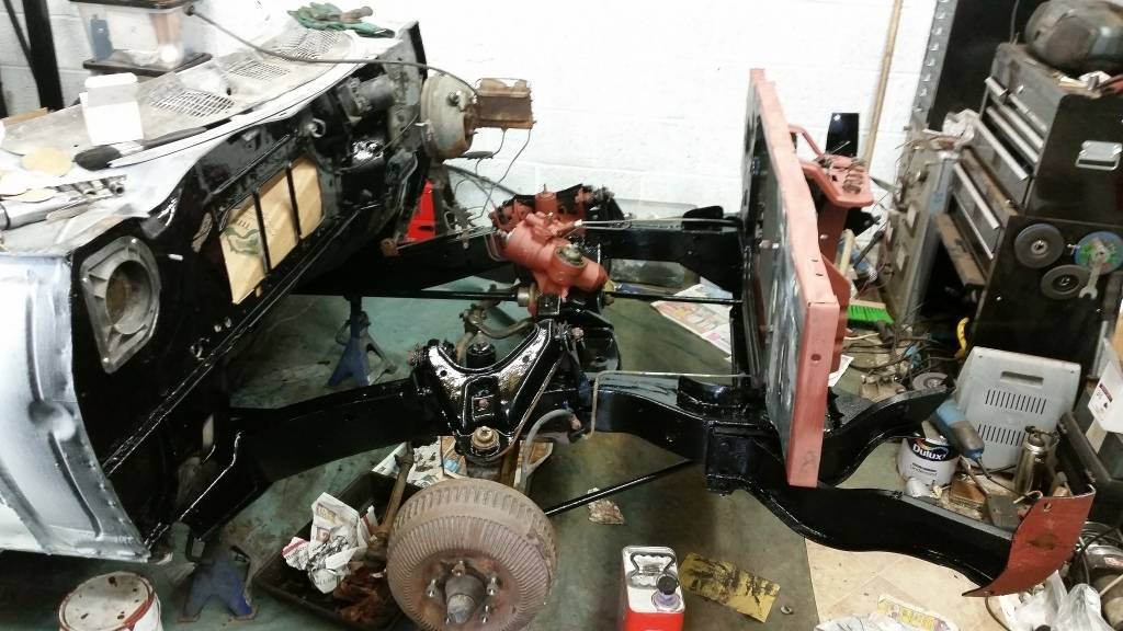

Figured I really should get ready for the return of the engine, so this is my main focus right now.
This is how it sits right now. When the paint dries enough for me to sit on the front cross member, I'll paint the steering box. I'm using black chassis paint for all of this.

Then there's full-on rust in a couple of places, worn paint on the insert thingy and one of the bumper guards is half hanging off.
Where the licence plate goes the chrome is pealing off.

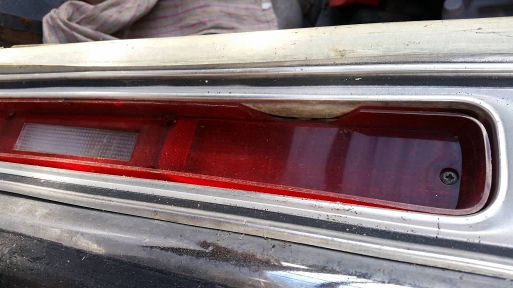

One light cluster is a little broken.
And the flip-side is rusty all over.
So opinions please. I can't see myself spending an enormous amount getting this professionally repaired and re-chromed right now. One for the future.
I could do nothing other than polish it, put it back on as is and deal with it later.
I could take it apart completely and get the back blasted and painted. That might hold the rust back for a while. Where the chrome is pealing I could paint it to halt that from getting worse.
Maybe someone on here has a spare light cluster?
Not sure about the bumper guard. Both are split and one is hanging off. Are these available as spares? Looks like taking them off will leave me with a row of holes.
What would you do?
The rust on the backside of the bumper, just wire brush it and paint it with rust converter then something like POR-15 rust paint. The outside chrome is more of a problem as it needs some welding and grinding to get it smooth enough to plate. Here in North America there are all lots of these bumpers on the market. I bought two or three before I got a nice straight undamaged one. They averaged $100 each. Once you have a good core, a good chrome job will run about $750 to $1,000 depending upon how picky you are about imperfections.
The light cluster is another story. The lens is near impossible to find either NOS or undamaged used. Every once and awhile one will turn up on eBay for usually around $250 USD. Be careful buying mint used, the seller must wrap and pad the package like he's shipping raw eggs! They are very fragile.
The rubber bumper guards are I believe being reproduced. In my case I didn't like them so I bought bumpers without them.
Thanks for the reply, Fury440. We're over in the USA again in August, but sadly, I think another bumper would exceed our luggage allowance. I'll make some enquiries about shipping. Although I guess if I was getting the bumper repaired and re-chromed, I could just as easily weld up the holes left by the guards.

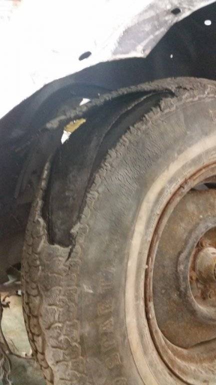

Finally, I was getting pretty nervous every time I was near that tyre that was coming apart, so they're all off for blasting, powder coating and new tyres.

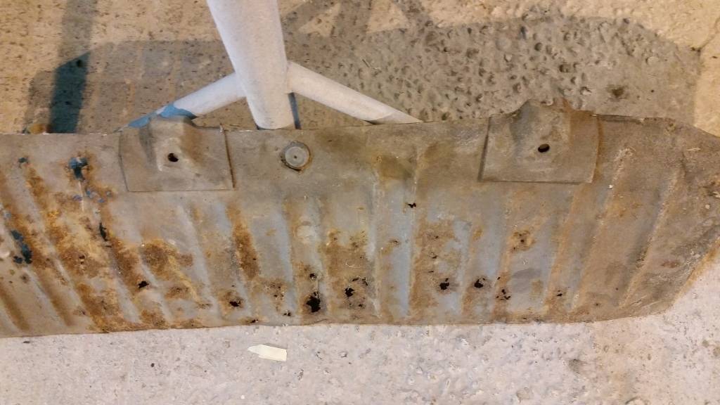

So I was working with Swamp yesterday on another project and mentioned the fuel tank mounts and how half of them was missing. Swamp then produced this:
Noticed them when clearing the debris from cutting the trunk floor out and put it to one side just in case they were important. That makes it an easy fix now.

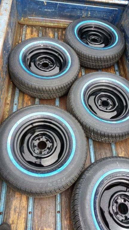

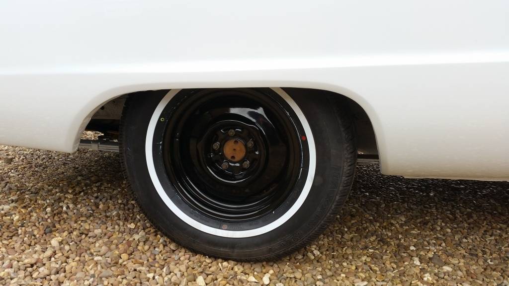

And I have the wheels back looking a little nicer than they were:
So, three questions today:
1) What should the hubcaps look like? Their shiny in places, dull in others. Do I just polish them back to shiny all over?
2) Would it look cooler to pop the wheels back on without the hubcaps, maybe with chrome nuts and centre cap?
3) The spare isn't as wide as the others, although it's wearing the same sized rubber. Is that stock or do I have a wheel from another car?

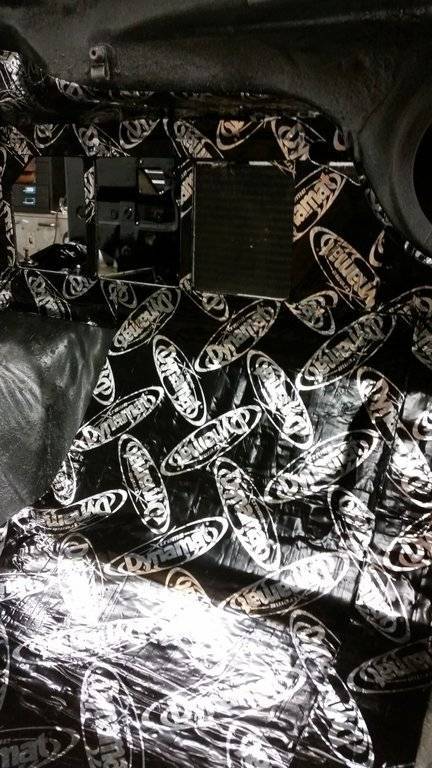

And I've started with the Dynamat:
Good to bolt a couple of things (horns and whatever the hell that AC thing is) back on the car. Feels like the tide has turned:

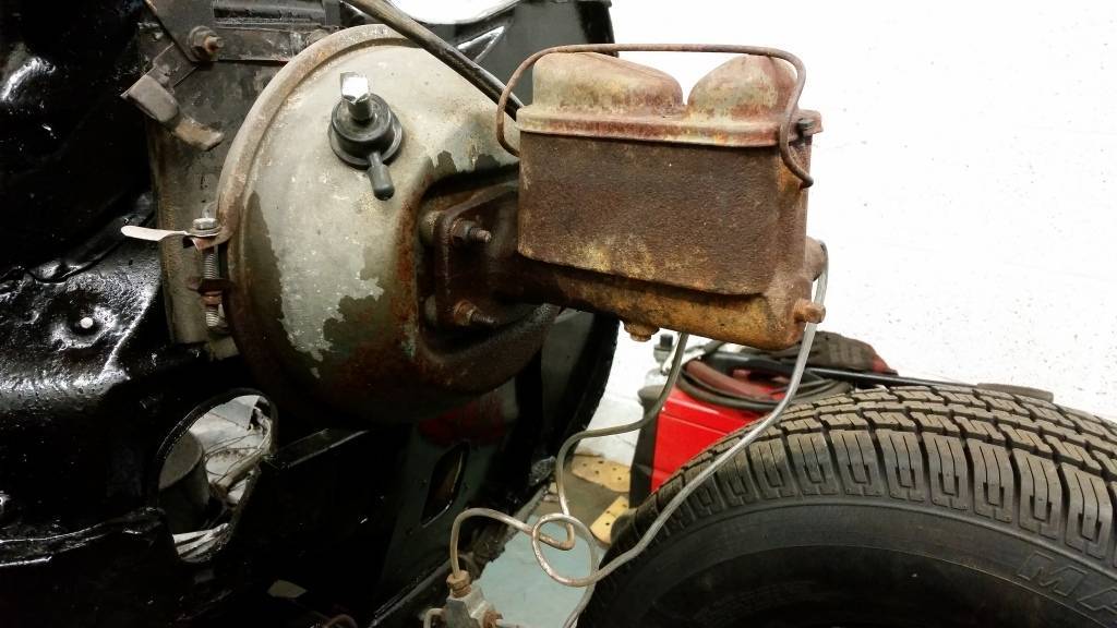

On the downside, it seems that the master cylinder would like a rebuild:
Brake fluid leaking onto the servo and my freshly painted chassis!
