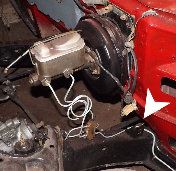

WhyTF is that there.
That is a factory C-body z-bar bracket. Was it originally a 3 speed column shift car @Wollfen ? Either way, swap it! there needs to be more 4 speed fusys out there :D

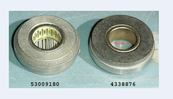

You have to. I would not worry about the input, cut the 3/4 of a inch off the front and use a pilot bearing out of a mid 90s Dodge truck, it goes into the converter pilot and no one will ever know. Would i cut the input on a 300m 18 spline hemi trans, no, but a common 23 spline sure thing.
The trans can be used again in something else you just have to always use the large pilot bearing and not the bushing, why you would ever use a bushing is beyond me. Even in a 100 point resto no one can see it.
The car is a factory floor shift console car but an auto. So the bracket must have either been put on by mistake or the chassis was just on the rack at the time the car passed by on the assembly line.

^^^So what is the difference in the two bearings??

The one on the left is a needle bearing, and the other is a brass bushing.
