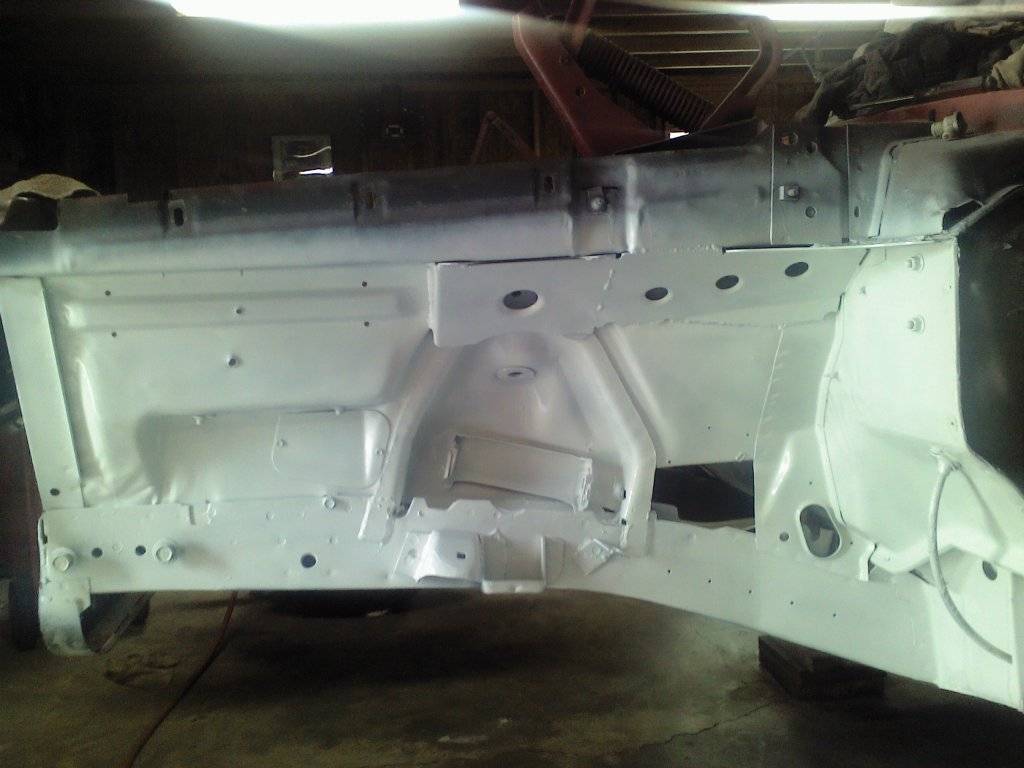

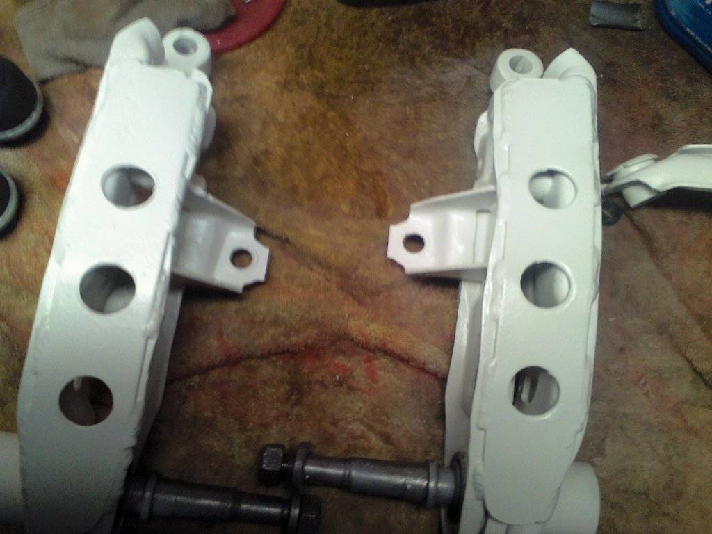

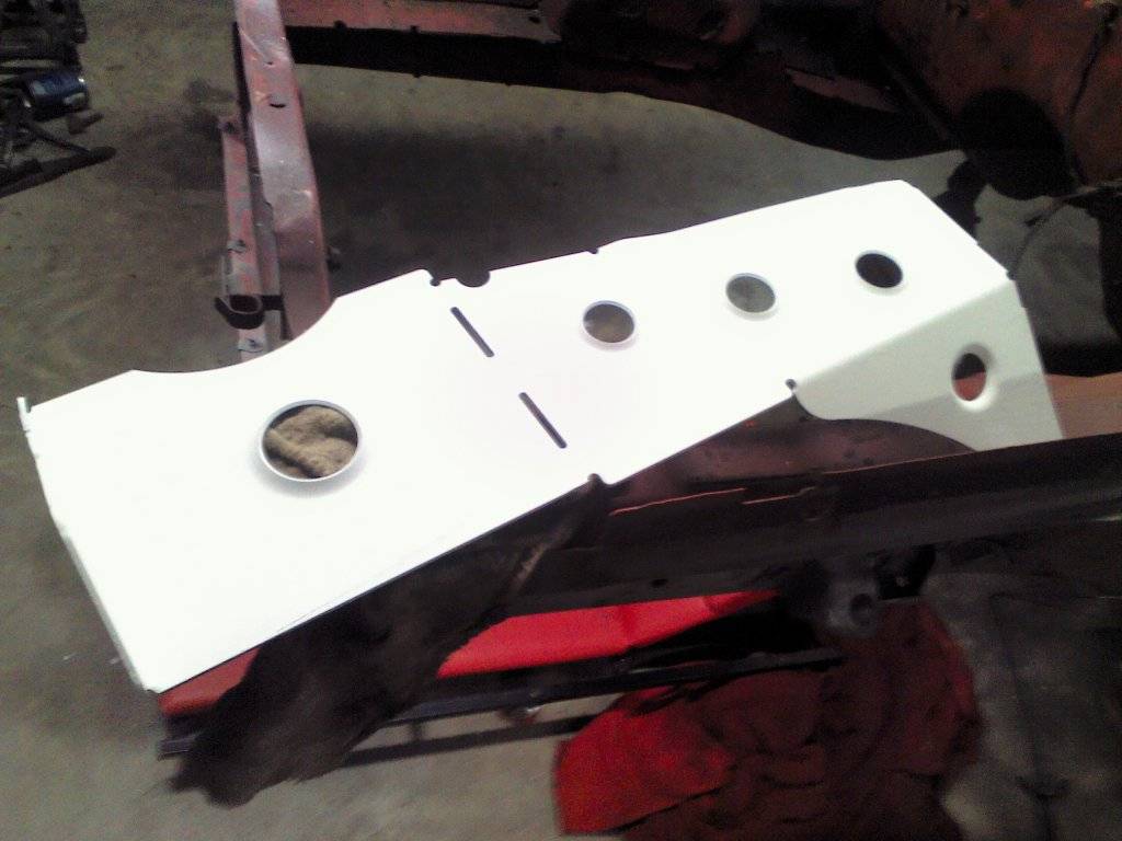

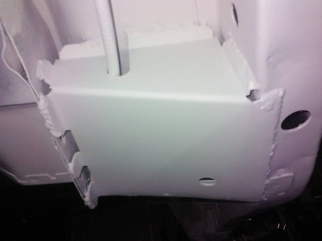

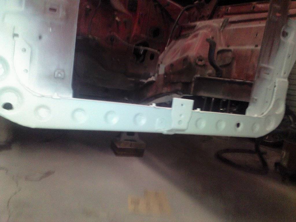

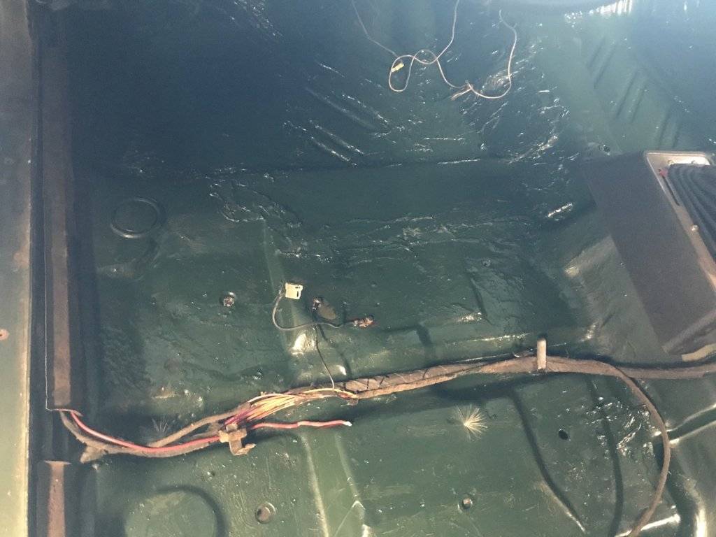

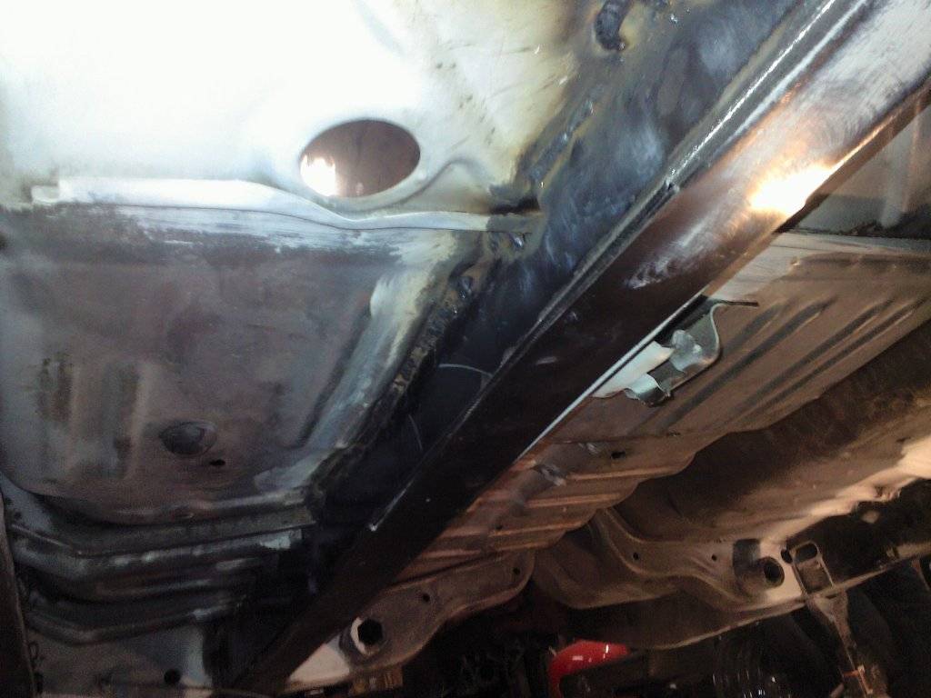

Made some progress of the Fury. I got my floor patched up and sealed.
I didn't use compete floor pans because this isn't a high dollar restoration so I just patched the floor where it was needed.
My process with floors has always been cut out the old rusty floor, make a patch that fits, weld it in, seal all the seems with fiberglass bondo, coat the entire floor with fiberglass resin, then paint. This has worked great for me. Be warned if you have a convertible you will be removing the plugs to drain water if you get caught in the rain as it is water tight.

just rebuilt the whole front end on mine recently and I would check out the stuff from firm feel if I were you. You can get heavier duty torsion bars and strut rods. You should be fine with your factory upper control arms just replace the bushings and ball joints if needed but I would definitely use the lower control arm plates they sell to box in and reinforce the lowers. Just be careful when welding them on to make sure the torsion bar adjustment bolt still lines up with the opening properly. I thought I had them welded up just right but ended up having to cut a little of the plate out where the opening for the torsion adjuster bolt goes thru after welding them up and installing them.

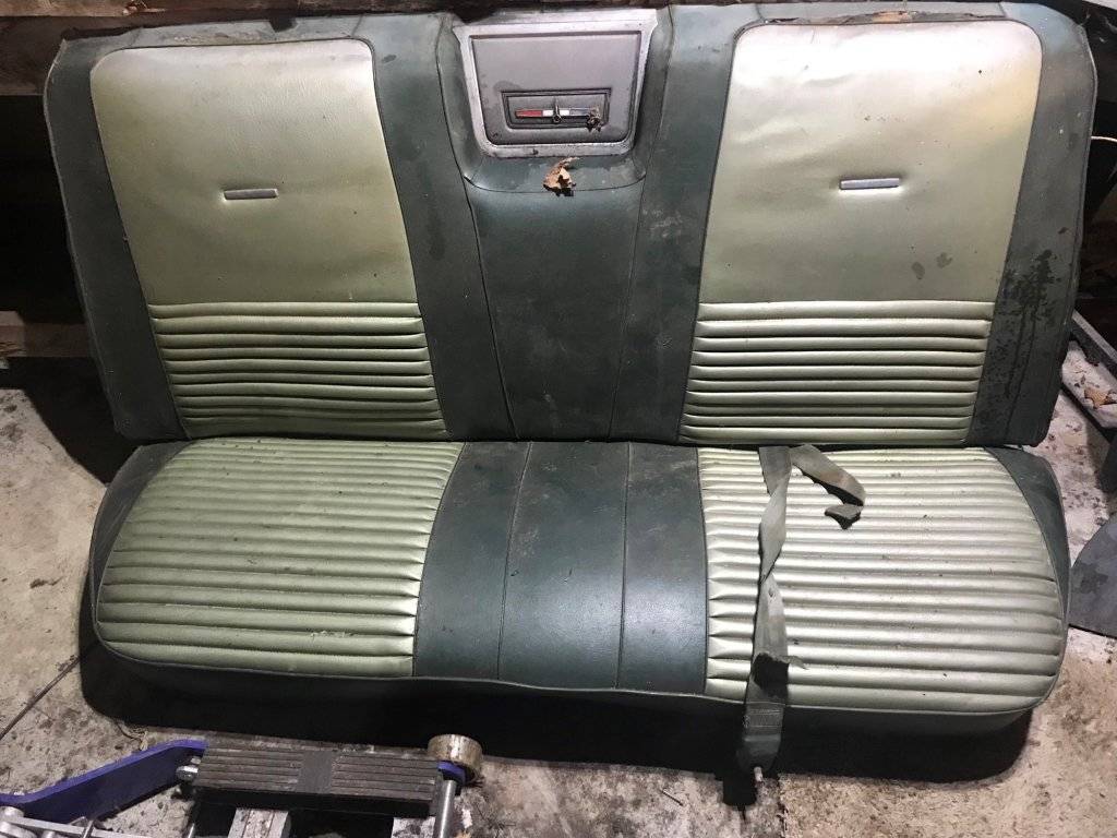

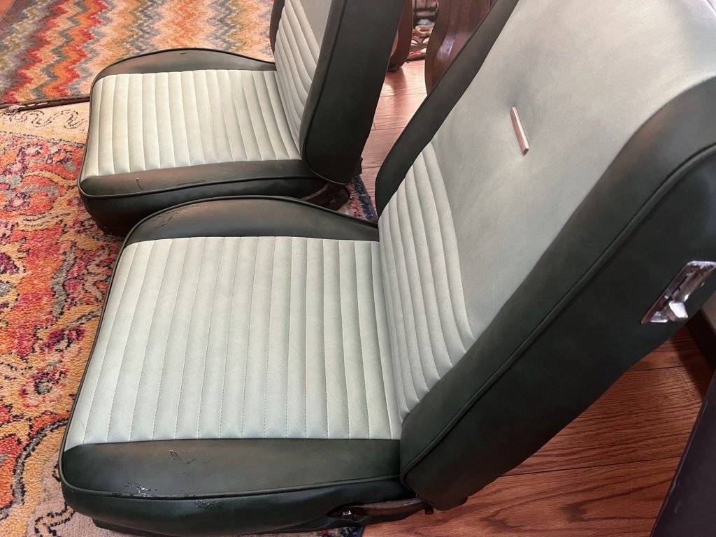

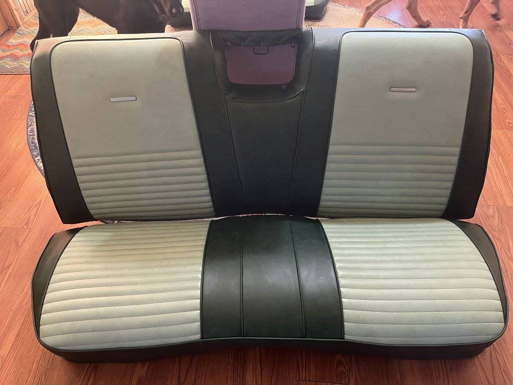

I posted it on another thread about seats but because this is my official build thread I wanted to post here.
Got my seats done by a guy in Wixon Mi. Not original material but close enough for me.

they look good. i hate to see people spending a small fortune on seats and have them come back with wrinkles and crooked seams.
